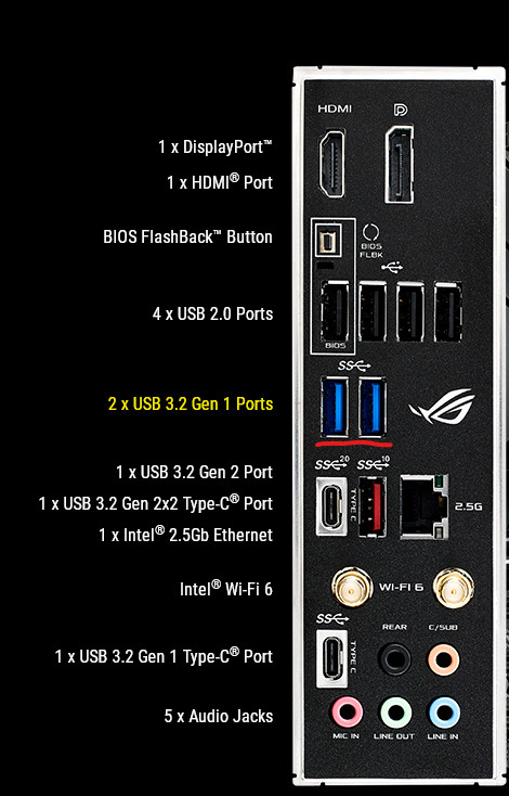

So my problem is simple to explain, One of the two USB 3.0 HUB ports has better mouse movement than the other one. The difference is obvious, one port gives me slower but smoother mouse movement and the other one gives me faster movement, I feel that the one with faster movement gives me less input lag.
I can confirm this, the same thing happened with my Viper8kHz, but the bigger problem was that the mouse in the more responsive port (ASMedia) itself switched to 1kHz mode, and this was only fixed by physically reconnecting the connector in the PC, I read here and in other places that this is a problem with the Viper 8kHz firmware and in the end I had to use it in other ports or at 1kHz.
ASMedia ports (2074 for usb2/3074 for usb3 hub)
Screenshot 2024-05-03 060203.png (319.81 KiB) Viewed 3291 times
