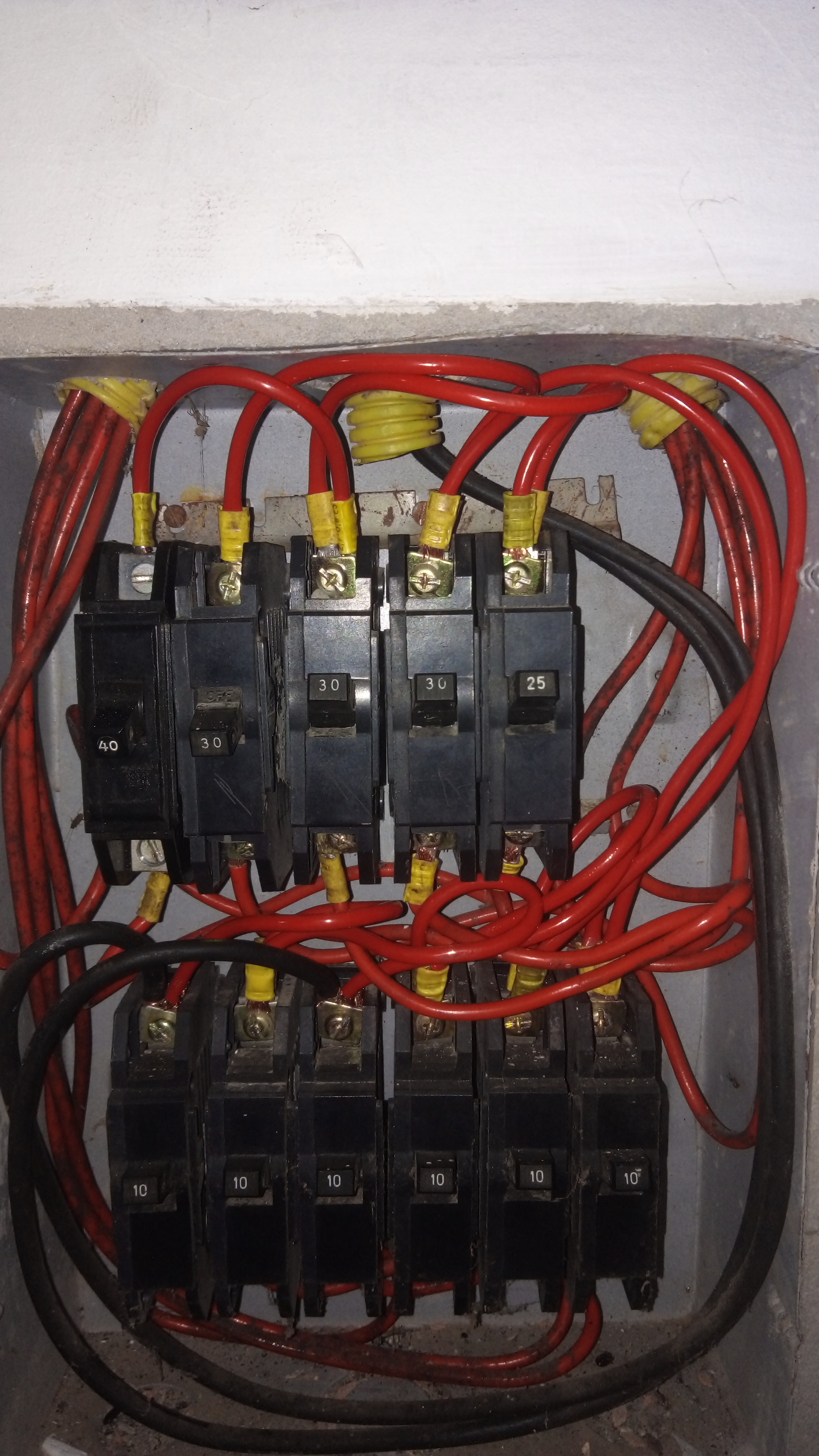

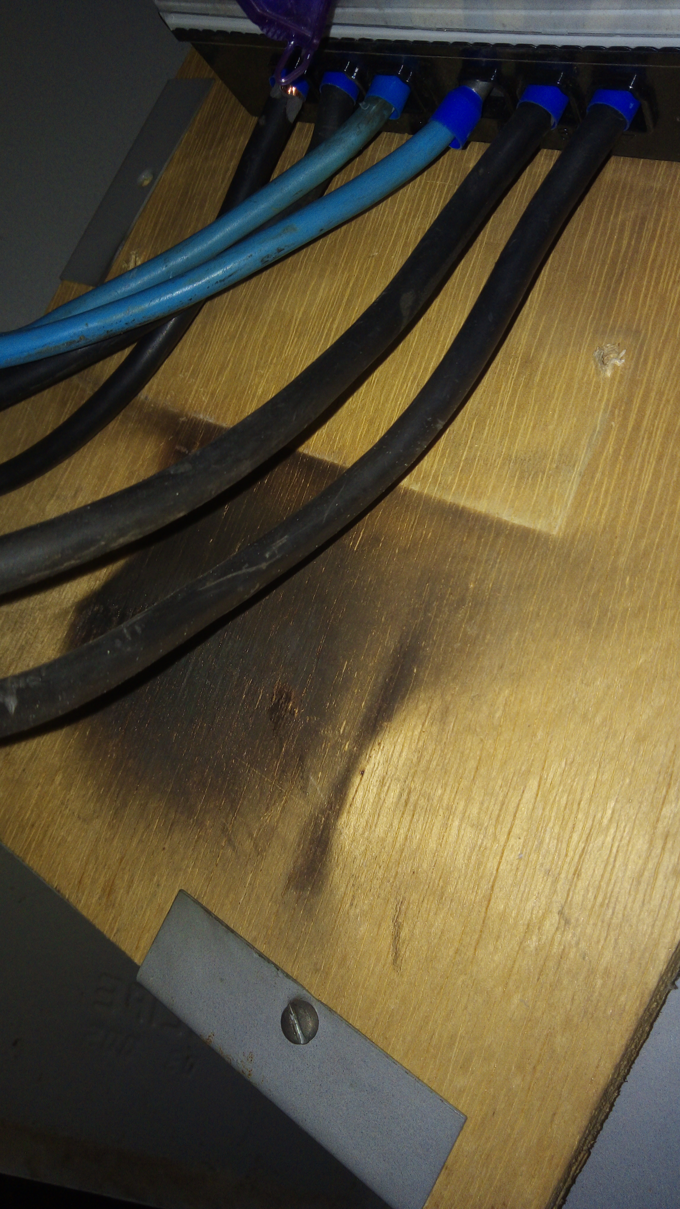

I couldn't take it anymore and started looking for what could be, I've done everything, I bought a whole new PC and nothing happened. It was then that I started to see that it could be something related to electricity, I decided to check every part of my house and found the problems. Here in Brazil, the energy leaves the electric company, passes through the street pole, arrives at the house pole and is connected to a meter. When I went to look at the meter, I couldn't believe what I was seeing. The neutral wire was literally fused with the live wire. The most unbelievable thing was that the house's power was working normally, nothing was faulty, except for those strange things with the PC. I immediately called the electrician, he looked at it, and said that this would be resolved by the company without any costs. Below I will leave a photo, the part where there is the black spot was where the short circuit was, they redid everything, changed the meter.

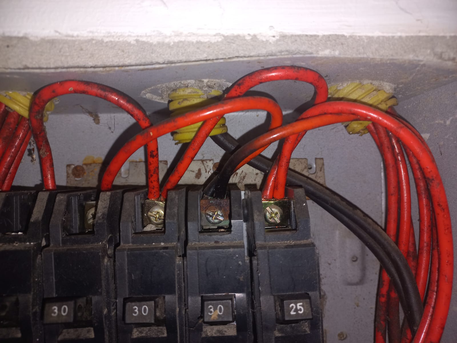

This problem also affected the house's distribution board, as you can see in the image below:
The electrician also needed to fix the panel, he replaced all the damaged wires, put connectors on the end that weren't there before, photo of the repaired panel below:
Detail: this panel has never been opened before, since the house was built 15 years ago, I was the first to open it.

Yes, in my case was definitely this, and even worse, cause here is 127v(one live wire and neutral wire), and, so, this two on the entrance meter off the house was completely fused. The electrician told me when this occurs, all of the point of the connection is affected, causing bad conductivity, heating, interference etc
