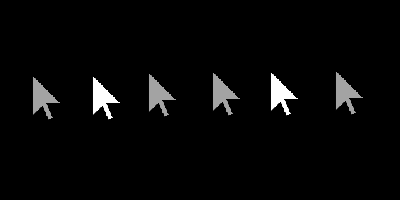

The 180Hz mode of this monitor is broken when g-sync is enabled. VRR isn't actually working correctly even though all indicators say it does, and some frames appear to be staying on the screen longer than others. VRR doesn't actually have to be currently active. It happens even on the desktop or when selecting "fixed refresh" in the nvidia panel. Moving the mouse quickly to get a stroboscopic effect on the mouse cursor results in this:
Every third frame, you get a brighter cursor, suggesting the frame is visible for longer, or the other frames are visible for shorter. Is if 180Hz is a mish-mash of 240Hz and 60Hz. I don't know for sure.
Disabling g-sync in the nvidia panel fixes it. Contacting Asus support is not useful ("update your drivers, turn it off and on again, etc, etc, etc." It's a bug in the monitor and needs to be fixed in a firmware update, but Asus apparently has zero interest.)

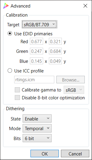

Update 4
Darker color shades can exhibit banding/posterization. The lower the refresh rate (including low FPS VRR at 240Hz), the more visible the issue becomes. Using 6-bit temporal dithering helps quite a bit. This includes 10-bit HDR mode. You can use novideo_srgb to set 6-bit temporal dither in the "advanced" settings of novideo_srgb. You can also set it in Special K, if you use that (and it's a permanent global setting that applies to everything, just like with novideo_srgb.)
Do not enable the sRGB color clamp checkbox in novideo_srgb for HDR! Only enable dithering.
This HDR gradient test improves by a lot with 6-bit temporal dither: https://www.youtube.com/watch?v=PoMPrr-Uefs

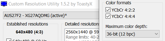

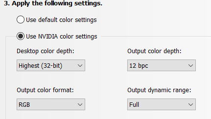

Like most W-OLED displays, the monitor supports 12-bit color, not just 10-bit. It needs to be added with ToastyX CRU. I do not know whether or not it has any benefits compared to 10-bit.
With DSC turned off, 144Hz is the highest refresh rate where you can enable 12-bit colors.

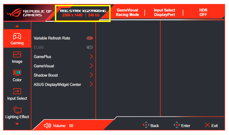

I noticed that DSC can be turned off in the OSD. This limits 10-bit to a max of 180Hz. For 240Hz only 8-bit is allowed. So apparently the only reason to keep DSC enabled with this monitor is for just one mode: 10-bit 240Hz 1440p.
One thing I don't like is that the OSD doesn't tell you which refresh rate mode it's using. If I run 240Hz or 144Hz or whatever, it only shows the current VRR refresh rate, so I have no idea if I'm using max Hz mode or not. Also, the OSD has quite a few useless Asus nonsense that nobody needs. RPG mode, Racing mode, MOBA mode, Night Vision mode... Using "MOBA mode" for example just turns everything green. What's the point? None whatsoever. It only clutters the OSD needlessly. Instead of that, I would rather want the OSD to tell me the maximum Hz of the current video mode.
Do you not have this readout? Pulled it from your monitor manual.
That should give you your currently set physical refresh rate, or does it change with VRR? Mine doesn't; it has a separate readout for VRR.
(jorimt: /jor-uhm-tee/)
Displays: ASUS PG27AQN, LG 48C4 OS: Windows 11 Pro Case: Fractal Design Torrent PSU: Seasonic PRIME TX-1000 MB: ASUS Z790 Hero CPU: Intel i9-13900k w/Noctua NH-U12A GPU: GIGABYTE RTX 4090 GAMING OC RAM: 32GB G.SKILL Trident Z5 DDR5 6400MHz CL32 SSDs: 2TB WD_BLACK SN850 (OS), 4TB WD_BLACK SN850X (Games) Keyboard: Wooting 60HE v2 Mouse: Logitech G Pro X2 SUPERSTRIKE Sound: Creative Sound Blaster Katana V2 VR: Beyond 2, Quest 3, Reverb G2, Index Consoles: N64, Analogue 3D, Dreamcast, PS2, PS3, PS5 Pro, Switch 2, Wii, Xbox, Xbox 360, Analogue Pocket + Dock Scaler: RetroTINK 4k
Posts: 4659
Re: Asus XG27AQDMG Discussion
Post by RealNC » 30 Jul 2024, 22:03
jorimt wrote: ↑
30 Jul 2024, 21:09
Nope, this monitor doesn't have a separate readout. It changes and only shows current VRR refresh rate. And very badly too, since it jumps a lot even with perfectly capped frame pacing.
There is an "Information" section in the OSD that lists all sorts of things, like color depth (8-bit or 10-bit,) color format (like RGB 444,) color range (full or limited,) etc, but they didn't include the current refresh rate, lol.
