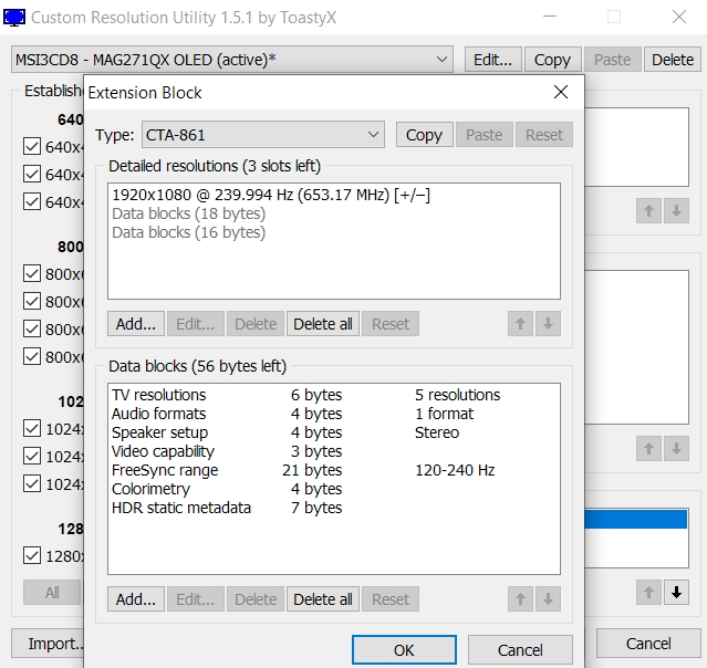

You need to change the FreeSync range, not the refresh rate range.
This is the wrong thing to change:
This is what you should change:

Thanks for reply. I took instruction from displayninja.
They said that for DisplayPort connection the Refresh Rate Range should be changed. For HDMI connection FreeSync Range should be changed. And because mine default FreeSync range is 48-240Hz I thought they are correct, because HDMI max 240Hz.
Looks like they are wrong?
I edited FreeSync Range from 48-240Hz to 120-240Hz - and it worked!
The question is maybe I should edit max FreeSync Range from 240Hz to 360Hz?
Are you using an Nvidia card? If yes, you don't need to. The max freesync Hz is ignored by the nvidia driver. It only looks at the min Hz.
But you can change it to 360Hz anyway. It shouldn't hurt anything.
