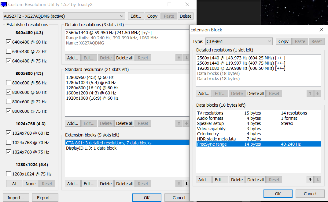

Guys,can someone help me figured out what is the VRR range on this monitor because after trying so many settings its not smooth?
Its a 180hz monitor but i think maybe the range is 48-165hz.
In that situation what settings do i need to use?
Re: VRR range on 24G4XE (24G4) ?
Posted: 17 Dec 2024, 10:24
by RealNC
ToastyX CRU can show it. You need to find the "FreeSync Range" entry in one of the extension blocks:
(Remember to always "Cancel" out of CRU, not click "OK", so you don't modify something by mistake.)
Posted: 17 Dec 2024, 11:07
by maxolini
Thank You it says 48-180hz hopefully is this.
Posted: 21 Dec 2024, 09:21
by maxolini
Is the NVIDIA site updated because this is what it shows ?
Posted: 21 Dec 2024, 10:03
by RealNC
maxolini wrote:
21 Dec 2024, 09:21
It's being updated. But no idea how often.
In any event, keep in mind that the Nvidia driver ignores the upper limit anyway. Only the current mode matters. If you switch to 144Hz for example, the range becomes 48-144. Even if you modify the EDID with CRU and change it to something like "48-120", the Nvidia driver will only look at the "48" and use the current display mode's refresh rate as the upper limit.
Well, at least that's how it behaved for me when I tested this. No matter how much I lowered the upper value in the FreeSync field, g-sync remained active at all times, even if the game's FPS went above the range. So it looks like it's just ignored and only the lower limit matters.
