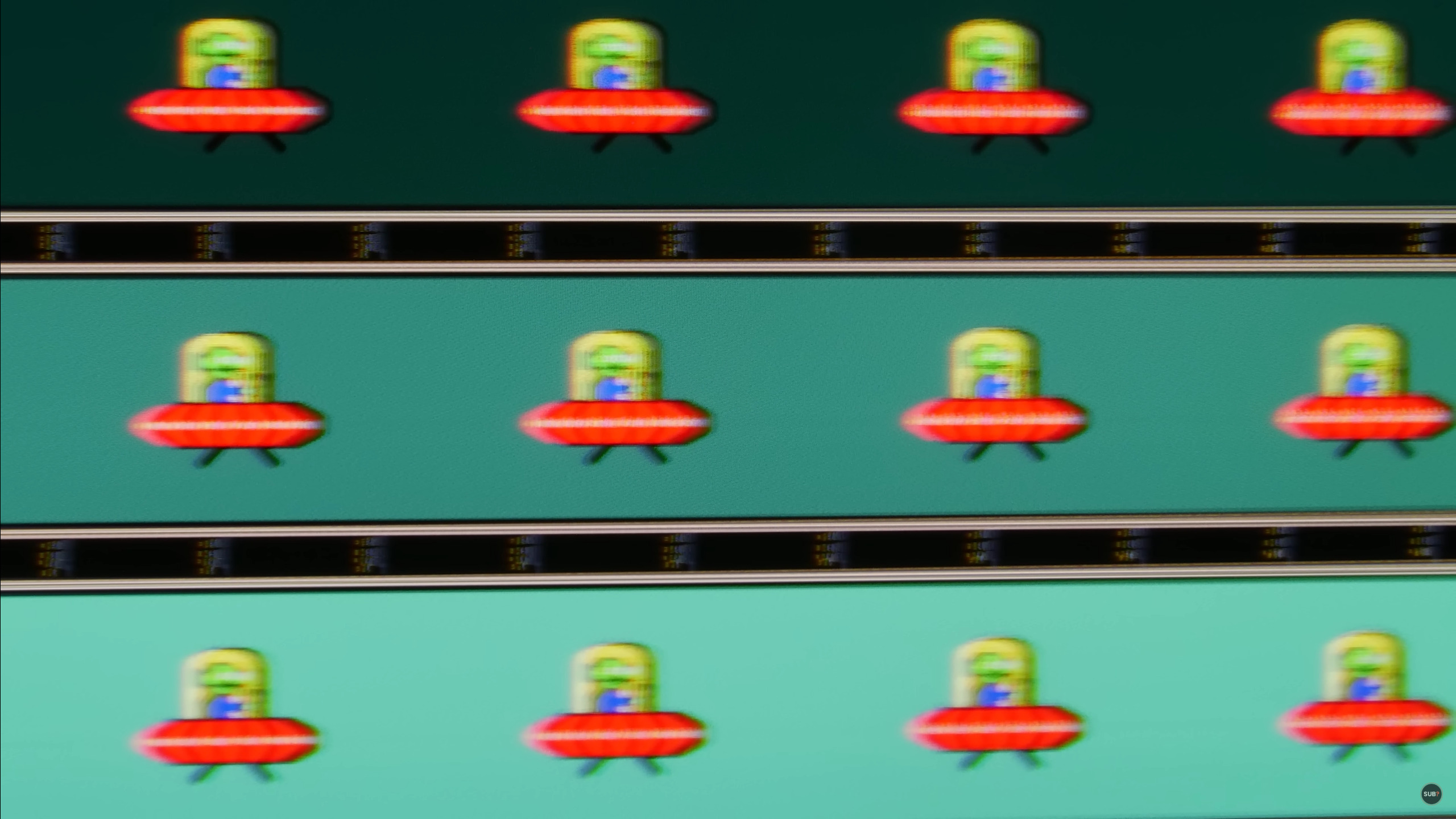

Small update for you guys. This panasonic plasma at 60hz is not infact equivalent to 60hz oled. It's much worse. I got the ufo on for a few minutes. The whole ufo was ghosted around 4 pixels wide. With yellow smearing near the size of the upper body.
Do plasmas motion capabilities deteriorate? This is after all a 2008 set with more than 10,000 hours on it. Even if it was high end 1080p $900 in it's time.

Stilgar from moreleTB did a pursuit shot of plasma.
source: https://youtu.be/pMOAbLaDU7U?si=z9QincwdpsMkuD6U&t=513

Well, plasma has phosphor trails, OLED doesn't, so that's probably what you're referring to:purplemelon1 wrote: ↑02 Jul 2025, 11:34This panasonic plasma at 60hz is not infact equivalent to 60hz oled. It's much worse. I got the ufo on for a few minutes. The whole ufo was ghosted around 4 pixels wide. With yellow smearing near the size of the upper body.
https://www.hdtvtest.co.uk/news/plasma- ... 2007040133
Had them on my ST60 as well.
The primary advantage plasma has over non-strobed OLED is MPRT.

That photo discorz linked is pretty close to what i saw in person. There are two main differences. The ghosting and trailing are much more faint than what the picture captured. But i believe in person would also have that faintness. As you can see in the middle ufo onthe left side the yellow is much lighter. The second one is that the alien looks like overshoot in this picture. So this one may be smeared. While what i saw saw just had ghosts behind. Making the alien aligned eith the ufo feet.
I had seen these kinds of pictures before but didn't recognize what i was looking at. I know where the ufo legs are is where the actual ufo is. Now that i understand it's a pretty uniform smear. I would go so far as to call 60fps plasma equivalent to 40-50fps oled. Nevermind 6ms persistence. (60fps blur plus 4 +pixels of smear = 20ms p). So now maybe the only benefit of lower mrpt is latency. But in the modern age with sub 5ms latency even in tvs. That is no longer a pro.
Maybe panasonic was just bad. Thanks to the link by jorimt, i went reading through some old forum posts. Most of the complaints or discussion was about panasonics. Not that it matters since it's dead tech.
Oh and this is only assuming with eye tracking. I don't remember what my eyes stationary saw... But it was worse than the post hence the harsher tone.
