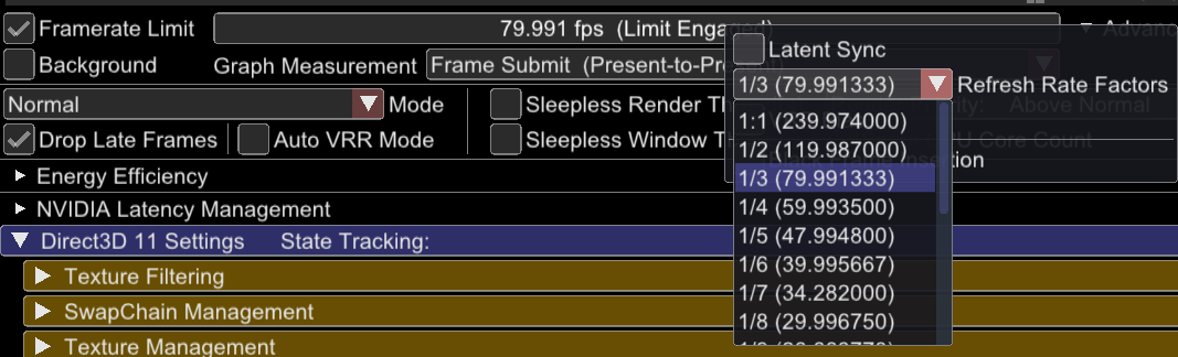

If that's still not good enough and you keep g-sync off, and you normally use lower FPS caps like I do (usually 90FPS to 120FPS, never above that,) another option is to use SpecialK for the FPS cap and choose a fractional FPS cap with normal vsync. To do that, you need to select the "normal" limiter, and right-click on the FPS cap entry bar and select one of the fractional caps (1/2, 1/3, etc.) At 240Hz you can use 60/80/120FPS, at 180Hz you can use 60 or 90FPS. This is what I do for games that have too much flicker:
Note: this is a fractional cap, not fractional v-sync (which would add lag.) Fractional caps with normal vsync are very low latency. Unfortunately, SpecialK's "normal" limiter is the only one I found that is good enough to do this. RTSS and Nvidia limiters always produce judder/jitter if you try a fractional cap with them. Which means you can't do that in online games that use an anti-cheat system (they will either block SpecialK, or trigger a ban because it looks like a cheat to them.)
