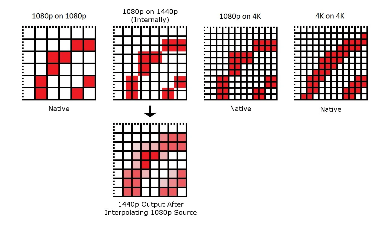

If we're talking about a physical 1440p resolution set in the NVCP on a 4k TV, pretty much unavoidable, yes, and this goes for any lower source resolution that is being upscaled to a resolution that it isn't evenly divisible by:
You can obviously run the C4 at 4k 120Hz, or even 4k 144Hz for both the desktop and games, but I assume you'd avoid that due to the performance impact with your 3080?
In that case, is there a reason in DLSS supported games you wouldn't output them at a native 4k and then use the correct DLSS preset to upscale from 1440p? Because in most DLSS supported titles, the "Balanced" or "Quality" level (can't remember which) should already be a 1440p internal res upscaled to a 4k output by DLSS.
More advanced techniques like DLSS are currently the only viable way to bypass the interpolation blur of non-integer upscaling that I know of.
And as for non-DLSS games, most of them are old enough now that your 3080 can probably achieve an acceptable framerate at a native 4k 120Hz, no?

Appreciate the input and the very useful image! I enjoy a variety of games ranging from fast-action, input lag-sensitive games, competitive, to laid back story games. Ideally I would want to play the competitive games at 1440p, and story games on 4K with dlss, for example. But if there is no way to get around the blurriness and downsides that comes with the non-integer scaling with 1440p to 4K native TV, I probably have to reconsider.
