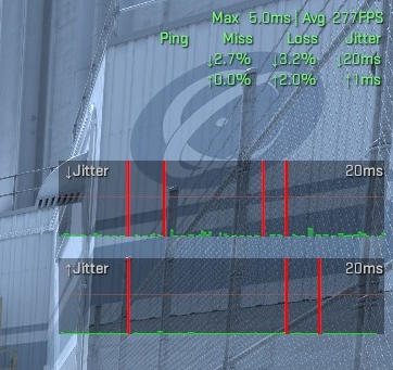

screenshot of an example of jitter graph at broken WiFiber 60GHz:

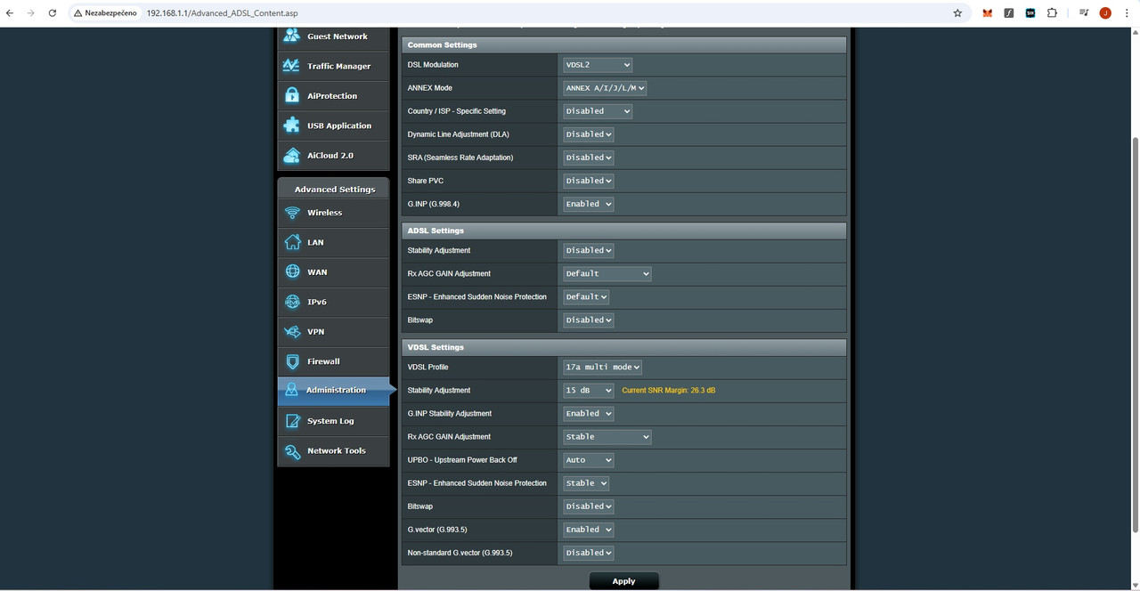

Another warning! Many DSL "improving" features like vectoring, bonding, g.inp, interleaving... may have and usually have a negative impact on gaming! Typically bonding 2 lines will increase (double) speed but will also slightly increase the latency (not much, 1ms usually if both pairs are fine) but it also may cause jitter if the bonus pair is noticably worse! You also need to check SNR on both pairs to be high enough. Interleaving, g.inp, vectoring and other features usually may affect gaming experience too, depending on line quality these protocols may do thing better but also worse. The DSL has many other things you need to check, like uncorrectable CRC errors (if they appear in higher count, they will drop or delay your packets, but if you set high SNR, they usually are eliminated automatically as they appear mostly at lower SNR margin. Correctable errors can be ignored as the latency of line usually includes the time for retransmits and auto correction on lowest network layers (this is why the latency of DSL between you and dslam is not 0-1ms but usually 6-7ms -there is a reserve for retransmits and error corrections, but this latency doesnt matter as its fixed and doesnt cause jitter).
My settings of DSL ASUS ROUTER (a model capable to enforce SNR margin to increase SNR):

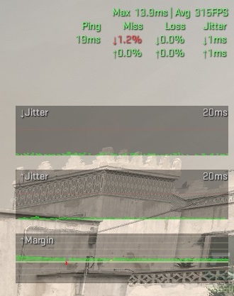

screenshots:

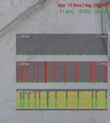

a GPON half broken fibre with very abysmal jitter, causing high frametimes and microlags:

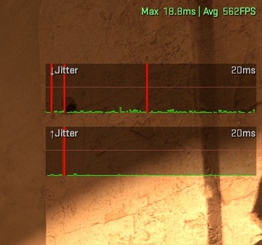

a working not broken alternative (same GPON from the same provider, but different location):
(both scenarios tested with no load at idle line)

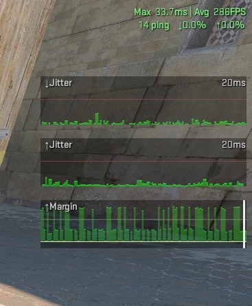

1) Server sided lag. There are a variety of server sided lags, i will describe them with screenshots, and yeah, all of them are server sided.
There is a general rule - if you can find at least one good working server, its not your internet causing the lag. IF you find none after 20+ tries (5-10 is not enough as during prime time EU, especially weekends, 9 of 10 servers fall into the crapserver category... no joke), then maybe you could start to search a problem on your side or in your network.
bad-server - margin freezes, missed packets

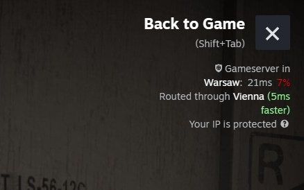

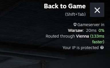

trash server - broken routing (valve usual suspect - warszawa aka lagszawa server, 140ms ping from central europe to warszaw over native routing bruh)
renown.gg platform uses dathost servers, the worst CS2 servers ever, the lag is their best and only friend... All games here lag somehow.
Faceit netherlag uplink in prime time is... not great.

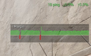

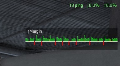

valve official MM server - hard freezing the game (look at margin graph)
another valve warszawa masterpiece - huge packetloss, warsaw is the worst server EU with no competition

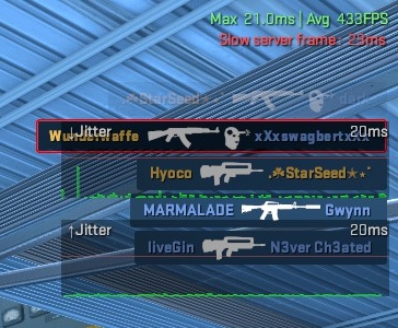

trash server - server sided jitter, margin gaps
trash server - not enough compute power, now realize why we have 64tick only, the servers are still barely capable to compute the "actual" tick (in reality its a tick already passed by) in 15.6ms time frame
trash server - valve premiere official MM with unstable jitter, margin laggy too
faceit netherlands aka netherlag (margin is crap, game stutters hard, doesnt hardfreeze like red negative margin does, but still runs choppy due to unstable margin with stuttery aim as a result)
crappy server with something broken on its upload line hard (game unplayable)
valve official server, game freezes every second hard as visible from margin graph, another masterpiece server

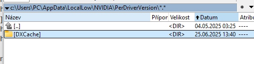

2) DirectX shader cache render lag. This happens especially after game or driver updates (dont forget, last nvidia drivers are all broken, even nvidia recommends to rollback to december 2024 drivers or older, unfortunatelly, the even more older drivers dont run on last windows 11 patch). How to recognize them? The game renders margin freezes like at picture, which have no connection to jitter graph neither server freezes as other players dont experience them.
Solution is -
start with deleting your steam id userdata folder in steam folder
then delete dx shadercache folder
also run disk cleanup, select directX shader memory, delete (you can delete other things too, they are expendable trash)
also then validate cs2 folder file integrity
run cs2 WITH 0MB nvidia control panel shader cache buffer (game will be forced to run the directx cache into memory and not disk)
then increase the shader cache buffer back to unlimited or 100GB and after few weeks you will experience the lag back after some future update...
