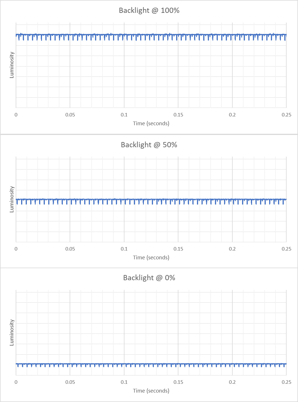

You can check on rtings.com. The ones I looked up were not using PWM. However, they are not flicker-free since they have a slight dip in brightness that matches the refresh rate. Example:
(It says "backlight", even though there's no backlight. It's just rtings using a standardized graph for flicker measurements.)
I've found these graphs from RTINGS to be non-descriptive and counterintuitive for a user to figure out.
Here's a better one:
It seems to be around 15–20% brightness dip across it's brightness range, regardless of setting.
Seemingly related to "gate voltage driver" or how a paper has put it — "internal capacitance of the voltage driver"
LCD's also exhibit this behavior, but to a far lesser degree (usually less than 2% brightness fluctuation every refresh cycle)
