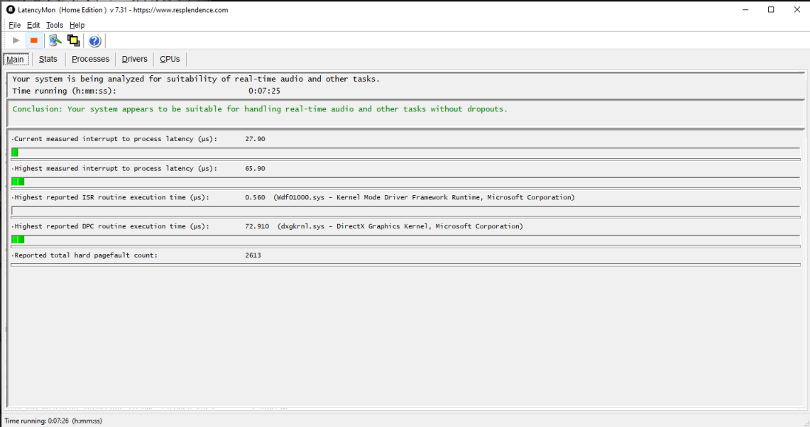

Would you please post a report from latencymon of before and after the change? Might be a confirming factor for others to try and investigate further

I don't have a before picture but this is "idle" test
and this is with discord/chrome/steam/twitch open, it's usually even lower but I launched them with latencymon open and they spike some latency on launch
Don't really like w10 anymore so I might go back to w11 and try to see if all these fixes remain there too.
