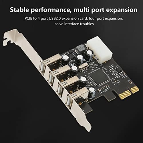

petergase
Posts: 20
Joined: 25 Jul 2021, 09:37
Re: anyway to deactivate usb interrupt moderation?
Post by petergase » 12 Sep 2025, 19:10
Slender wrote: ↑
11 Sep 2025, 00:20
F1zus wrote: ↑
10 Sep 2025, 18:36
Slender wrote: ↑
10 Sep 2025, 09:17
yes, mcs9990 dont have it
How does the mouse feel compared to a direct connection to the CPU USB (AMD)? Does it make sense to buy a separate USB card?
amd cpu usb 2.0 > amd cpu usb 3.0 > mcs9990 > GL 2.0 > intel usb controller
for intel yes, it make sence
ok I bought one and testing right now
msi mode on or off?
and have u installed a driver?
only mouse or also keyboard and audio?
Is that light on your device also permanently red? I connected the power cable.

petergase wrote: ↑
12 Sep 2025, 19:10
Slender wrote: ↑
11 Sep 2025, 00:20
F1zus wrote: ↑
10 Sep 2025, 18:36
Slender wrote: ↑
10 Sep 2025, 09:17
msi mode on or off?
there is only non-msi mode.
there is 8 separate controller inside (4 - 1.1, 4 - 2.0), you can connect keyboard and mice.
i dont use power cable for it.

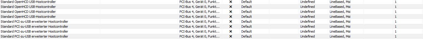

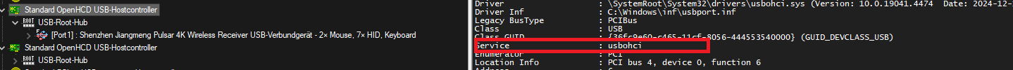

thats the one I have usb 2.0
and you havent installed any additional drivers?
also somehow it has a msi mode
