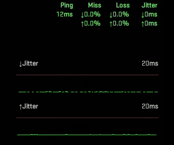

:arrow: In my situation since i got fiber I noticed that in the CS2 Margin Graph i have frequent yellow lines, those were not present when i had coax cable. The more yellow lines the less responsive my input feels (delayed strafe on keyboard) and delayed mouse input, in general everything will be delayed. Both my jitter are at 0ms straight lines but the gameplay feels very choppy and delayed, even though i have 500+ FPS on a 360Hz Zowie monitor.

Here are my results :
Fiber
Fiber
:arrow: If you are on fiber or you think you have CS2 issues related to network please apply the commands and check the Margin Graph (should be the lowest graph on top right corner of your monitor) and share the results here.
make sure that you test on multiple server and locations. My results are the same no matter the server and location.

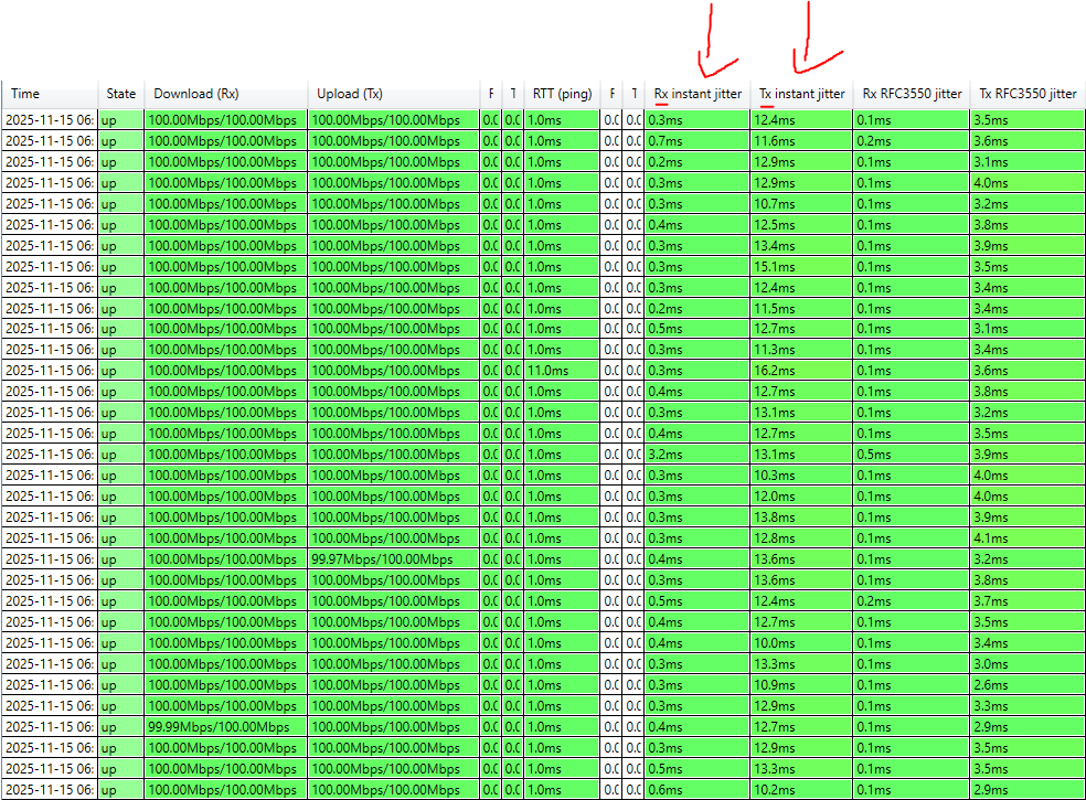

OKAY :idea:
Very important update! :
I found the culprit to my issue : upstream UDP jitter
Here is the proof :
upstream jitter capture.PNG (139.04 KiB) Viewed 12416 times
So even though my XGS-PON Fiber connection is 2Gbp/s UP and Down capable, this is only a 100mbp/s symmetrical test.
As you can see the result above the RX latency (downstream) stays under 1 ms but the TX latency (upstream) is never below 10ms and the value varies a lot which is not good. So waveform bufferbloat and most other "tools" to measure latency are not giving us the full pictures and can somehow overshadow the "raw results" of your ISP... Case closed. Now time to "fight" with my ISP wish me luck :cry:
Conclusion :idea: : i found the culprit to the low in height yellow lines in the CS margin graph after months of research and testing, Valve network engineer and other ppl on twitter and reddit that consider themselves "expert" on the matter were not able to give me a conclusive answer.
well good news if you have the same issue as me (too much yellow lines low in height in cs margin graph) even tho you have no packet loss or bad network values in game, well the issue is :arrow: upstream UDP jitter as shown in my screenshot above.

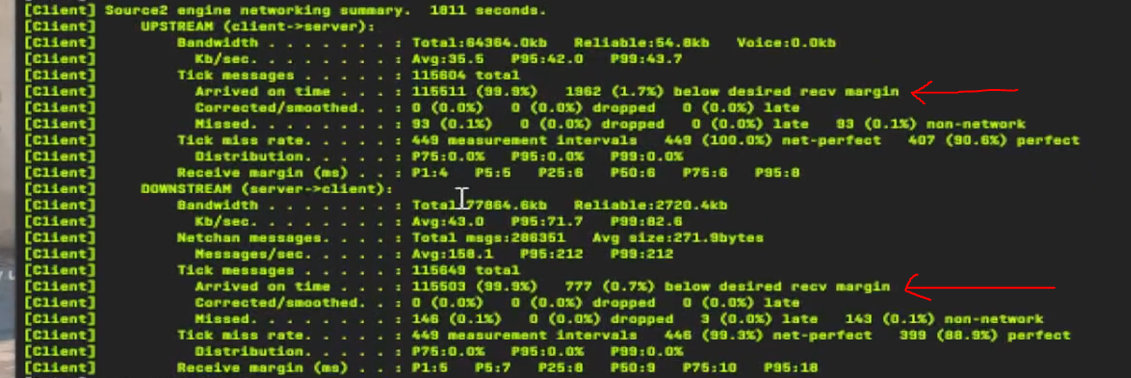

You might also go after match to console and see below margin % stats for both download and upload.

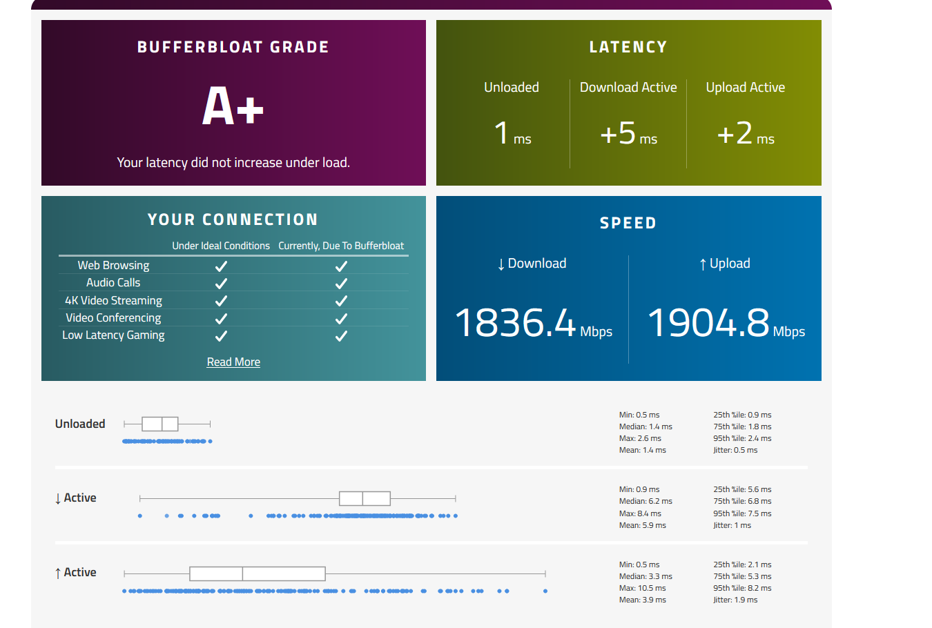

here is my bufferbloat test :
XGS-PON 2Gp/s up and down
resultat bufferbloat.PNG (141.21 KiB) Viewed 13672 times

One of former CS pros stats on faceit after match while streaming:
