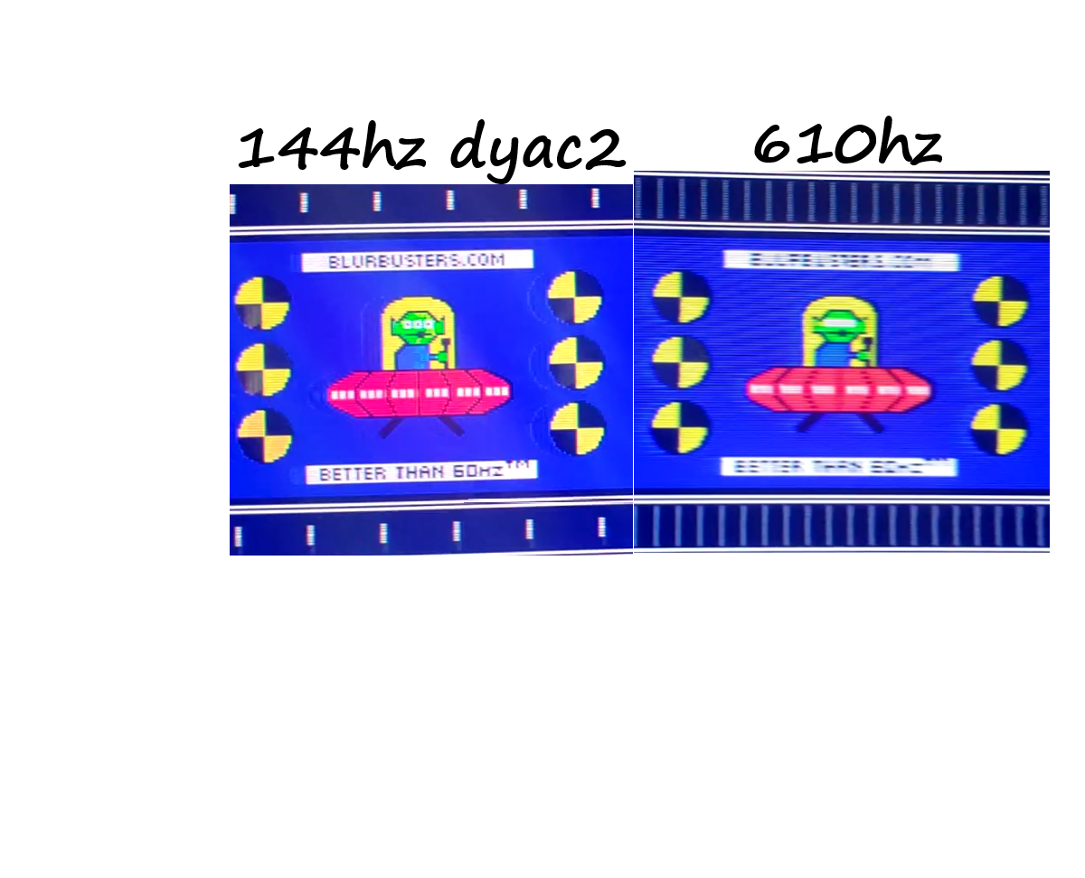

benq zowie has the best motion clarity imo, if you cant hit 600fps and 600hz, just make a custom resolution to what you can achieve, i was playing a game at 144hz 144fps on zowie dyac2, amazing clarity
I'm pretty certain that the 86X+ has a fixed pulse width akin to other DyAc2 models.
144Hz shouldn't look sharp at all.
From the 66X+ review, that DyAc2 model (when setting it to the highest setting) has a voltage boosting behavior of ~1000cd/m² down to ~250², which would be ~25% PW.
This would make 144Hz on it ~2ms on strobe period.
I highly doubt that the X2586X+ is remotely better than this, since Zowie (& majority of other vendors) optimize displays for the highest refresh rate setting. It likely targets a even higher pulse width...
only 960 pixel/s, has more crosstalk, but it looks really clear in games

MSIfanboy wrote: ↑
04 Feb 2026, 13:59
The pursuit ladder pattern doesn't align on the 144Hz DyAc photograph.
Be also mindful that 144Hz doesn't scale evenly on 960px/s, which means that the left UFO isn't 960px/s.
It's either ~864 px/s (6 px/fr) or 1004 px/s (7 px/fr)
The right UFO is slightly faster (1220 px/s)
I've come across this analysis which seemingly claims:
DyAc Premium:
• a 12–15% PW @ 120 Hz
• a 15–23% PW @ 240 Hz
• a 20–31% PW @ 500 Hz
• a 19–32% PW @ 600 Hz
DyAc High:
• 16–18% PW @ 120 Hz
• 17–25% PW @ 240 Hz
• 22–32% PW @ 500 Hz
• 23–32% PW @ 600 Hz
That would somewhat coincide with the photograph you've provided

Sorry I wasnt trying to be accurate in pursuit, 6am just quickly trying to reply before work , but ufo wise 144hz dyac2 is clearer than 610hz non strobed TN LCD (excluding noticeable crosstalk)
