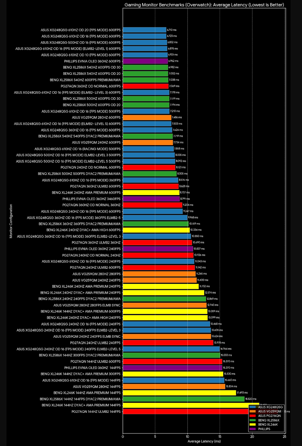

Input LAG - Various Popular Monitors
This took a long time, using makeshift ldat
- Screenshot 2026-03-21 232746.png (556.16 KiB) Viewed 3146 times

Re: Input LAG - Various Popular Monitors
What tool was used for this testing data? Is this your data?
Averages are extremely misleading.
Do you have the access to the raw data, so one can extrapolate based on other descriptive statistics?
arduino + Miniature Solar Cell - BPW34 + using reflex latency flash box (excluding mouse latency)

09:37:10.059 -> MIN : 10.172 ms
09:37:10.059 -> MAX : 20.444 ms
09:37:10.059 -> JITTER : 2.215 ms (Standard Deviation)
BENQ XL246K 240HZ DYAC+ AMA HIGH 600FPS
--- FINAL BENCHMARK ---
21:23:15.857 -> AVG : 10.334 ms
21:23:15.857 -> MIN : 6.864 ms
21:23:15.857 -> MAX : 13.944 ms
21:23:15.857 -> JITTER : 1.644 ms (Standard Deviation)
BENQ XL246K 240HZ DYAC+ AMA PREMIUM 600FPS
21:55:36.814 -> AVG : 9.925 ms
21:55:36.860 -> MIN : 7.020 ms
21:55:36.860 -> MAX : 13.508 ms
21:55:36.860 -> JITTER : 1.420 ms (Standard Deviation)
BENQ XL246K 240HZ AMA PREMIUM 600FPS
21:59:20.280 -> AVG : 8.737 ms
21:59:20.326 -> MIN : 6.052 ms
21:59:20.326 -> MAX : 11.876 ms
21:59:20.326 -> JITTER : 1.391 ms (Standard Deviation)
BENQ XL246K 240HZ AMA PREMIUM 240FPS
21:41:52.707 -> AVG : 11.732 ms
21:41:52.707 -> MIN : 8.364 ms
21:41:52.707 -> MAX : 16.820 ms
21:41:52.707 -> JITTER : 2.095 ms (Standard Deviation)
BENQ XL246K 240HZ DYAC+ AMA PREMIUM 240FPS
21:45:18.548 -> AVG : 12.574 ms
21:45:18.548 -> MIN : 9.296 ms
21:45:18.548 -> MAX : 17.704 ms
21:45:18.548 -> JITTER : 2.195 ms (Standard Deviation)
BENQ XL246K 240HZ DYAC+ AMA HIGH 240FPS
21:48:43.949 -> AVG : 13.099 ms
21:48:43.949 -> MIN : 9.532 ms
21:48:43.949 -> MAX : 18.184 ms
21:48:43.949 -> JITTER : 2.036 ms (Standard Deviation)
BENQ XL246K 144HZ DYAC+ AMA PREMIUM 600FPS
22:04:58.423 -> AVG : 13.059 ms
22:04:58.423 -> MIN : 9.132 ms
22:04:58.423 -> MAX : 16.928 ms
22:04:58.423 -> JITTER : 2.122 ms (Standard Deviation)
BENQ XL246K 144HZ DYAC+ AMA PREMIUM 300FPS
22:09:06.557 -> AVG : 15.530 ms
22:09:06.557 -> MIN : 10.532 ms
22:09:06.593 -> MAX : 20.288 ms
22:09:06.593 -> JITTER : 2.170 ms (Standard Deviation)
BENQ XL246K 144HZ DYAC+ AMA PREMIUM 144FPS
22:11:55.342 -> AVG : 21.102 ms
22:11:55.342 -> MIN : 15.244 ms
22:11:55.342 -> MAX : 27.152 ms
22:11:55.342 -> JITTER : 2.886 ms (Standard Deviation)
BENQ XL246K 144HZ AMA PREMIUM 144FPS
22:18:12.302 -> AVG : 17.493 ms
22:18:12.302 -> MIN : 13.324 ms
22:18:12.342 -> MAX : 26.084 ms
22:18:12.342 -> JITTER : 2.579 ms (Standard Deviation)
PG27AQN 360HZ OD NORMAL 600FPS
22:54:03.449 -> AVG : 7.069 ms
22:54:03.449 -> MIN : 4.928 ms
22:54:03.449 -> MAX : 9.876 ms
22:54:03.449 -> JITTER : 1.064 ms (Standard Deviation)
PG27AQN 360HZ ULMB2 600FPS
22:40:03.509 -> AVG : 8.628 ms
22:40:03.509 -> MIN : 6.100 ms
22:40:03.509 -> MAX : 12.016 ms
22:40:03.509 -> JITTER : 1.219 ms (Standard Deviation)
PG27AQN 360HZ ULMB2 360HZ
22:43:27.077 -> AVG : 10.690 ms
22:43:27.077 -> MIN : 8.292 ms
22:43:27.077 -> MAX : 13.100 ms
22:43:27.077 -> JITTER : 1.028 ms (Standard Deviation)
PG27AQN 360HZ OD NORMAL 360HZ
22:50:34.235 -> AVG : 9.204 ms
22:50:34.235 -> MIN : 6.660 ms
22:50:34.278 -> MAX : 11.460 ms
22:50:34.278 -> JITTER : 1.061 ms (Standard Deviation)
PG27AQN 240HZ OD NORMAL 240HZ
22:57:52.473 -> AVG : 10.926 ms
22:57:52.473 -> MIN : 7.788 ms
22:57:52.473 -> MAX : 16.656 ms
22:57:52.473 -> JITTER : 1.955 ms (Standard Deviation)
PG27AQN 240HZ ULMB2 240FPS
23:01:03.623 -> AVG : 13.978 ms
23:01:03.623 -> MIN : 10.768 ms
23:01:03.663 -> MAX : 19.312 ms
23:01:03.663 -> JITTER : 2.188 ms (Standard Deviation)
PG27AQN 240HZ ULMB2 600FPS
23:04:43.167 -> AVG : 11.142 ms
23:04:43.167 -> MIN : 7.976 ms
23:04:43.167 -> MAX : 13.992 ms
23:04:43.167 -> JITTER : 1.379 ms (Standard Deviation)
PG27AQN 240HZ OD NORMAL 600FPS
23:08:04.112 -> AVG : 8.123 ms
23:08:04.112 -> MIN : 5.272 ms
23:08:04.112 -> MAX : 10.856 ms
23:08:04.112 -> JITTER : 1.282 ms (Standard Deviation)
PG27AQN 144HZ ULMB2 600FPS
23:12:45.824 -> AVG : 15.370 ms
23:12:45.824 -> MIN : 11.120 ms
23:12:45.857 -> MAX : 19.900 ms
23:12:45.857 -> JITTER : 2.186 ms (Standard Deviation)
PG27AQN 144HZ ULMB2 144FPS
23:16:27.634 -> AVG : 23.978 ms
23:16:27.634 -> MIN : 17.252 ms
23:16:27.634 -> MAX : 31.360 ms
23:16:27.634 -> JITTER : 3.264 ms (Standard Deviation)
ASUS XG248QSG 610HZ OD 16 (RACING MODE) 500FPS
05:36:37.619 -> AVG : 7.858 ms
05:36:37.619 -> MIN : 5.868 ms
05:36:37.619 -> MAX : 10.048 ms
05:36:37.619 -> JITTER : 0.883 ms (Standard Deviation)
ASUS XG248QSG 610HZ OD 16 (FPS MODE) 500FPS
05:41:49.630 -> AVG : 7.210 ms
05:41:49.630 -> MIN : 5.264 ms
05:41:49.630 -> MAX : 8.968 ms
05:41:49.630 -> JITTER : 0.884 ms (Standard Deviation)
ASUS XG248QSG 610HZ OD 16 (FPS MODE) 600FPS
05:45:41.284 -> AVG : 6.723 ms
05:45:41.284 -> MIN : 4.860 ms
05:45:41.284 -> MAX : 8.984 ms
05:45:41.284 -> JITTER : 0.836 ms (Standard Deviation)
ASUS XG248QSG 610HZ OD 16 (FPS MODE) (ELMB2-LEVEL 1) 600FPS
05:49:48.737 -> AVG : 6.875 ms
05:49:48.737 -> MIN : 4.924 ms
05:49:48.737 -> MAX : 9.544 ms
05:49:48.737 -> JITTER : 0.975 ms (Standard Deviation)
ASUS XG248QSG 610HZ OD 16 (FPS MODE) (ELMB2- LEVEL 3) 600FPS
05:53:40.808 -> AVG : 7.178 ms
05:53:40.808 -> MIN : 5.352 ms
05:53:40.808 -> MAX : 9.356 ms
05:53:40.808 -> JITTER : 0.854 ms (Standard Deviation)
ASUS XG248QSG 610HZ OD 16 (FPS MODE) (ELMB2- LEVEL 5) 600FPS
05:59:49.403 -> AVG : 7.503 ms
05:59:49.403 -> MIN : 5.904 ms
05:59:49.403 -> MAX : 9.936 ms
05:59:49.403 -> JITTER : 0.842 ms (Standard Deviation)
ASUS XG248QSG 610HZ OD 20 (FPS MODE) 600FPS
06:03:09.944 -> AVG : 6.713 ms
06:03:09.944 -> MIN : 4.716 ms
06:03:09.944 -> MAX : 8.876 ms
06:03:09.990 -> JITTER : 0.825 ms (Standard Deviation)
ASUS XG248QSG 610HZ OD 10 (FPS MODE) 600FPS
06:06:48.675 -> AVG : 6.921 ms
06:06:48.675 -> MIN : 5.068 ms
06:06:48.675 -> MAX : 8.784 ms
06:06:48.675 -> JITTER : 0.895 ms (Standard Deviation)
ASUS XG248QSG 500HZ OD 16 (FPS MODE) 600FPS
06:10:35.379 -> AVG : 6.832 ms
06:10:35.379 -> MIN : 4.816 ms
06:10:35.379 -> MAX : 9.456 ms
06:10:35.379 -> JITTER : 0.900 ms (Standard Deviation)
ASUS XG248QSG 360HZ OD 16 (FPS MODE) 600FPS
06:13:50.178 -> AVG : 7.624 ms
06:13:50.215 -> MIN : 5.044 ms
06:13:50.215 -> MAX : 10.120 ms
06:13:50.215 -> JITTER : 1.005 ms (Standard Deviation)
ASUS XG248QSG 240HZ OD 16 (FPS MODE) 600FPS
06:17:12.642 -> AVG : 9.247 ms
06:17:12.642 -> MIN : 6.500 ms
06:17:12.642 -> MAX : 12.188 ms
06:17:12.642 -> JITTER : 1.343 ms (Standard Deviation)
ASUS XG248QSG 240HZ OD 16 (FPS MODE) 240FPS
06:21:24.933 -> AVG : 13.468 ms
06:21:24.933 -> MIN : 9.104 ms
06:21:24.933 -> MAX : 16.808 ms
06:21:24.933 -> JITTER : 1.601 ms (Standard Deviation)
ASUS XG248QSG 240HZ OD 16 (FPS MODE) 240FPS ELMB2-LEVEL 3
06:25:20.648 -> AVG : 13.605 ms
06:25:20.686 -> MIN : 9.604 ms
06:25:20.686 -> MAX : 18.312 ms
06:25:20.686 -> JITTER : 1.748 ms (Standard Deviation)
ASUS XG248QSG 240HZ OD 16 (FPS MODE) 240FPS ELMB2-LEVEL 5
06:28:46.344 -> AVG : 14.964 ms
06:28:46.344 -> MIN : 11.276 ms
06:28:46.344 -> MAX : 18.580 ms
06:28:46.344 -> JITTER : 1.965 ms (Standard Deviation)
ASUS XG248QSG 360HZ OD 16 (FPS MODE) 360FPS ELMB2-LEVEL 3
06:58:58.894 -> AVG : 10.550 ms
06:58:58.894 -> MIN : 6.184 ms
06:58:58.894 -> MAX : 13.444 ms
06:58:58.894 -> JITTER : 1.256 ms (Standard Deviation)
ASUS XG248QSG 360HZ OD 16 (FPS MODE) 360FPS ELMB2-5
06:55:19.998 -> AVG : 9.968 ms
06:55:19.998 -> MIN : 7.172 ms
06:55:19.998 -> MAX : 11.612 ms
06:55:19.998 -> JITTER : 0.922 ms (Standard Deviation)
ASUS XG248QSG 610HZ OD 16 (FPS MODE) 360FPS
06:32:44.798 -> AVG : 8.576 ms
06:32:44.798 -> MIN : 5.820 ms
06:32:44.798 -> MAX : 11.232 ms
06:32:44.798 -> JITTER : 1.170 ms (Standard Deviation)
ASUS XG248QSG 610HZ OD 16 (FPS MODE) 240FPS
06:36:11.626 -> AVG : 11.043 ms
06:36:11.626 -> MIN : 7.664 ms
06:36:11.626 -> MAX : 13.972 ms
06:36:11.626 -> JITTER : 1.397 ms (Standard Deviation)
ASUS XG248QSG 610HZ OD 16 (FPS MODE) 144FPS
06:39:19.238 -> AVG : 15.660 ms
06:39:19.276 -> MIN : 10.984 ms
06:39:19.276 -> MAX : 20.132 ms
06:39:19.276 -> JITTER : 2.241 ms (Standard Deviation)
ASUS XG248QSG 500HZ OD 16 (FPS MODE) ELMB2-LEVEL 3 500FPS
07:02:42.160 -> AVG : 8.035 ms
07:02:42.160 -> MIN : 6.212 ms
07:02:42.160 -> MAX : 10.336 ms
07:02:42.160 -> JITTER : 1.009 ms (Standard Deviation)
ASUS XG248QSG 500HZ OD 16 (FPS MODE) ELMB2-LEVEL 5 500FPS
07:07:08.053 -> AVG : 8.092 ms
07:07:08.053 -> MIN : 5.056 ms
07:07:08.053 -> MAX : 10.328 ms
07:07:08.053 -> JITTER : 1.137 ms (Standard Deviation)
ASUS VG259QM 280HZ 600FPS
07:29:34.482 -> AVG : 7.486 ms
07:29:34.482 -> MIN : 4.532 ms
07:29:34.482 -> MAX : 10.448 ms
07:29:34.482 -> JITTER : 1.248 ms (Standard Deviation)
ASUS VG259QM 240HZ 600FPS
07:33:18.798 -> AVG : 7.734 ms
07:33:18.836 -> MIN : 4.432 ms
07:33:18.836 -> MAX : 11.496 ms
07:33:18.836 -> JITTER : 1.582 ms (Standard Deviation)
ASUS VG259QM 240HZ 240FPS
07:49:45.804 -> AVG : 11.400 ms
07:49:45.804 -> MIN : 7.312 ms
07:49:45.804 -> MAX : 16.176 ms
07:49:45.804 -> JITTER : 1.698 ms (Standard Deviation)
ASUS VG259QM 280HZ 280FPS
07:53:47.452 -> AVG : 11.245 ms
07:53:47.452 -> MIN : 6.988 ms
07:53:47.452 -> MAX : 14.196 ms
07:53:47.498 -> JITTER : 1.546 ms (Standard Deviation)
ASUS VG259QM 280HZ 144FPS
07:56:45.714 -> AVG : 15.834 ms
07:56:45.759 -> MIN : 10.772 ms
07:56:45.759 -> MAX : 21.372 ms
07:56:45.759 -> JITTER : 2.296 ms (Standard Deviation)
ASUS VG259QM 240HZ 240FPS ELMB SYNC
08:00:59.068 -> AVG : 13.624 ms
08:00:59.068 -> MIN : 9.864 ms
08:00:59.068 -> MAX : 18.708 ms
08:00:59.068 -> JITTER : 2.016 ms (Standard Deviation)
ASUS VG259QM 280HZ 280FPS ELMB SYNC
08:04:33.795 -> AVG : 12.943 ms
08:04:33.795 -> MIN : 8.788 ms
08:04:33.795 -> MAX : 15.836 ms
08:04:33.795 -> JITTER : 1.780 ms (Standard Deviation)
BENQ XL2586X 500HZ 500FPS DYAC2 PREMIUM/AMA
08:26:39.061 -> AVG : 8.305 ms
08:26:39.061 -> MIN : 6.260 ms
08:26:39.061 -> MAX : 10.072 ms
08:26:39.061 -> JITTER : 0.894 ms (Standard Deviation)
BENQ XL2586X 360HZ 360FPS DYAC2 PREMIUM/AMA
08:30:33.127 -> AVG : 10.159 ms
08:30:33.127 -> MIN : 7.484 ms
08:30:33.127 -> MAX : 12.740 ms
08:30:33.127 -> JITTER : 1.328 ms (Standard Deviation)
BENQ XL2586X 240HZ 240FPS DYAC2 PREMIUM/AMA
08:34:03.859 -> AVG : 12.869 ms
08:34:03.859 -> MIN : 9.508 ms
08:34:03.859 -> MAX : 17.680 ms
08:34:03.906 -> JITTER : 2.189 ms (Standard Deviation)
BENQ XL2586X 144HZ 144FPS DYAC2 PREMIUM/AMA
08:40:49.835 -> AVG : 18.820 ms
08:40:49.835 -> MIN : 14.872 ms
08:40:49.835 -> MAX : 27.212 ms
08:40:49.835 -> JITTER : 2.274 ms (Standard Deviation)
BENQ XL2586X 144HZ 300FPS DYAC2 PREMIUM/AMA
08:44:11.755 -> AVG : 15.033 ms
08:44:11.755 -> MIN : 10.524 ms
08:44:11.755 -> MAX : 19.808 ms
08:44:11.755 -> JITTER : 2.453 ms (Standard Deviation)
BENQ XL2586X 540HZ 540FPS DYAC2 PREMIUM/AMA
08:48:25.923 -> AVG : 7.719 ms
08:48:25.923 -> MIN : 5.808 ms
08:48:25.923 -> MAX : 9.784 ms
08:48:25.923 -> JITTER : 0.845 ms (Standard Deviation)
BENQ XL2586X 540HZ 600FPS PREMIUM/AMA
08:52:17.316 -> AVG : 7.038 ms
08:52:17.316 -> MIN : 5.436 ms
08:52:17.316 -> MAX : 9.004 ms
08:52:17.316 -> JITTER : 0.772 ms (Standard Deviation)
BENQ XL2586X 540HZ 600FPS OD 20
08:57:11.044 -> AVG : 7.002 ms
08:57:11.089 -> MIN : 5.268 ms
08:57:11.089 -> MAX : 9.032 ms
08:57:11.089 -> JITTER : 0.840 ms (Standard Deviation)
BENQ XL2586X 540HZ 600FPS OD 30
09:03:08.337 -> AVG : 6.982 ms
09:03:08.372 -> MIN : 5.232 ms
09:03:08.372 -> MAX : 9.740 ms
09:03:08.372 -> JITTER : 0.962 ms (Standard Deviation)
BENQ XL2586X 500HZ 600FPS OD 30
09:07:21.400 -> AVG : 7.179 ms
09:07:21.400 -> MIN : 5.416 ms
09:07:21.400 -> MAX : 9.612 ms
09:07:21.400 -> JITTER : 0.849 ms (Standard Deviation)
BENQ XL2586X 500HZ 600FPS OD 20
09:10:46.309 -> AVG : 7.194 ms

PHILLIPS EVNIA OLED 360HZ 600FPS
09:26:33.804 -> AVG : 6.952 ms
09:26:33.804 -> MIN : 4.368 ms
09:26:33.804 -> MAX : 9.656 ms
09:26:33.804 -> JITTER : 1.294 ms (Standard Deviation)
PHILLIPS EVNIA OLED 360HZ 3460FPS
09:30:37.575 -> AVG : 8.791 ms
09:30:37.575 -> MIN : 5.712 ms
09:30:37.575 -> MAX : 11.204 ms
09:30:37.575 -> JITTER : 1.273 ms (Standard Deviation)
PHILLIPS EVNIA OLED 360HZ 240FPS
09:33:52.697 -> AVG : 10.837 ms
09:33:52.732 -> MIN : 7.552 ms
09:33:52.732 -> MAX : 13.676 ms
09:33:52.732 -> JITTER : 1.453 ms (Standard Deviation)
PHILLIPS EVNIA OLED 360HZ 144FPS
09:37:10.059 -> AVG : 15.370 ms
