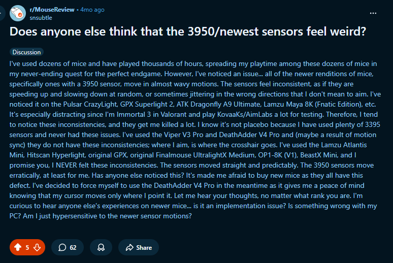

i have tried a mouse with 3395 sensor it works fine really good and it go where i aim but when i bought a mouse with 3950 sensor it feels floaty and inconsistent i though it was a placebo but i found a reddit post that say the same things about pmw3950 sensor
is there any way to fix it , may be it is windows problem idk .
