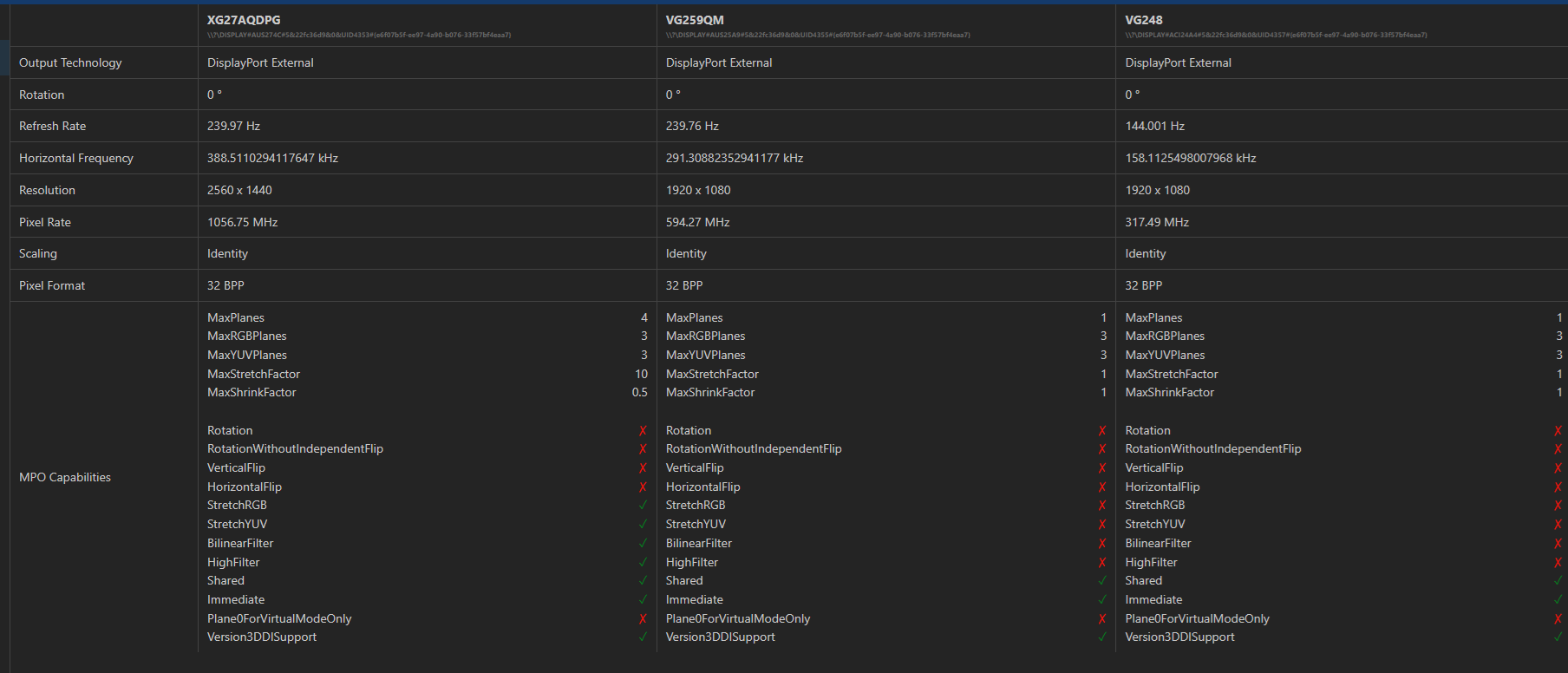

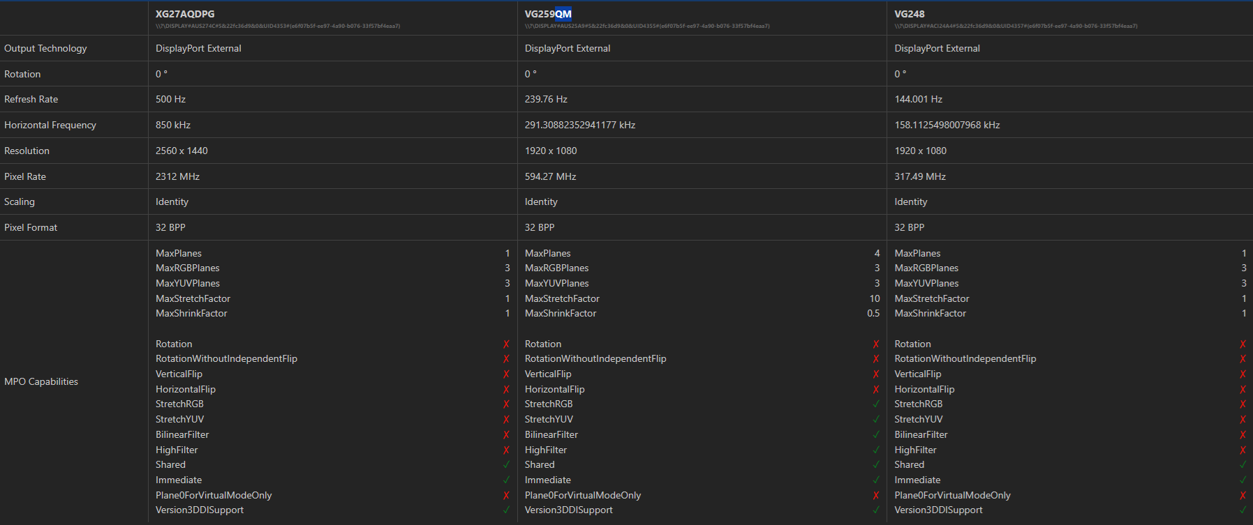

ekajjj
Posts: 11
Joined: 16 Jul 2021, 07:19
Re: 1440p 360Hz w/o DSC (HDMI 2.1)
Post by ekajjj » 14 Jun 2026, 10:37
Per screenshots below, with DSC on at 500hz, No MPO. DSC off, max 240hz, MPO works. No other changes. Independent Flip becomes avaialble then.
