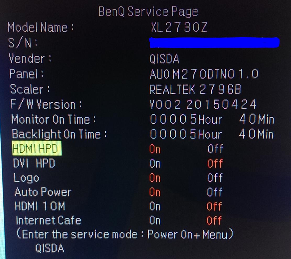

Does anyone know how to tell what version of Firmware you have for the BenQ XL2730Z? I have that monitor however not sure where to check.
Re: BenQ XL2730Z Firmware Update V002
Posted: 23 Jun 2015, 22:22
by Falkentyne
It's the same keystroke from the other Z series monitors.
The first service menu, with the firmware version (which no longer has the strobe duty/phase/single strobe adjustments anymore) is
power off monitor, hold button #4 for 5 seconds, then press power and then release both power and, then after, button 4 in that order.
The factory menu (aka "burn-in" menu) which also has an overdrive gain setting (this may simply be the exact same as "AMA", although people would need to test changing this and then the AMA setting afterwards, or vice versa), is button #3 and #4 (enter+menu) for 5 seconds and then pressing power to power on.
There's a lot more stuff in the factory menu than there is in the previous blur reduction monitors (2430T, 2720Z, 2420Z, 2411Z).
Posted: 24 Jun 2015, 00:35
by troybal
Falkentyne wrote:It's the same keystroke from the other Z series monitors.
Great, thanks,
I was able to see that the monitor is on V002.
