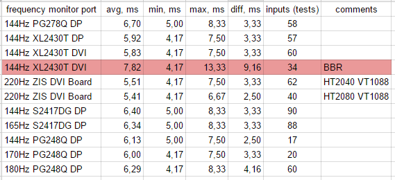

Hello blurbusters!
In this thread I want to hear recommendations and help with getting best results of testing full input lag chain (from mouse button to monitor pixel) with different monitors.
My equipment currently is:
Mouse: Logitech G100S mouse with LED connected to right mouse button
Camera: Nikon 1 J1 that can capture 5 seconds video with 320x120 at 1200 fps
Software: ioquake3 1.36 (optimized Quake 3 engine) that shows 1000 fps
CPU & Motherboard: Intel Core i5-6600 at Gigabyte GA-H110M-DS2 DDR3
GPU: Asus GTX 950 STRIX-GTX950-DC2OC-2GD5-GAMING
OS: Windows 10 Enterprise LTSB 32-bit
Setup and method looks similar to this one http://www.blurbusters.com/gsync/preview2/
But I positioned camera far back to capture whole screen. Because frame update with VSYNC OFF can start at any part of screen. And I used showing of huge crosshair instead weapon fire.
Example: https://www.youtube.com/watch?v=hFpnim0N6zE
My results are:
As can you see I got too big diffence of several frames (4th column, milliseconds, max - min). That leads to wrong average values (1st column). I guess that can be caused by microlags of ioquake3 caused by too high fps value (sv_fps 1000 & com_maxfps 1000).
Can anybody help with writing code of simple fullscreen directx/opengl/vulkan app with raw mouse input to get better results?
