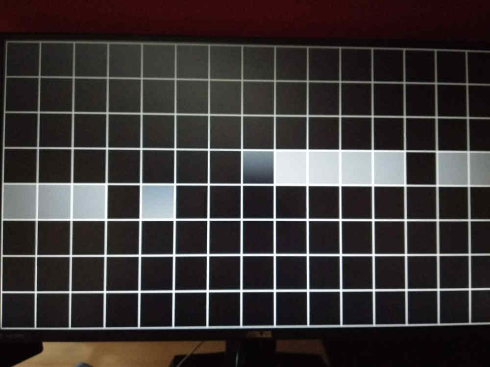

here I uploaded some footage:
120 Hz slowmotion: https://youtu.be/Y9h8tqfMiWw
144Hz stuttering slowmotion: https://youtu.be/98lAOpKC97I

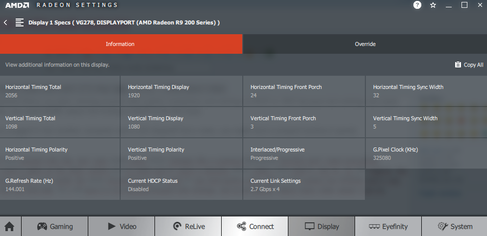

Actually I did mess around with CRU, but I only made some minor changes like a costume Resolution for CSGO and I reset everything afterwards. I tried it again on the other system just to make sure it wasn't a placebo effect when I first tried it, but no, it's still lagging. But to be fair, it isn't really a test under the same circumstances. My main Pc has Amd grafics card, the second system has NVIDIDA and is way older and on the low end side. So I will give it a try messing around with timings, but to be honest I dont't know what values I can try. Maybe you can help me out.
These are the default values.
In case it's really a bad panel, I still have warranty. (bought in September 2017)
Thanks for the help so far.

Small update: I tried different refresh rates between 120 and 144Hz (on "LCD standard" CRU timing values) and I found out that the closer I get to 120Hz, the less it stutters. Using the default blurbusters ufo test, on 125Hz the ufo only stutters like every inch it moves (It's like the ufo skips several frames, like a small teleport). On 144 Hz it stutters way more frequently.

Try using "LCD reduced" and also try lowering the Vertical and Horizontal totals.

I just tried lcd redued on the lowest totals possible and it didn't work that well. The whole picture was ripped.
