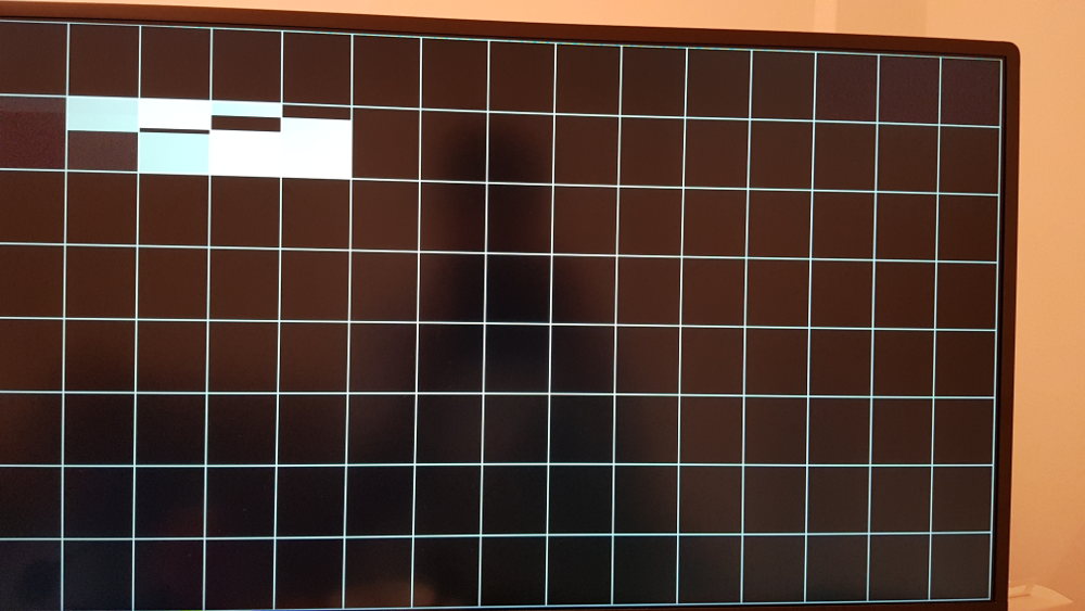

My 4K 60hz monitor has recently started giving me this result on a frame skip test, at stock resolution/refresh rate. I haven't seen it in any examples before and was hoping someone could explain what it means.
To give some background, I originally came across the frame skip test when trying to overclock my monitor. Unfortunately, even a 1hz overclock caused the monitor to frameskip at all resolutions. However, 60hz used to be fine - it gave a perfect result.
Recently, I decided to revisit the frame skip test and am getting this weird result at stock refresh rate. The result is the same across resolutions.
It only displays like this on under 10% of the pictures I take on my phone camera. I have tested my phone camera (galaxy s8+) with other screens and the phone camera is working fine.

Is it just frame tearing? does it happen on other tabs?

Tearing.
This can only be caused by two things:
Computer side:
Browser and compositor VSYNC is disabled (e.g. some Linux installs) -- This can also happen with chrome --disable-gpu-vsync but the fact there is no sync error message, is that your monitor's frame buffer is tearing!
Monitor side:
I've seen this happen monitor-side, but it's ultra-rare when it happens. Usually tearing is GPU side but it can happen to the monitor frame buffer too if there's a bug, failure, or some other weird situation -- like during overclocking.
Probably the latter. Yes, it is very weird when monitor-side tearing happens. That should never happen, but it can happen when things start to bug out (e.g. overclocking).

Thanks both! This is really insightful. :-)
I'm using Windows 10, Chrome. When I get access to the monitor again on Monday, I plan to test it out with my laptop to see if the same issue persists. Will report back.
Assuming that it is a monitor problem, what is the best way to explain this to the warranty rep on the phone? I would imagine saying there is a 'frame buffer problem' is a hard thing to explain to a layman ...
Please bear in mind that I don't overclock the monitor. When I first got it, I tried, but even a 1hz overclock resulted in frame skipping so since then I didn't bother. I've tested it a few times since (without overclocking) and it was fine.

Quick update. The monitor was fine, it was the frame skip test that wasn't working properly.
The monitor had no issues when I connected it to my laptop. Also, the test ran normally in Microsoft Edge and Internet Explorer on the same computer.
So I went to my NVidia control panel and turned on Vsync for Google Chrome. That fixed it.
Just to emphasise, I was not overclocking this monitor since that seemed to confuse (despite being clearly mentioned in every post I made in this thread!)

Yes Chrome vsync being disabled can do the same thing in chrome://flags
Surprising that the frameskip software didn't detect this, it should have. What framerate was it running at? I'll need to improve my TestUFO heuristics to detect these situations.
Glad you figured it out!
For future readers of this thread:
-- Don't use chrome --disable-gpu-vsync
-- Don't disable VSYNC in chrome://flags
