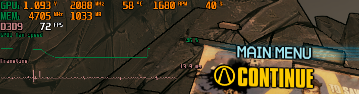

I'm using a Strix 1060 & 29UM69G with the new Nvidia Implementation for Freesync and I'm having problems with tearing and low performance with certain configurations on Borderlands 2.
First configuration is;
  • G-Sync enabled in Fullscreen Exclusive
    G-Sync Indicator
    In-Game FPS Limit set to 72FPS
    NVCP and Game V-Sync Off
I get tearing on the bottom part of the screen and sometimes from the middle down. Now from what I've read G-Sync and Freesync is best/meant to be used with Driver Vsync and game or RTSS FPS limit.

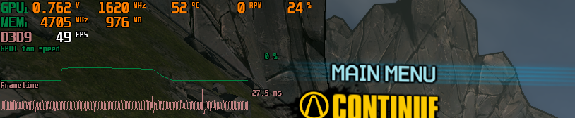

I enabled NVCP V-Sync and I get low performance and high frametime, same when I disable the game FPS limit.
So what's wrong and what can we do about it?

Yup, I know about tearing without V-Sync hence why I tried enabling it but ran into problems. My system can certainly sustain FPS above the VRR Floor easily and when uncapped I can do 100+ FPS, so it's not me dropping down below the VRR Floor.
On the screenshots I attached for example, first one is the configuration I've listed which get's tearing as expected, then the 2nd shot is exactly the same configuration but with NVCP V-Sync enabled, both on the same scene which is the title screen and it doesn't matter if I'm actually in game roaming Sanctuary, it's the same story of low FPS with high Frametime as long as I have NVCP V-Sync enabled, which doesn't make sense.
Just to be clear
  • G-Sync on + Game V-Sync off + Game FPS Cap 72 + NVCP V-Sync Off = Middle and Bottom Tearing as expected
    G-Sync on + Game V-Sync off + Game FPS Cap 72 + NVCP V-Sync On = Low FPS, Low GPU Utilization, and High Frametime
    G-Sync on + Game V-Sync off + Game FPS Cap off + NVCP V-Sync off = High FPS in the 100s, Low Frametime, and Tearing
What I can't figure out is why configuration 2 is having problems. Not using RTSS since the game already has a built-in FPS limiter.

TechnoRush wrote:Not using RTSS since the game already has a built-in FPS limiter.
I know you said you tried G-SYNC + V-SYNC without the in-game limit in your original post, but to rule it out, disable the in-game limiter and use RTSS instead with G-SYNC + V-SYNC.
Also, check to ensure you are using the in-game "Fullscreen" option by clicking "Window Mode" in the options menu, and, if you don't already, you should check the "G-SYNC Indicator" option in the Nvidia control panel under the top menu's "Display" drop-down, just to make sure G-SYNC is enabled in-game.
Finally, you can try a combination of G-SYNC + in-game V-SYNC as well.
This driver implementation of G-SYNC on a FreeSync monitor obviously isn't quite standalone G-SYNC, or even standalone FreeSync, so much of it could be driver teething issues (who knows if the V-SYNC option currently works as frametime compensation like on traditional G-SYNC/FreeSync), especially since your monitor probably isn't officially supported by this new functionality. Bound to be strange behaviors and unforseen issues.
It's possible you're only going to be able to use this feature with partial tearing (your "configuration 1") until this driver functionality matures, and/or official support for more monitors is eventually added.
If that ends up being the case after you've tried everything else, I suggest you go back to using G-SYNC + V-SYNC OFF with a lower FPS limit (try 60 for a start) to leave some room for frametime variances in the upper VRR range and thus prevent more of the visible tearing that the V-SYNC option would have otherwise fixed with a much smaller limit (if it we're working as it does on actual G-Sync monitors).
