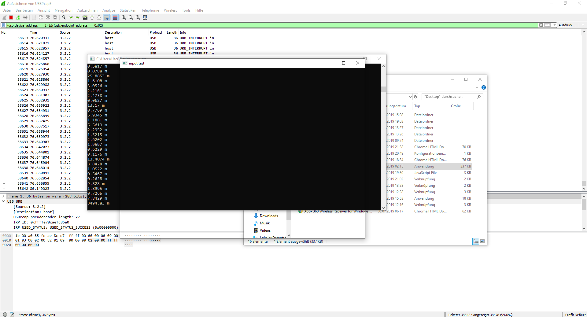

I bump tested the Wooting One (Linear55) against my Logitech G Pro Keyboard (Romer G tactile), using this software: https://github.com/ad8e/input-polling-test. I set the Wooting One on its "Tachyon Mode". I also disabled Xinput but I'm not clear what that affects.
Result: overwhelming victory for Wooting One, 9 - 20 ms advantage. Tried Ctrl vs Alt, then Alt vs Control.
Interpretation: this test sucks, the victory is not reasonable. Bump testing will have unfair advantages for the keyboard with lower actuation force, since the keys are lightweight and fixed force, and the lighter key will give way. This is compared to your finger, which doesn't give way. I expected this problem in advance, and designed another test.
Next test: took an empty toilet paper roll (basically a cardboard tube), flattened it. The goal was to have a long rigid object. Then I rest it on two keys, one from each keyboard, so that it's tall but not wide. Then I press down on the top center of the roll. Hopefully, this depresses both keyboards equally fast. The goal of using a long and narrow connector is to reduce rotational problems for uneven pressing.
Result of toilet paper roll test: this test sucks but it's much better than the bump test. The roll is stiff enough, but it's not long enough. That makes it hard to get an equal force on both keyboards. A longer cardboard object would fix this issue. As my finger inches toward one keyboard, that keyboard gains an advantage. Even so, the Wooting One seems to have 0 - 5 ms advantage over the Logitech.

Re: Wooting One keyboard tested against Logitech G Pro Keybo
Wooting also has a relevant blog post on their website: What influences keyboard input speed
That's part of why I decided to test the Wooting, and the other part was Sunjun Kim's measurements. But Wooting One's manufacturer doesn't make any end-to-end latency claims. Other manufacturers, like Bloody, tend to report (misleadingly) only their very best subsystem with meaningless numbers like 0.2 ms, which is why the measurements must be of the whole chain.
I just realized they referenced Sunjun Kim's article "Impact Activation Improves Rapid Button Pressing", which claims that putting the actuation point at the bottom of the key travel will improve accuracy. That article is not trustworthy: its methodology has a major flaw (participants are blind to key activation mechanism), its timing feedback is poor, and its results are very strange (100 ms windows failing to be accurately pressed). The Wooting One's optional setting to have actuation at the bottom of its key may not improve accuracy at all. Also, because of sensor inaccuracy, sometimes the deepest depression levels cannot be achieved, and the threshold must be set a little bit higher, but this is not a big deal.
Actuation point is normally set near the top anyway on the Wooting, for fast performance.
"In average, the input lag caused by a 60hz monitor will be 8.5ms." -> don't round it like that
Claimed 4.2 ms latency measurement -> that was of beta firmware only. Nobody has been willing to say that it applies to the current firmware.
