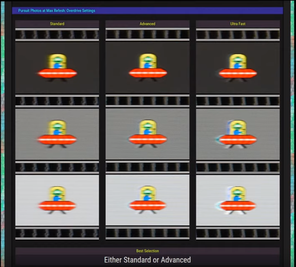

Video review and companion article:
https://www.youtube.com/watch?v=aNDCK6PiChY
http://aperturegrille.com/reviews/ViewSonicXG270QG/
It's 17 minutes long! Sorry!
Blurbusters seems like the right crowd for my type of reviews. The two new ViewSonic monitors, the XG270QG and the XG270, seem pretty impressive, and I picked the XG270QG for review, but maybe I should have gone with XG270 instead. We might need Chief Blur Buster to tune this one as well.
I haven't received much feedback about the reviews, so if you spot anything I'm doing wrong, or there's something I'm missing, let me know.

Wow those are really impressive. I just had enough time to open the website and read things vertically but i really like the review style. My 10sec feed back is that the website may appeal more to the engineery type of guy rather than the general population, but other than that excellent work.
I was trying to read up the Input Lag Waterfall Chart but i was having a hard time interpreting the data (the Y axis isn't labelled). I'll definitively come back and read it again when i have more time.

You're totally right. The website is more of a data dump than a text review. For those who already know what to look for, you can get what you need really quickly.
I covered all the measurement procedures in detail in this previous video:
https://youtu.be/neVQfBy2w2Y?t=851
But it's 22 minutes long... :)
In particular, any of the light measures that don't have y-axis labels are unitless. The microcontroller reads a voltage, typically 0 to 3.3 V, but it outputs a 12-bit integer, 0 to 4095.
As I build out the site more, I want to include explanations for each section. The "About" page has a concise pictograph of the response times, but that's all I have for now.

And Ashun, I like your honesty in including the Pursuit Camera Sync Track, so people can know how accurate your motion blur photography was. Big brownie points for this, not even TFTCentral / PCMonitors / RTings reveals their pursuit-accuracy track.
For Benchmark Image In YouTube Videos: The only thing I might change in your future reviews is to make sure you use ultra-high-resolution montages for these (e.g. 4K) and downconvert for YouTube. It's a bit fuzzy at 1440p as if you created these images at a lower resolution, the scaled fuzziness slightly affects interpretation of motion blur. Just a friendly suggestion! :)
Due to the "Nyquist Factor", the general rule of thumb for custom image inserts into YouTube, is to create a master image approximately twice the resolution of the highest-resolution YouTube format you plan to use. Or at least exact pixel to the video file you plan to upload (e.g. 1440p image for 1440p video). Even 1500p downscaled to 1440p looks much fuzzier than 1440p exact pixel to 1440p.
