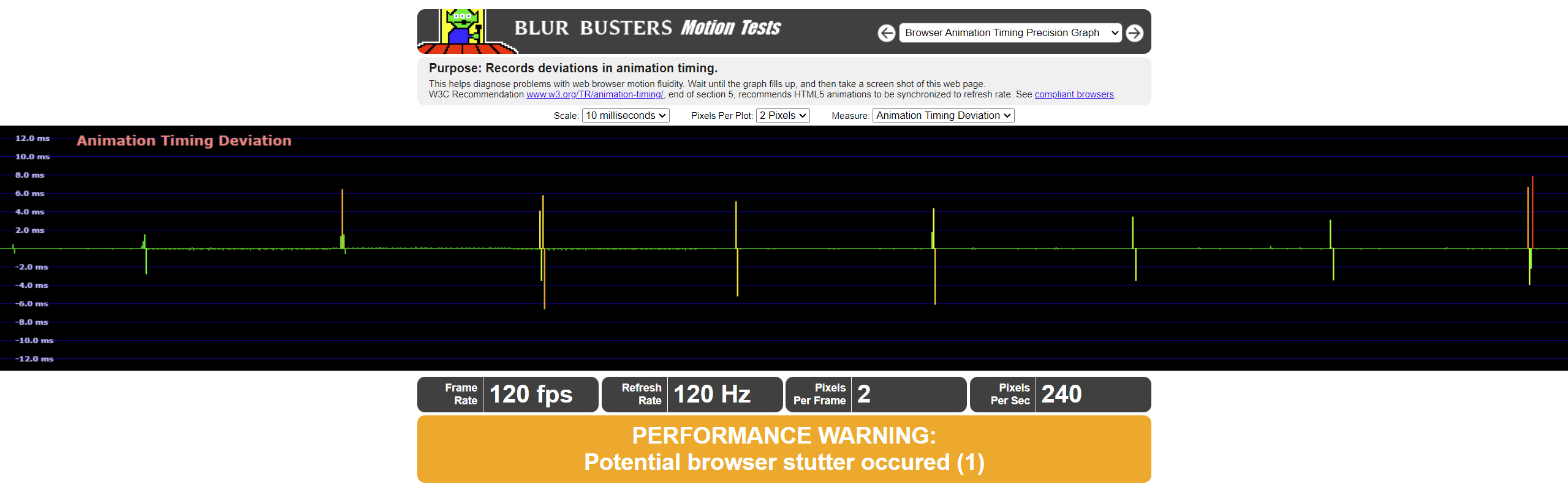

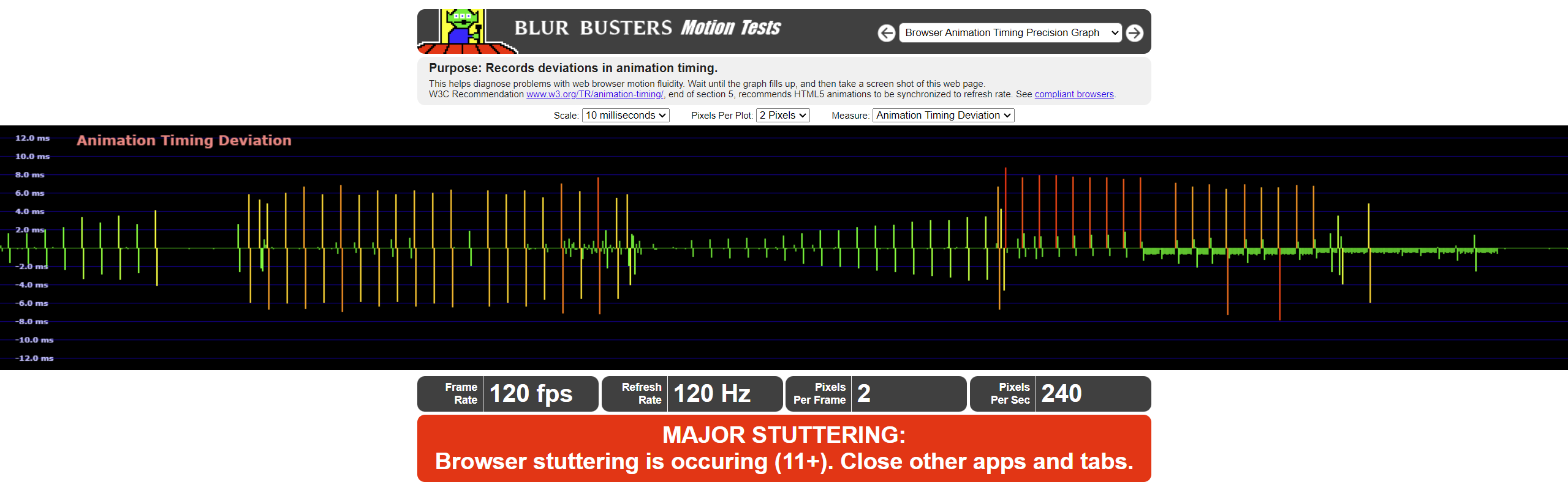

Re: Stutter warnings
Hi Chief Blur Buster,
I'm having the same issue, here's the animation time graph screenshot:
I found what's causing it. I use AIDA64 to monitor temperature of my CPU an GPU by placing the corresponding number in tray. Basically it stutters every second, I guess whenever it reads the info from my hardware. If I disable it, there is no stuttering, but also I don't know the temperature.
I also tried HWiNFO, but then it's even worse:
First of all, the stuttering on the 1st screenshot doesn't look that bad. Which effect does it have on my system?
Second, of course ideally I would like to have no stuttering. Is there a monitoring software which doesn't have such downside?

- Posts: 12302
Temporarily exit all system monitoring software (no Task Manager either!) and see how this graph looks. Monitoring software, apparently sometimes adds stutters, sadly. Ditto for inefficient RGB software, too.
