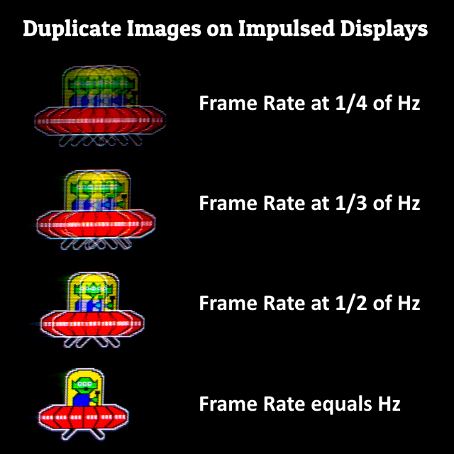

Even with high refresh rates and reprojection, temporal issues remain. 480Hz with strobing and reprojection on 60FPS content for example would be a big improvement over PSVR running at 120Hz with 60FPS content but both systems would exhibit multiple projection artifacts like those shown above.
Ultimately the solution is going to have to be either or both a high framerate input and interpolation/extrapolation.
Without interpolation, if a 60FPS input is fed into a full persistence (un-strobed) 1000Hz VR display with the best depth reprojection and disocclusion filling, camera movement will be essentially artifact free but any non-camera object movement will be stuck with all the artifacts of 60FPS/Hz.
