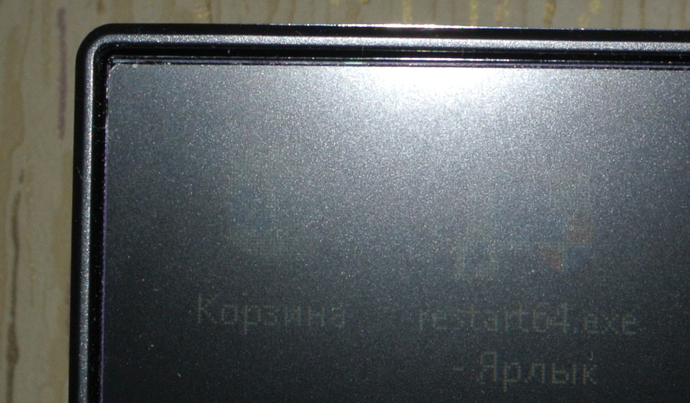

right now every single 240hz IPS from AUO has a light anti-glare coating compared to the medium anti-glare that AUO has on all of their 2nd gen TNs, hopefully they switch the TNs to the same coating as the IPSs.
anti-glare coating can be removed, on the panels of the second generation there is no need to disassemble the panel to do this.

xg2401 will most likely have to be disassembled.
I talked about second generation panels 240 tn. They are of the same design. Anti-glare film is not recessed into the frame of the monitor.
