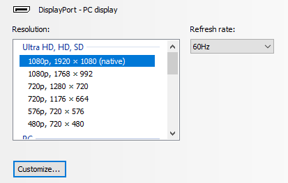

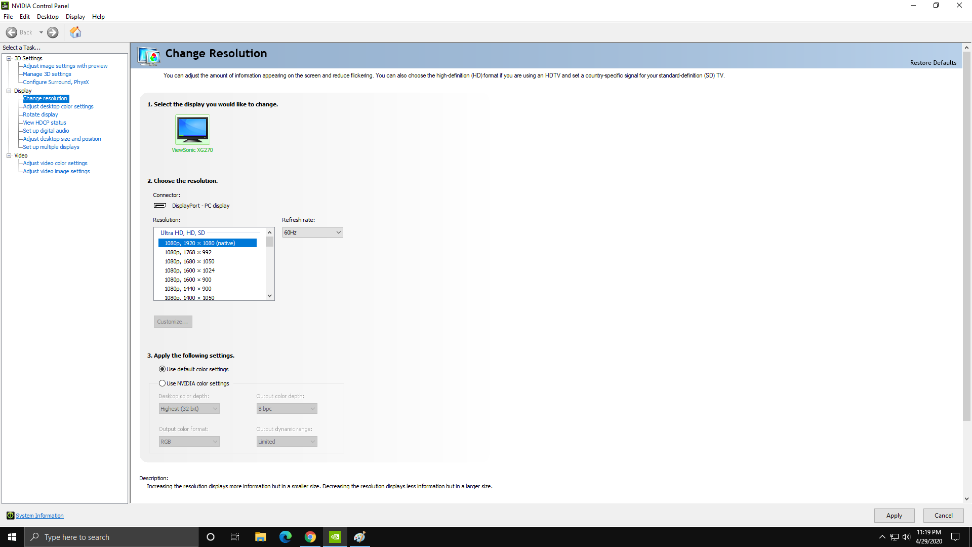

Incorrect native resolution(TV resolution) instead of PC XG2402
Posted: 26 Apr 2020, 19:36
by ko4
Using the latest Nvidia drivers
I'm even using Displayport. These tv resolutions shouldn't even be showing up
Even if i use PC 1080p 144hz resolution, I can still modify sharpness in monitor OSD which should NOT be possible
Already did a clean install using DDU and reinitialized the monitor
Any ideas?

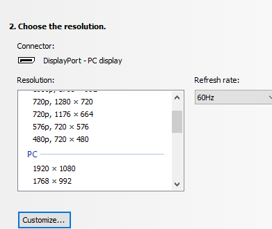

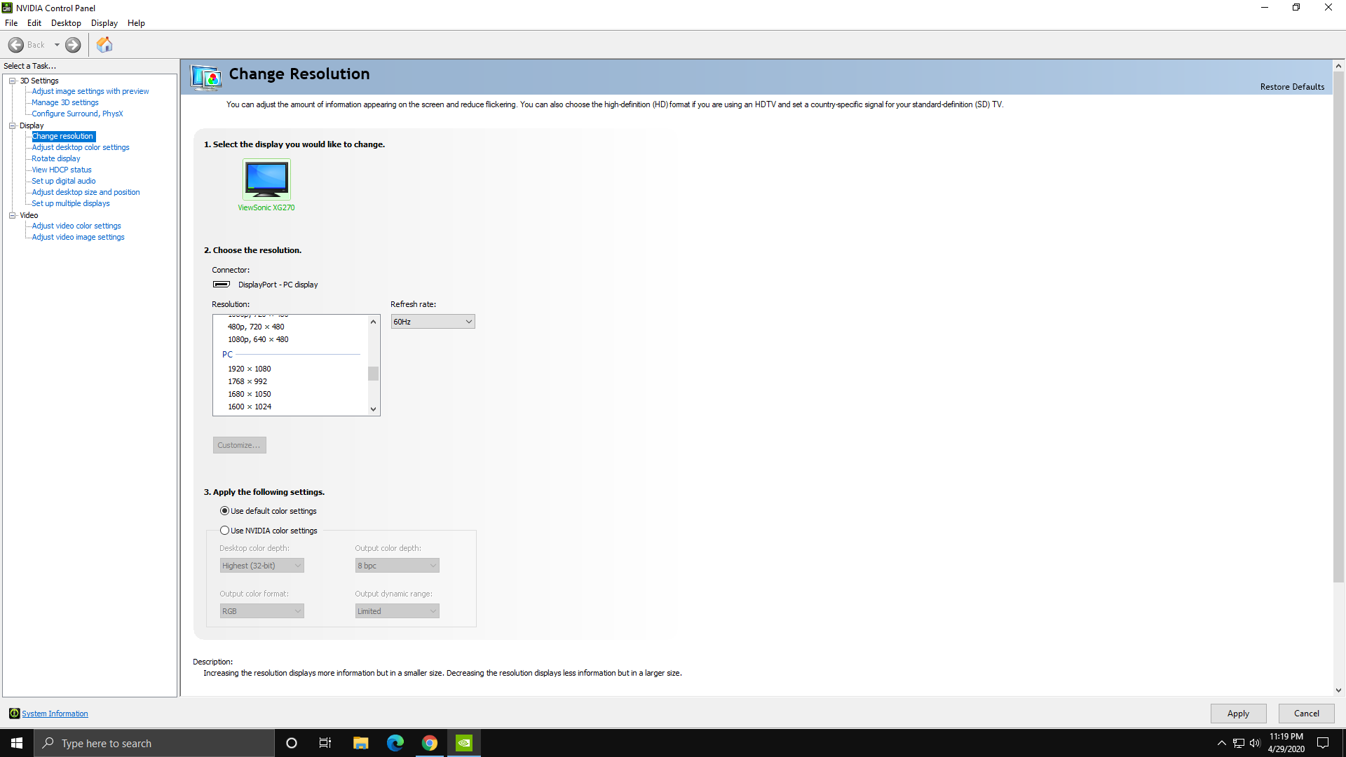

I've tried both HDMI and Displayport. Tv resolutions show up on both. I'm also using high quality cables and tried multiple
factory reset doesnt fix it
144hz does work when i switch to the PC resolution but the sharpness is still adjustable and I know that it should be greyed out instead from what i've read.
Is this something wrong with the nvidia driver or with the monitor?

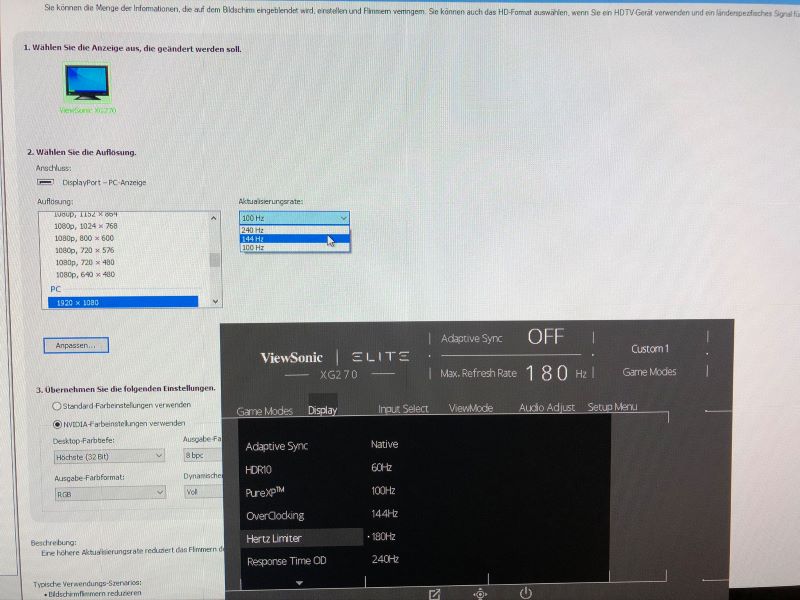

wow i got the same issue with the ViewSonic XG270 Elite
look:
when i change to PC-RESOLUTION screen is not smooth and clear.
I Just have 1920x1080p NOT Native with 240, 144 and 100Hz.
Any Recommendation for a high quality DP Cable?
