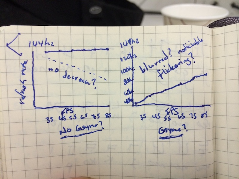

My question in regards to Gsync is the whole refresh matching situation. I made the switch to high refresh rate monitors in April, 2009 with the Samsung RZ2233 and haven't looked back since. Now using Asus' VG278HE. Just the other day I installed some new drivers and my refresh rate kicked back to 60hz until I changed it. Even at the desktop I could notice an immediate change. I thought, hmm lemme just re-live the past, loaded up counterstrike at 60hz, capped at 60fps and still could see much more blurring and overall shittier picture than if I played at 60fps capped at 144hz (not talking microstutter or tearing, just blur and perceived picture quality).
My question is since Gsync matches the refresh rate, if I get 60 fps in some game am I immediately going to feel this same transition I saw when my VG278HE switched to 60hz. Lets use the unreleased ROG Swift as the monitor for example. Since it's not impossible to imagine my frame rate running an avg 60 at most current gen games at 1440p.
I cannot accept that there is simply no difference in 60fps at a set 144hz, and 60fps at 60hz because I immediately could tell the difference in every application I used, 2D or otherwise. It started giving me a headache after a half hour. I just don't want this to be the case with a $800 monitor purchase (in the example of the ROG Swift). I'm certain I can't be the only one here sensitive to lower refresh rates these days.
Thank you, and sorry for the longer post.

OK, so basically, if the frame rate drops to 60fps, the monitor lowers its refresh to 60hz. It won't be like where you're running in 144hz mode with 60 fps. But, imo, there isn't any more input lag and there isn't any more blurring. Also, 60 fps on 144hz will be slightly stuttery, not a fluid frame rate, because 60 is not a multiple of 144.
For example, you can run a 60fps capped game like RAGE in 120hz mode with half refresh rate vsync. But there's no point. it won't look any different, or have any less input lag, than 60hz mode with normal full refresh vsync. It will have less input lag with normal 120hz full refresh vsync, of course, because the frame rate is capped under the refresh, but it'll microstutter sometimes incidently. And for anyone that doesn't believe me, that's the reason that half refresh, 1/3 refresh and quarter refresh vsync modes exist, why else would they if you could just cap at the multiple under your refresh instead? Because it isn't timed precisely enough and it'll judder sometimes.
I do appreciate that even if a game was capped at 30 fps, it was still best to run in 120hz mode with no vsync to diminish tearing, but for me those days are over now with G-sync.
If it's worth mentioning, you can still run in all the modes, ie you can switch g-sync off and run with vsync or no vsync, different refresh rates etc

60fps @ 120Hz versus 60fps @ 60Hz will be very dependant on the monitor's overdrive setting, as monitors use different overdrive settings at 120Hz. So the blur differences can be based on that. (As you say, we are excluding tearing and stuttering here).patrickisfrench wrote:My question in regards to Gsync is the whole refresh matching situation. I made the switch to high refresh rate monitors in April, 2009 with the Samsung RZ2233 and haven't looked back since. Now using Asus' VG278HE. Just the other day I installed some new drivers and my refresh rate kicked back to 60hz until I changed it. Even at the desktop I could notice an immediate change. I thought, hmm lemme just re-live the past, loaded up counterstrike at 60hz, capped at 60fps and still could see much more blurring and overall shittier picture than if I played at 60fps capped at 144hz (not talking microstutter or tearing, just blur and perceived picture quality).
For blurfree/tearfree/stutterfree with VG278HE, test LightBoost + VSYNC ON and removing framerate cap (let VSYNC ON cap the framerate in this situation) and making sure your game always runs at 120fps at all times (stutter free). Not all games can do that, but Source Engine games are able to do so. Unfortunately that creates lag, in exchange for very smooth motion. GSYNC is far better for lag than this, but it's also a route you can take if you're wanting the blurfree experience simultaneously.
