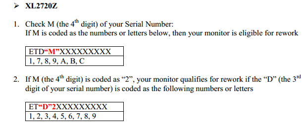

Looks like thread "XL2720z V2 + BB Strobe Utility = Greatest Gaming Monitor!" is not viewed because it's pinned, so I will try to make new thread with 2 questions:
What serial number/mask I should look for to get V2 preinstalled on XL2720Z/2420Z?

c0re wrote:What serial number/mask I should look for to get V2 preinstalled on XL2720Z/2420Z?
info.benq.us has a downloadable Instructions PDF that lists which serial numbers has V1 firmware.
http://info.benq.us/blog/benq-america-c ... -utilities

So in short the best way is to search monitor with fw v2 xl2720z that has 4th sign in serial not "1,2,7,8,9,A,B,C".
I can't order at shop benq, there is no such shop in Russla. I will try to find right serial in local shops.
Posts: 12299
Re: XL2720Z vs XL2420Z
Post by Chief Blur Buster » 03 May 2014, 14:03
That is a reasonable assertation. To be safe, make sure manufacture date is also pretty recent.
I've seen February 2014 units still use old firmware, for example.
