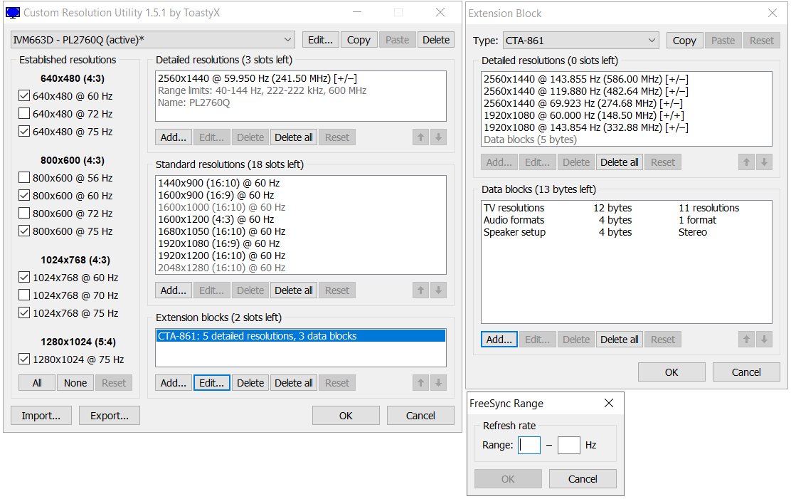

I've tried to raise the lower limit to 55 with no luck:( However, I've noticed that editing a V rate in CRU does not make sense at all for this monitor. For example, I can type some bizzare range like 55-200 or 1-10 and then restart and there is no error. It is possible to raise up to 510 Hz O_o. Or am I doing something wrong? CRU -> Active Display -> Edit -> V rate -> OK -> OK, then restart64.exe.
Actually, the monitor is recognized by the CRU, for example it is possible to raise the actual maximum Hz (overclock) it to 145 or 146 Hz (with image bugs appearing), but the behaviour described above is weird.

Lowering refresh rate might be a way to go. However, there was a blackscreen while staying at 117 fps in a 120 Hz mode.
By the way, the FreeSync entry is missing from the Data blocks. Not sure if it is ok or not. As far as i remember, I've already tried to add it manually, not sure about the numbers though. Here I can also type some strange intervals like 1-250 and the driver accepts it.
