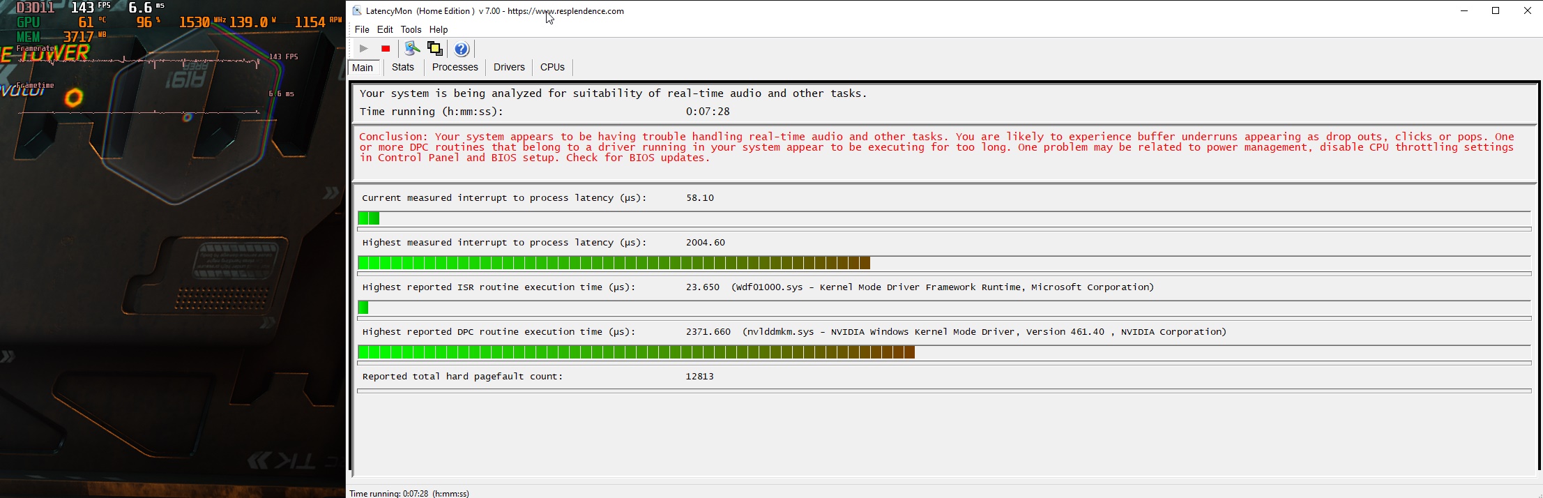

  • high latencymon interrupts
Ghostrunner + latencymon.jpg (339.24 KiB) Viewed 6149 times

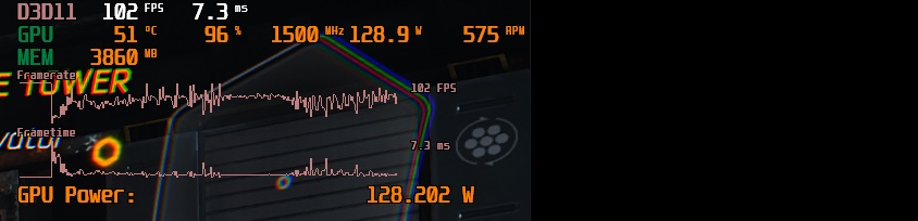

GI - moving map around.png (36.02 KiB) Viewed 6149 times

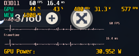

Ghostrunner - level loaded few seconds ago.jpg (48.37 KiB) Viewed 6149 times

Whoa, yea, you weren't kidding. Our situation is really similar. Even your spikes look kind of like mine (basically flat through and through until BAM! you aimed down your sight, lol).
My latencymon also looks exactly like yours! Although, in addition to those two drivers, I'll also get hit bad with storport. I *have* changed affinity for the Nvidia driver, but I honestly think storport is the most telling of them all, if it actually means anything.

I also attached MSI Afterburner frametime graphs. No matter the game it will render inconsistent frames. Played Dyson Sphere Program recently and it renders is very inconsistent too.
