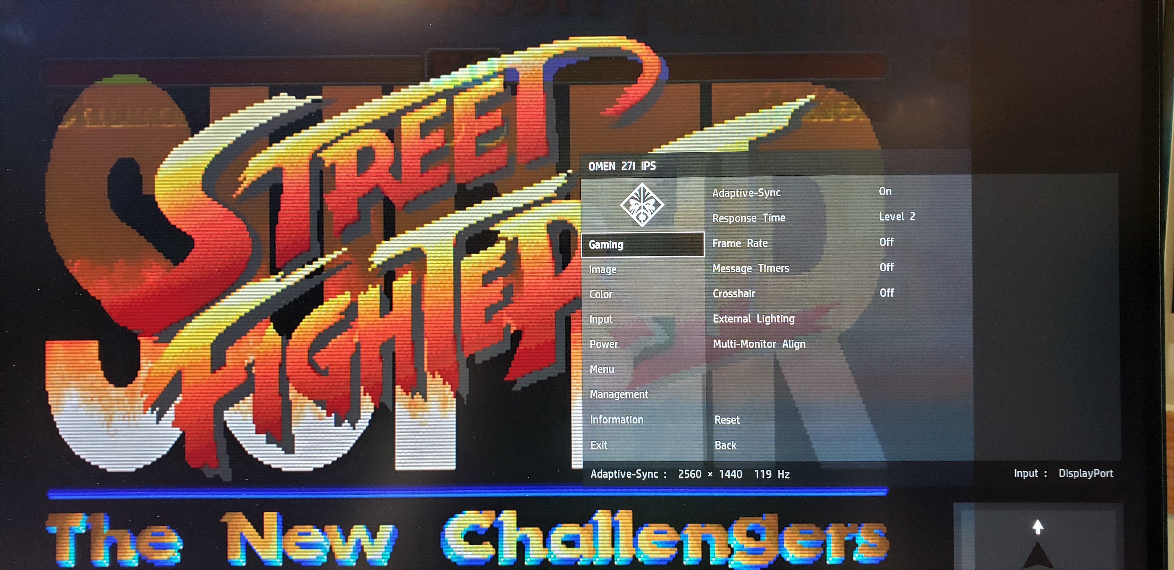

Hello, First post in here. Everybody seems stumped on this. I've narrowed down my problem being directly related to the use of Adaptive Sync\Nvidia Gsync on my Omen 27i 165Hz monitor (set at 120Hz to double 60Hz) in combination with Black Frame Insertion in emulation programs like RetroArch.
The issue is after literally only running a game for minutes, I get what looks like Burn-in left on the monitor for about 20 minutes after playing. I've researched this and found the correct term is 'Image Retention'. This is known to be a temporary effect on some LCD monitors from being on one screen too long. However as I said this happens literally within ONE MINUTE. But it ONLY happens when Adaptive Sync is enabled on my monitor along with Black Frame Insertion. Another strange thing that happens is when I change the response time on my monitor it actually gets BRIGHTER, when normally it does not effect brightness at all. Adaptive Sync works fine in any other game. And when I have Adaptive Sync OFF and Black Frame Insertion ON I also have no Image Retention problems but then of course I get flickering because it's not syncing up with the frames properly.
I'm wondering if this is a known problem or my monitor is possibly faulty. I tend to doubt it since I haven't really noticed any problems other then what I mentioned above. I've attached images to give you an example. Thanks! Any help would be awesome.
- sf2t.jpg (1.55 MiB) Viewed 14932 times
- 20210224_191325[1].jpg (1.88 MiB) Viewed 14932 times

Re: Problem with Adaptive\GSync and Black Frame Insertion
It's a known problem. I also got this when I tried BFI in RetroArch (IPS panel here,) and I've seen other people mention it too.
I don't know if it's dangerous for the panel or not.
Thanks for the response. Found very little info on this in a search. It's a bummer because black frame insertion does pretty much eliminate blur and makes all games look better. Unfortunately the image retention is bad enough that you can see it while playing any game and kind of defeats the purpose of using it.
There is something about the way that BFI is implemented that developers of Adaptive Sync technologies did not anticipate. Or maybe it just isn't compatible with the way these technologies work. I've heard of ways to reduce motion blur even at Native refresh rates but involves the use of technology built-in to certain monitors but mine is only G-Sync compatible and has no such option. Oh well. I can only hope a solution or update happens in the future if enough people make others aware of the problem.
This is the best explanation thread:
Why Image Retention / Burn-In Sometimes Occur On LCDs
I am crossposting it here.
You can make it immune by running an odd-divisor BFI. You need a 180Hz or 300Hz display to do it though. Most 240 Hz monitors can do 180 Hz BFI. Besides, BFI looks better at 180 Hz than at 120 Hz.
Chief Blur Buster wrote: ↑22 Sep 2020, 21:38Image Retention ("Temporary Burn-In")
From Temporary Static Electricity Buildup In Pixels
Flicker patterns such as:
- Emulator black-frame insertion
- 3D-glasses software
- Certain motion tests (including but not just TestUFO's Sync Track)
- Anything that does exactly a half-Hz or quarter-Hz flicker with no dropped frames for a sustained period
Can create temporary LCD image retention. It's a static-electricity behavior when a flicker goes in sync with the positive-negative voltage inversion algorithm, and creates this inversion-related image retention.
This is temporary and you just display video full-screen, or some other thing that really exercise the whole screen -- e.g.
This gets rid of the per-pixel static electricity buildups.
You also get the same problem in anything that flickers pixels in-phase with the positive-negative voltages of the LCD inversion algorithm.
https://www.google.com/search?q=techmind+LCD+inversion
Voltages inverts to try to balance the electricity buildup in the panel, but flicker patterns that go in sync with this, can cause a voltage unbalance = static electricity build up, as an LCD pixels can accidentally behave as capacitors.
The layered nature of an LCD unfortunately creates unavoidable capacitance effects that interfere with operation.
Modern LCDs try to avoid this by using spatial and temporal alternating voltage (positive voltage, then negative voltage, then positive voltage, then negative voltage, and so on)
It's often in a chessboard pattern spatially, which sometimes produces an inversion artifact. Normally this is invisible when the positive voltages are perfectly balanced with negative voltages. But the voltage balancing is not always perfect, so you see this:
However, this is also done temporally -- the voltages swap (like an inverted chessboard) at the next refresh cycle.
Now, if you flicker perfectly (at half Hz), then pixels that gets the "higher voltage" (different brightnesses = different voltages) are always getting negative voltages or always getting positive voltages = static electricity buildup = image retention.
Not all screens use the same inversion pattern / inversion algorithm, so some LCDs don't get image retention easily, while others do. In an ideal world, we would be now using error-diffusion temporal dithering or some randomized dithered inversion algorithm, to be fully immune to all material. But in the real world, the panel makers don't do that, and just settle for simple patterned inversion algorithms which are easier to do at high refresh rates (complex invisible inversion processing can be costly). Historically, this is why inversion patterns often have showed up more commonly on high-Hz monitors -- for example, the early ASUS VG278HE (one of the first-ever 27 inch 144Hz monitors) was particularly known for its chessboard artifact during 3D glasses operation.
- The chessboard artifact is the quirk from spatial component of the inversion algorithm.
- The image retention is the quirk from temporal component of the inversion algorithm.
Thusly, I am not surprised that the world's first panels of a specific refresh rate has some "inversion-related quirks". Every single 240Hz 1ms IPS panel currently has this pixel-as-capacitors quirk at the moment, that only shows up with sustained exact-Hz flicker patterns. As time passes, I'm sure this will improve, with improved inversion algorithms.
Since the pixels have inadvertently behaved like capacitors because of the layered nature of an LCD worked against proper pixel operation. Now you got to drain the charge -- the built-up static electricity stored in the pixel.
Draining the pixel static electricity charge is best done by playing highly active video material. If you want to erase image retention faster, use full screen random-color flashing (fully randomized colors).
HOW TO FIX FIX: Play highly active fullscreen video or animation.
Play pixel fixer software https://www.youtube.com/watch?v=39HUG7QrQi8 (play at 2X speed, it's too slow)
Or simulated analog TV noise https://www.shadertoy.com/view/tdXXRM -- this usually erases image retention faster.
I prefer simulated analog TV noise as a quick burn-in eraser.
Make sure to click the full screen button
While a technology quirk, it is not an RMA defect at all.
Emulator/RetroArch BFI: Use an odd divisible Hz such as 180 Hz or 300 Hz
Doing this techniques is 100% immune to these problems.
If you want to keep using emulator BFI, use the new 180Hz BFI feature now found in some emulators, a 3-cycle flicker pattern never produces image retention on majority of monitors -- RetroArch is building this feature in now.
NOTE: Some old LCDs had inversion-algorithms bugs (firmware bugs or hardware bugs) that caused burn-in even with stationary images, especially at certain picture settings. Also, certain manoevers such as overclocking an LCD may cause inversion algorithms to fail, creating a more image-retention-sensitive LCD. You will immediately know if image retention occurs with stationary images instaed of moving images.
Really great writeup. Thanks! That seems to make sense since I do not experience the screen retention with BFI when GSync is not enabled. Because it needs to be an exact doubling of refresh rate for the issue to occur. I was looking at a 240Hz Display but figured it would overkill. Could still return this monitor even though I love it for everything else... Aargh. Why does technology have to be so complicated.
