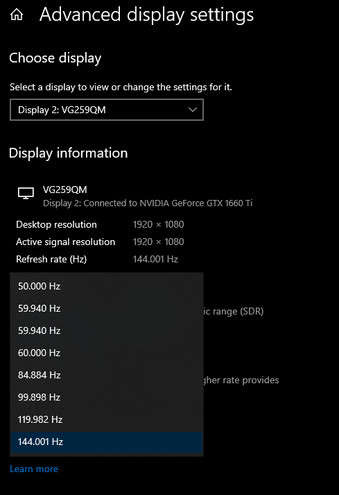

I went into settings - advanced display settings and i can only select 144hz or below. Same in nvidia control panel.

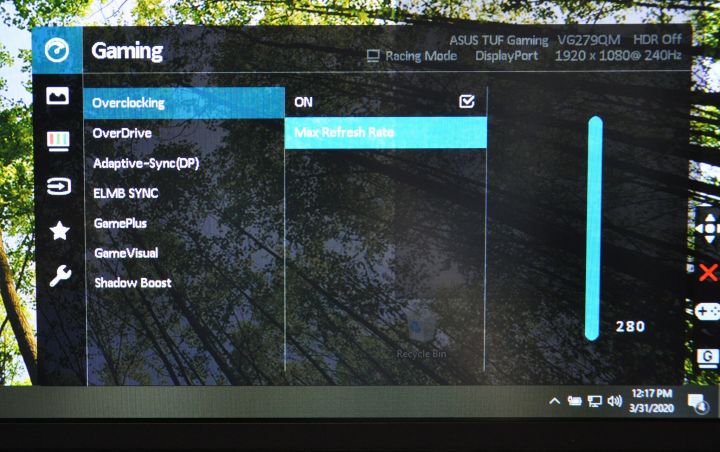

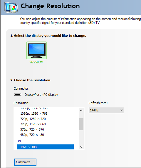

Nope i didn't. Monitor in its OSD has option to overclock refresh rate from 240hz into 270-280hz using displayport cable. I did use it like this for a month. I didn't have to do anything in nvidia cotrol panel. I had options in display advanced settings or nvidia control panel resolutions 144hz - 240hz - 280hz. But now i only have 144, even tho in monitors osd it is shown that is overclocked at 280. In this picture, i used to have racing mode - display port - 1920x1080@280hz now i have racing mode - display port - 1920x1080@144hz
here i had options, below - 144 - 240 - 280
now only 144 or below
same here
