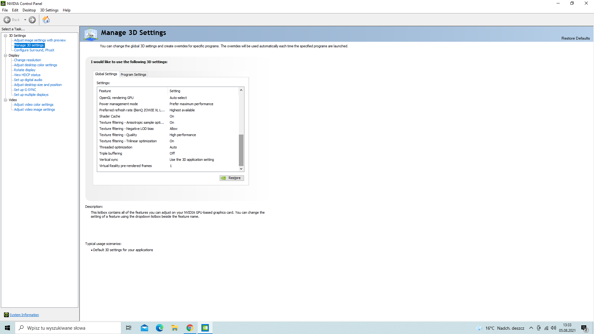

You may have configured VSYNC OFF in the graphics drivers for full screen mode.
If you are using NVIDIA Control Panel, switch it back to "Application Controlled" for the vsync technology for full screen mode.

by bajdzik
I don't know if I'm doing it right, but I'm posting a picture. I changed from OFF to Use the 3D application settings and no change.
I would also like to add that my gameplay is not smooth, I mean it's better than before but it's still not that. When I see povs of people who have the monitor shown, everything is so smooth for them and for me it's kind of weird, rough. My graphics card is rtx 2070super gaming x trio, in cs go I get 300-400 fps and I play on low resolution because 1280x960 on low settings so it should work well but it is mediocre.
What should I do in this case?
