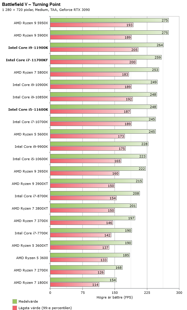

Part of the reason you're seeing CPU-limitation with a 3080ti is because you're only running the game at 2560x1440, and the 3080 Ti is more suited to a 4k resolution. Basically, in certain games, your resolution may be preventing your system from taking full advantage of the GPU's power.biggydeen wrote: ↑09 Aug 2021, 03:44So I was thinking with an 5800x and 3080ti I must be able to get that steady 140 fps in most games with high-ultra settings. And most of the times this is the case only in Battlefield games I instantly notice stutter when the FPS is not steady.
Maybe it's just the frostbite engine + heavy CPU load. Battlefield games are very CPU heavy and do not utilize the GPU that much. My 3080ti is sitting at 50% usage max but some CPU cores are running 100% all the time.
Have you tried increasing the "Resolution Scale" above 100% in the Battlefield advanced video options? It should take some of the strain off the CPU and make the GPU work harder, potentially lowering the CPU usage and increasing the GPU usage in those scenarios.
