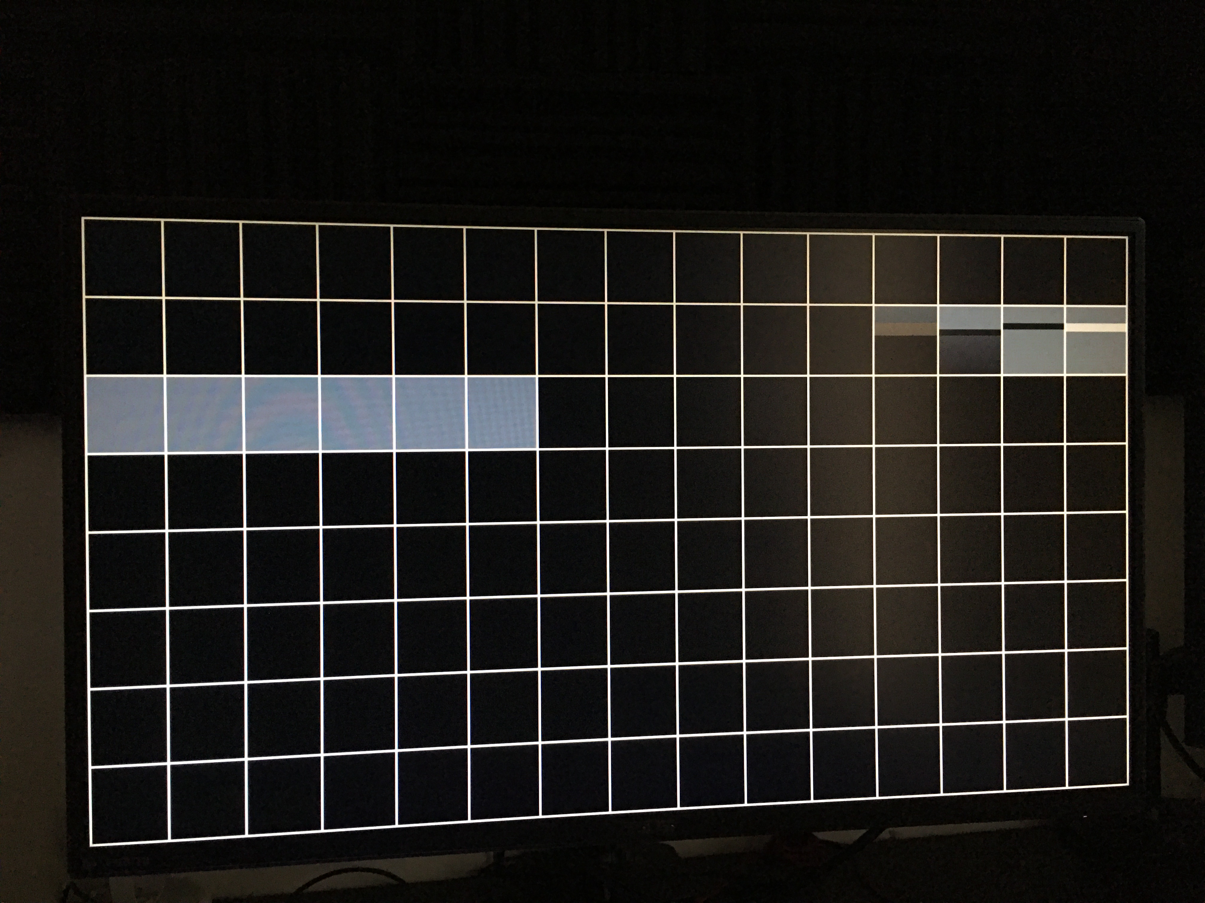

What causes this effect in the Frame Skipping Test?
Ynot_iwal
Posts: 7
Joined: 03 Jul 2021, 04:41
Post by Ynot_iwal » 06 Aug 2021, 16:09

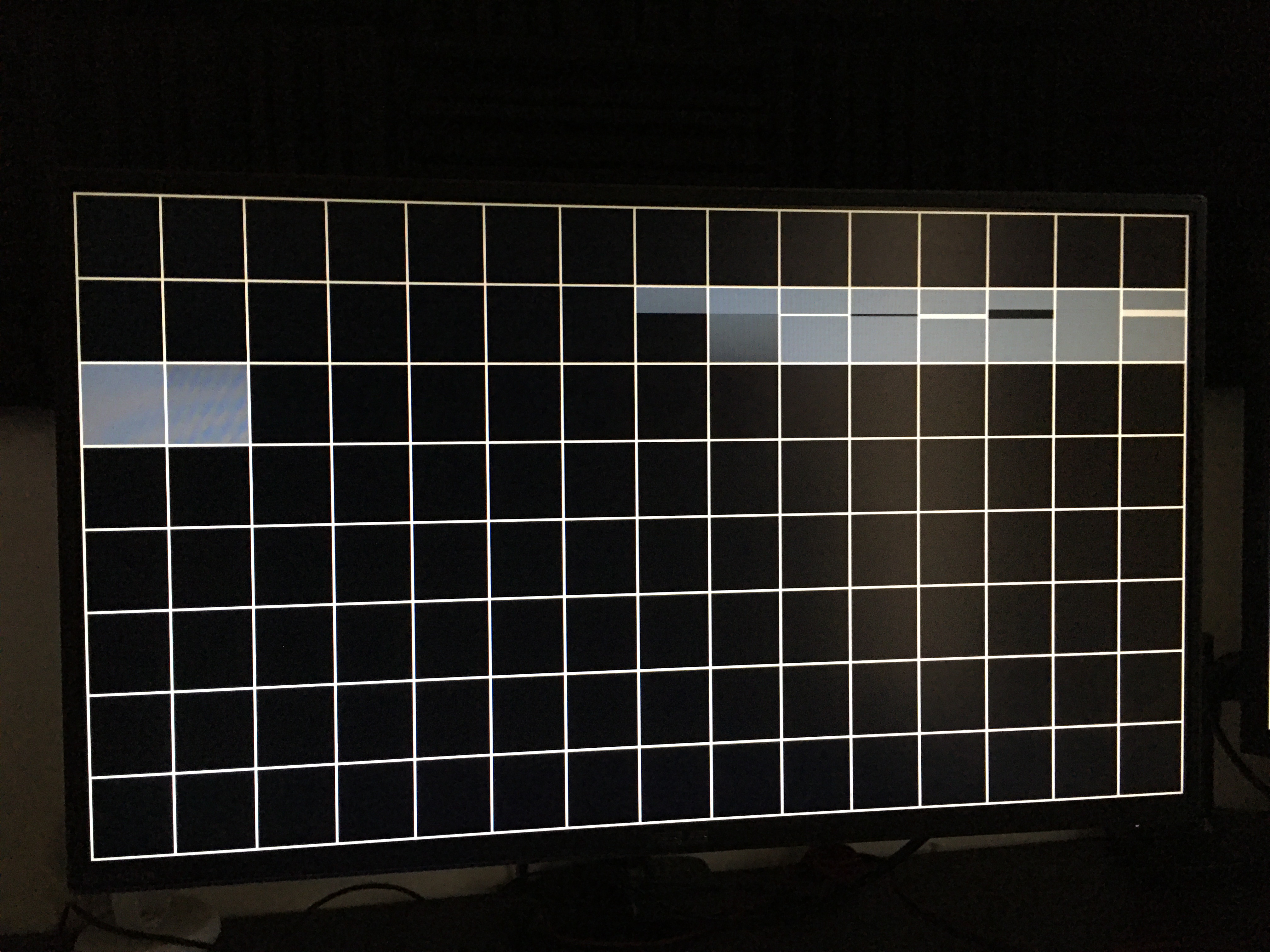

As the title says, what is the cause of this artifact and is it anything to be concerned about? I'm currently on a frustrating quest to solve a motion clarity (via "stuttery"/apparent low FPS, not motion blur) issue on my new system. I believe this could be linked.
Posts: 12284
Re: What causes this effect in the Frame Skipping Test?
Post by Chief Blur Buster » 06 Aug 2021, 21:21
NVIDIA Control Panel -> VSYNC -> change to “Application controlled” instead of VSYNC OFF.
The browser full screen mode uses this setting.
