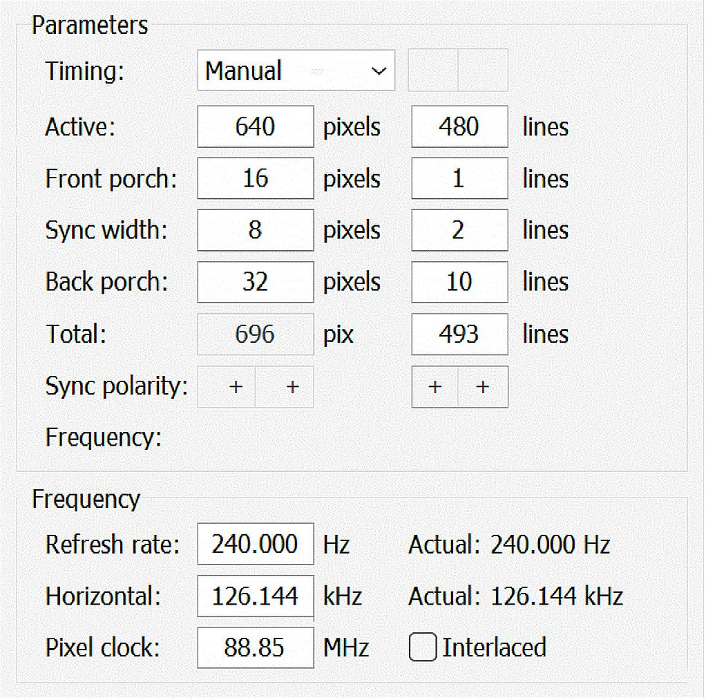

Download, install and run ToastyX from www.monitortests.com then click "Add" to begin creating a new custom resolution.
Important: Unless intentional, it is best to disable VRR (FreeSync, G-SYNC) both in your monitor's OSD and on your computer side, before beginning to do these tweaks.
The easiest steps are to use ToastyX and derive from a WORKING mode.
1. Start with working max-Hz mode
On most modern panels, the existing default max-Hz mode built into monitor's EDID will work.
2. Switch to Manual
3. Put First Radio Button on "Total"
4. Put Second Radio Button on "Horizontal" (or "Pixel Clock")
Now you can choose a custom large vertical total by increasing the Vertical Total to lower your Hz to target Hz
Your horizontal scan rate and pixel clock will stay unchanged as you transfer bandwidth from Hz to Vertical Total
You're still transmitting the same number of pixel rows per second over the cable, just fewer visible pixel rows, and more offscreen blanking interval pixel rows). The net result is that the visible pixel rows are always transmitted from GPU to monitor at full velocity at monitor's max-Hz velocity despite having a lower fixed Hz refresh rate
5. Example1: Double Vertical Total to Halve Hz (2x QFT at half Hz)
This example transmits a 8.3ms(1/120sec) refresh cycle in only 4.2ms(1/240sec) resulting in 4.2ms lag saving for bottom screen edge
This will transmit the refresh cycle over the video cable at 2x its normal low-Hz velocity
Do not edit any other numbers, do not edit Hz, only edit Vertical Total, the refresh rate will be calculated automatically
6. Example2: Quadruple Vertical Total to Quarter Hz (4x QFT at quarter Hz)
This example transmits a 16.7ms(1/60sec) refresh cycle in only 4.2ms(1/240sec) resulting in 12.9ms lag saving for bottom screen edge
This will transmit the refresh cycle over the video cable at 4x its normal low-Hz velocity
Once you create your custom mode, reboot your computer (or run ToastyX restart64.exe to reboot your GPU without needing to reboot Windows). Test your custom mode. Verify your new Vertical Total shows up in Strobe Utility too. If it works, repeat the DIY strobe tuning steps above to get your reduced strobe crosstalk & low lag.
For intermediate refresh rates, calculate the vertical total using this formula:
Desired Vertical Total = (Original Vertical Total) x (Original Hz) / (Destination Hz)

More VBI time to hide LCD GtG pixel response between refresh cycles results in a much taller zero-crosstalk zone (as an additional benefit above-and-beyond latency reductions). As long as you're doing framerate=Hz, you can get much more perfect CRT motion clarity:
