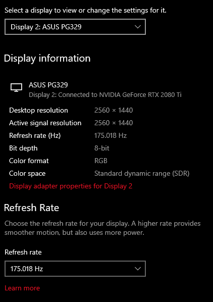

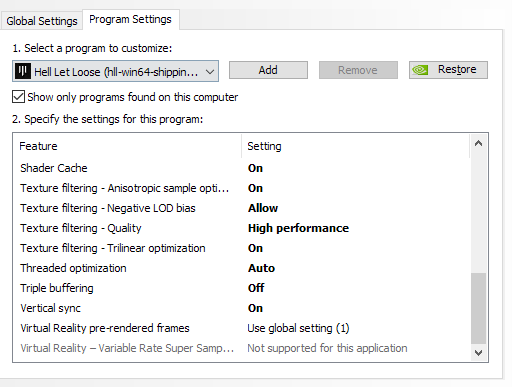

I run the game on relatively lower settings anyway, i was hoping that this can be improved from software settings, as i run a Rog Strix 2080ti and i believe there arent massive gains to be had from the new cards over the card i have already. I was kinda hoping a pointer towards perhaps turning off the likes of G-Sync off and going with forced refresh rate may have been advisable as an alternative way forward.
Few additional images:

Going by your info and screens, there's nothing to worry about regarding the render latency you're seeing. Those are very low levels. I also wouldn't rely solely on such readouts. They only show you a small part of the overall latency chain, and can be subject to some interpretation.
