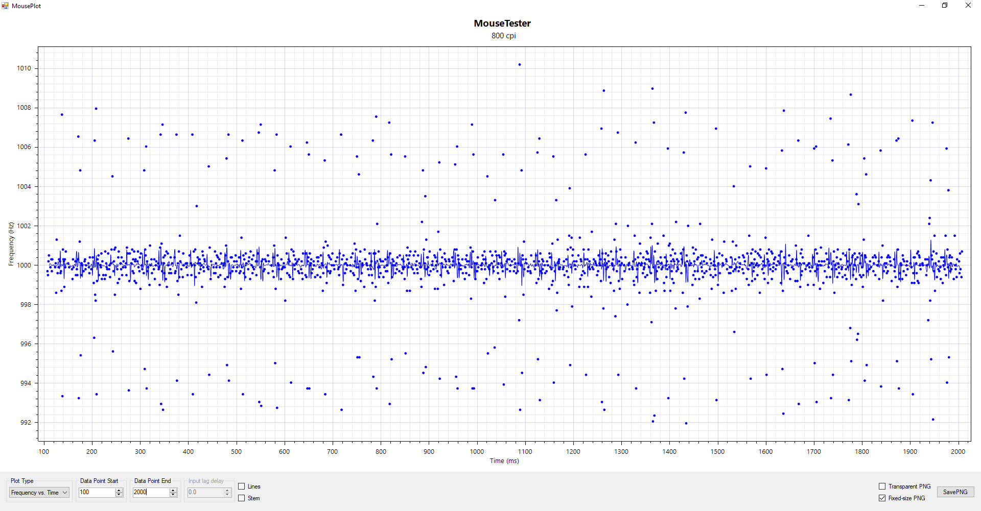

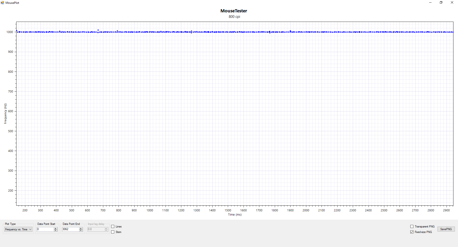

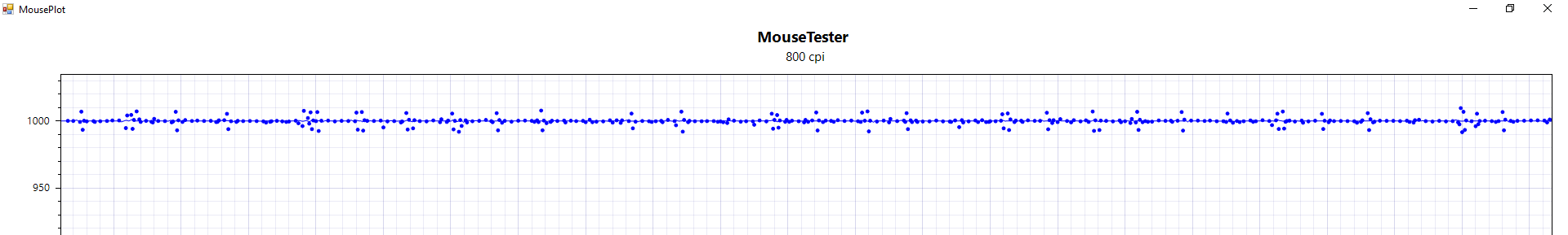

In General, I get a strange behavior of the mouse when the driver graphics card on ( screen 1 and 2), sometimes after a reboot I get a smooth graph as usual (picture 3) that, try:
disable MSI mod, remove affinity from the card and the controller, change the drivers etc, nothing helps, after I turn off the graphics card everything becomes OK

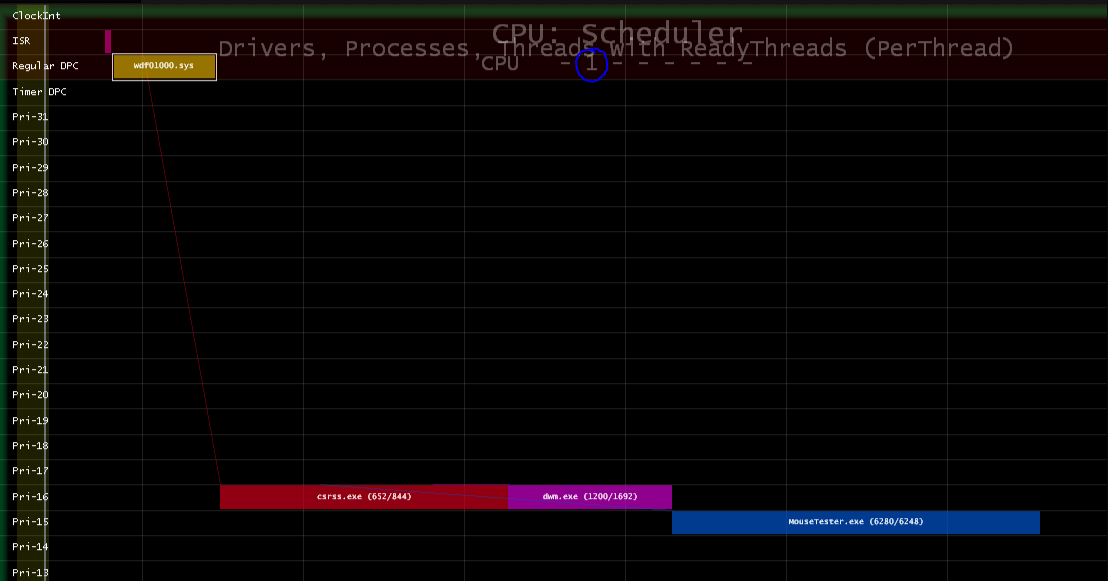

Screenshot of window scheduler as it relates to mousetester from start to end, process duration by thread priority. (doesn't show call stacks/ready stacks ofc) Keep in mind this is microseconds view as data passes from driver to mousetester.

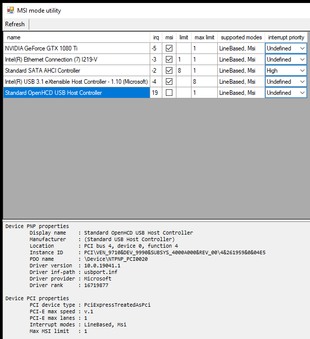

im use pci-e usb 2.0 controller, he is not have msi mode, but i put my mouse in motherboard controller and give me same result

Is the first pic bad? Is this some kind of joke? I don’t understand at all how you can do this on windows 10. It’s perfect.

yes, it's 10, and in the first screenshot the "perfect launch", otherwise the graph looks like in the 1st and 2nd picture.
I apparently found the reason and it's DWM.

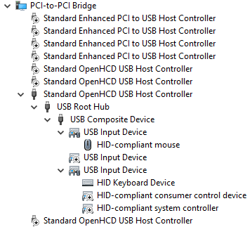

Sometimes it's packet congestion between the multiple USB devices on the same USB host chip.
Imagine USB like an Internet connection, except jitter at the smaller timescales (often in hundreds of microseconds). Imagine "USB Root" like an ISP, with everything below sharing the bandwidth. Now imagine ping jitter of all the competing USB bandwidth users.
Try purchasing and installing PCI Express USB card just only for your mouse and see what happens too. You want a try a dedicated USB host chip for your mouse, preferably with a dedicated PCIe lane separate from everything else (ideally), for purest possible USB mouse operation -- literally a dedicated connection just for your mouse!
But yes, EMI can be an issue as USB does error correction when strong over-the-air interference causes packet loss on a USB cable -- like a nearby transformer cycling on/off near the USB cable. Just like an Internet connection, USB cables are packetized, and there can be packet loss on USB cables with sufficiently strong interference near the cable. USB cables often dangles into a mess of power wires and power bricks behind the desk, a hornet's nest of potential possible EMI. The mouse's built in USB implementation just simply retransmits the packet associated with a poll (late/jittered) until the USB host acknowledges the packet.
While inexperienced people troubleshooting EMI sometimes sometimes resembles a sect, EMI itself is a real problem, all covered by real science. For the easy-to-read stuff, see Electronics Notes Science to understand the real, hard, brutal science behind interference. For the more complex-to-read summaries, see science papers heavily covering EMI affecting computers, such as Institute of Electrical and Electronics Engineers (IEEE).
But first, try to solve your USB jitter/congestion by having a dedicated USB host chip just only for your high-Hz mouse (nothing else in the same USB host tree in Device Manager). A dedicated root hub just only for your mouse. You can try playing USB roulette (external hub plugged onto a distant motherboard USB port for your other USB devices on a different USB host chip), keeping your motherboard USB ports empty except for the mouse. Could be the front panel, could be the separate cluster of USB2 ports versus USB3 ports, could be the USB-C port (use USB-C to USB-A adaptor), etc. They may be grouped to their own dedicated USB chip logic.
