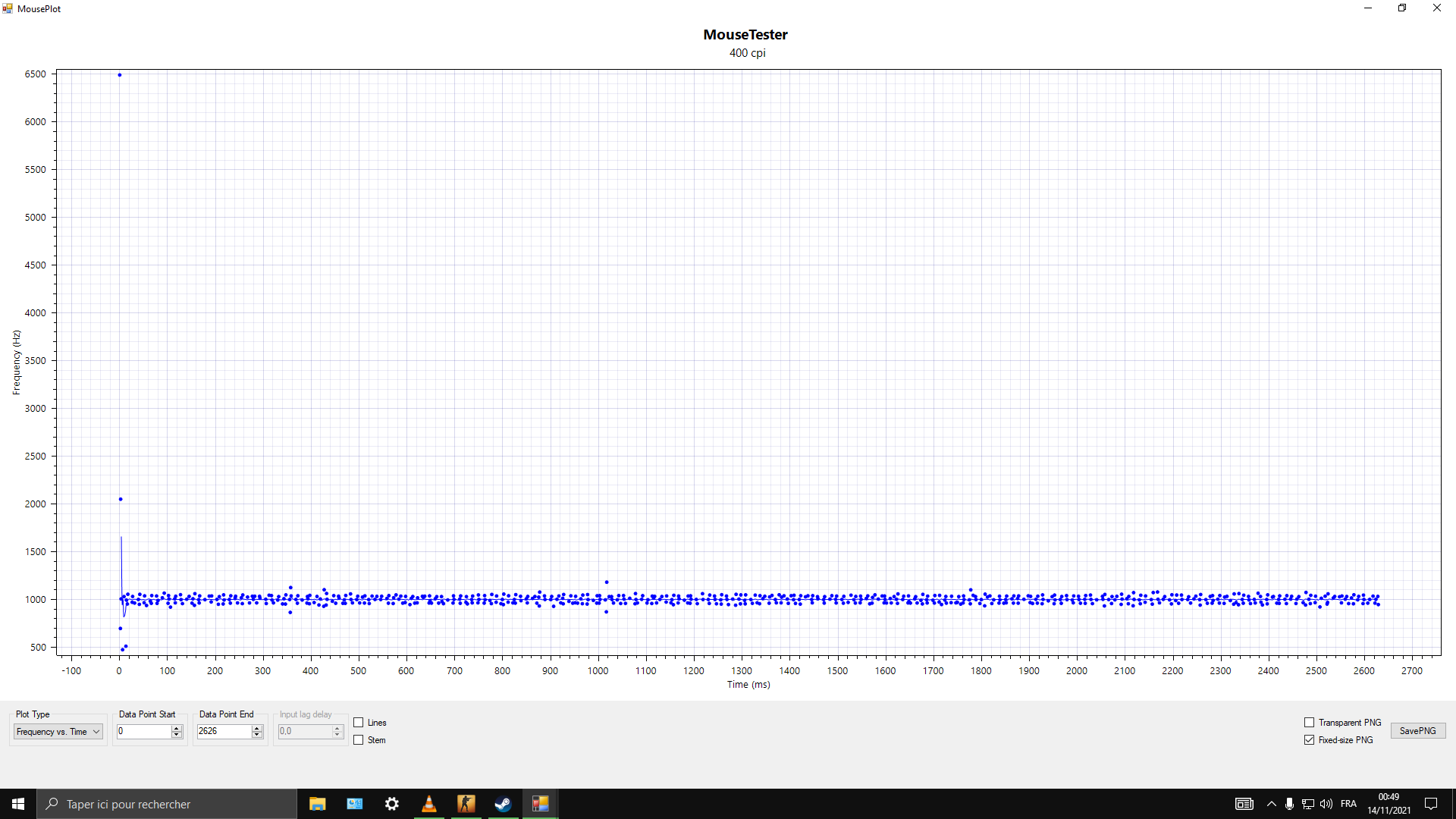

omeGa
- Posts: 5
- Joined: 13 Nov 2021, 19:05
Re: ELECTRICITY INPUT LAG.. HOW I FIXED IT?!
Oh my God I love you brother !!!!!
thanks to you I managed to locate my problem and it's electrical :'(
It's been more than 2 years that I have a problem in Counter Strike with a floating mouse feeling and my hits registering very very very badly and space preshots
I'm one step ahead of your post because I had proceeded by elimination:
My hardware : ok
my network : ok
I only had the electrical network at home, I have a very good grounding so no problem on that side.
So I proceeded as you have specified to cut all the circuit breakers and leave the one for the power outlets and it is INCREDIBLE !!!!!!! my game is a speed, precision that I do not recognize
o
In the Mousetester software my smile is smooth, a perfectly straight line while before it was a roller coaster, look at this screenshot.
I am in a state of euphoria to have finally detected the problem.
I've already contacted some friends who know electricians and I hope the bill won't be too high.
Thanks again brother, your report is a gift.
