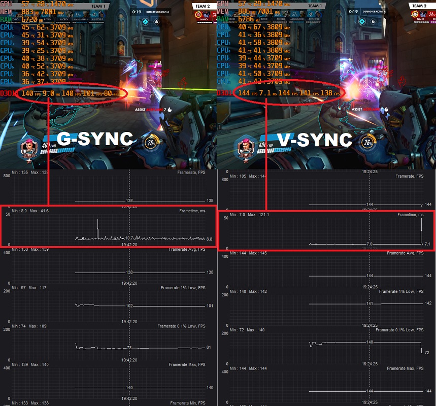

So I'm experimenting with getting smooth game play visuals and frame-times. V-sync works well for all this but frame rates must keep up with the refresh rate and that's a problem for this PC. So instead I capped the frame rate (in-game) to the highest stable one and enabled G-sync hoping for a similar result. This revealed massive frame drops and inconsistent frame times. Likewise with G-sync off. Yet the PC maintains the same frame rate with V-sync. Soo is V-sync uniquely stable of did I get something wrong. It would be advantageous if G-sync could get stable frame times. Results below if interested, regards.
- ow_fps.jpg (280.7 KiB) Viewed 14457 times

Thanks, I see now that the frame rate inconsistencies are not a concern. I guess V-sync is more "stable" because the PC only worries about drawing 1 frame per refresh cycle whereas G-sync draws all the frames it can, both longer and shorter (hence the frame dips). In the end they average the same frame rate, input lag (?) and "game time to photon time". xcept one is consistent and one sporadic. If I didn't get that right let me know!

Edit: I had to read the G-sync preview https://blurbusters.com/gsync/preview/ to better understand how G-sync works. The "glass-floor" frame time scenario I wanted is unnecessary since, although G-sync frames are sporadic, they are time-corrected by the game engine and all is well...
As most game engines adjusts object positions based on the current instantaneous frame rate, object positions are already compensated for momentary early/late presentation of frames. That makes it possible for random frame rates to remain miraculously smooth!
