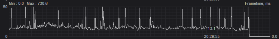

Sure. I just played around 1 hour just to make the graphs and post them. Here they are, the LOG (I think u have to have MSI afterburner to open it) and a screenshot. I don't know why (I think last night I changed GPU drivers but didn't have time to test them) but the game was better. I still get stuttering, but less, or I was paying less attention.
HERE is the complete graph to download (it has CPU usage, GPU usage and stuff).

Excellent -- this answers a lot of my questions. What you have is an erratic form of frametime spikes, which eliminates a lot of known cyclic causes.
It also doesn't look like it's caused by CPU spikes in RGB-animator software (e.g. inefficient keyboard blinkenlight animator software -- extra software driving that is sometimes culprit of frametime spikes on some systems)
It doesn't look like a thermal throttling behaviour, but you can always also test a 10% underclock at least to re-verify.
It doesn't look like a network-derived behavior (AFAIK)
It *could* be texturestreaming behaviour, where the GPU is loading new graphics from disk in realtime.
- Shader compiler (try reducing shader detail settings to reduce shader compiler overhead spikes)
- Texturestreaming/asset loader (use fast NVMe SSD, not SATA SSD).
Tiny stutters that are hidden by 60Hz, can be made visible by 144Hz. You may want to do an additional test of configuring 60Hz and FreeSync disabled and see what the graphs look like there instead.
Please try my FreeSync recommendations and prevent your framerate from exceeding Hz, to keep your framerates inside your VRR range, to prevent stutterfeel/lagfeel effects (caused by fps<Hz versus fps>Hz transitions) -- better VRR feel requires framerate ranges completely inside VRR range. Ugly VRR stutter/lag effects can sometimes happen from those framerate-vs-Hz transitions, and you need to control those for beautiful VRR oepration.

I took every advice, and still I can't play smooth. Here's my graphs forcing Vsync ON in drivers, forcing Vsync OFF in game, and Freesync On. And I installed 3 moths old drivers (Recommended WHQL) that should be the most stable, and yet... can't play on ultra
I don't know how you read the graph too see what happens, but I guess it reflects the stuttering I see.

Those are really nasty frametime spikes that should not need to exist. Near-perfect 50ms frametime spikes? That's full micro-freezes of 1/20sec. That's a full 3 dropped frames at 60Hz, and 8+ dropped frames at 165Hz. That undoubtedly creates an awful experience. There is a clear issue somewhere, that I'm not yet 100% convinced is monitor related.
Have you tried a complete uninstall of all graphics drivers, and reinstall with clean, fresh settings?
Have you perhaps tried a Windows reinstall?
If you have access to a friend's or ability to bring your computer to a computer store (to temporarily test demo monitors there) -- try a 2nd VRR display of a dramatically different brand too. At least to see if any of those fixes microstutters. If none works, then it possibly might be a Radeon-related problem (specimen hopefully). In that case, try testing a different card (AMD or NVIDIA). I've seen it card-side, not just monitor-side. You could even sell your Radeon at a slight profit now, wait two months, and get an even more powerful NVIDIA card for the money you got. GPU prices are currently declining.
Unfortunately, a little more pain of testing is needed. Clean Windows install. Extra monitors and extra GPUs.
Those frametime spikes are not normal -- not even for things like texturestreaming or shader recompiles. Those things don't spike that strongly on modern GPUs.
Let's focus on that specific level in that specific game that creates approximately 10-20+ frametime spikes (to 50ms), for closer diagnosis.

[capture a 4th graph]
I'd like to compare all 4 graphs, to see if there are some nasty/buggy interactions between the various sync technologies.
The most important thing is we need to stick to 1 game with 1 level that has the most clear microstuttering behaviour -- the graph you just captured is a perfect test to repeat everytime you change settings or hardware/etc. I'm almost certain it is not the monitor, but I would love to at least confirm (with a different VRR monitor). I feel 90% the problem is somewhere else, but we need to do more testing...
(Ideally would like you to also repeat the above once reinstalling windows too, or with a different GPU, or with a different monitor too, but I can settle for just the first 4 new graphs). If you have an old computer tower, move your Radeon into that temporarily, and test it too (might be faster and easier than reinstalling Windows if you've got a working tower handy. You might get a lower frame rate, but at least the frametime spike behavior may be totally different -- this might reveal a motherboard problem (changing slots on the motherboard might also help too -- if there's an issue with the graphics card slot).

Chief Blur Buster wrote:
14 Apr 2022, 13:00
If you can't access extra equipment, can you run exactly the same game in exactly the same locations.
1. Confirm you can reproduce similar frametime spikes.
[repeat capture the frametime graph just like above]
2. Once confirmed, restart the level and see if frametime spikes happen again. (This tests caching; if frametime spikes stops)
[capture a 2nd graph]
3. Now repeat the game (fresh restart), with VRR kept on but turn VSYNC OFF in your GPU control panel instead of VSYNC ON combined with VRR
[capture a 3rd graph]
4. Now repeat the game (fresh restart), with VRR turned off on both the monitor and the GPU, and VSYNC OFF in both the GPU control panel and in-game menu
