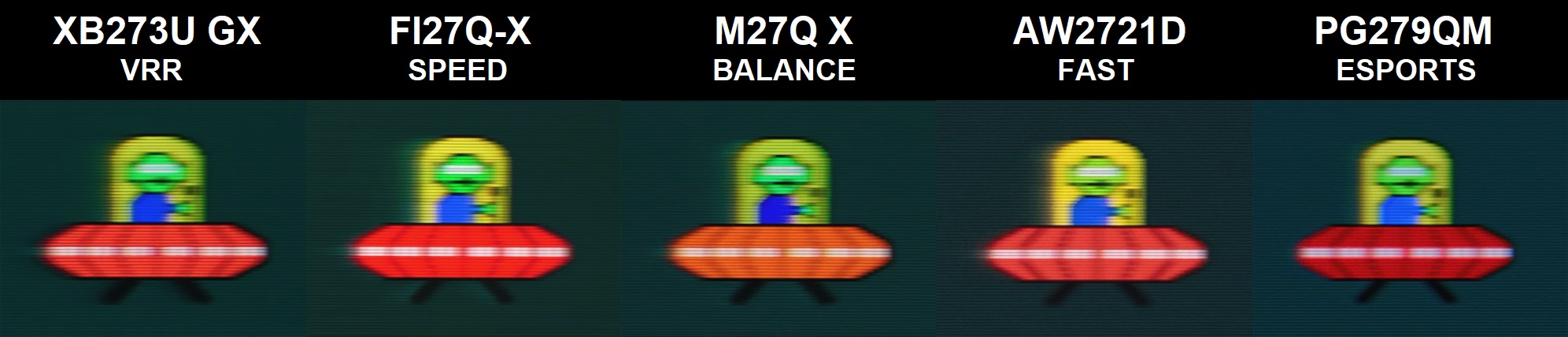

960pps, Aim Stabilizer at 240Hz with OD Balance, and at 144Hz with OD P.Quality, at middle screen?
Gigabyte M27Q X.jpg (430.99 KiB) Viewed 27526 times
Hardware Unboxed
∼960pps, max Hz, dark cyan row (top row)
XB273U GX vs FI27Q-X vs M27Q X vs AW2721D vs PG279QM.jpg (186.64 KiB) Viewed 27501 times
XB273U GX, FI27Q-X and M27Q X from Hardware Unboxed, AW2721D Techless, PG279QM Optimum Tech
