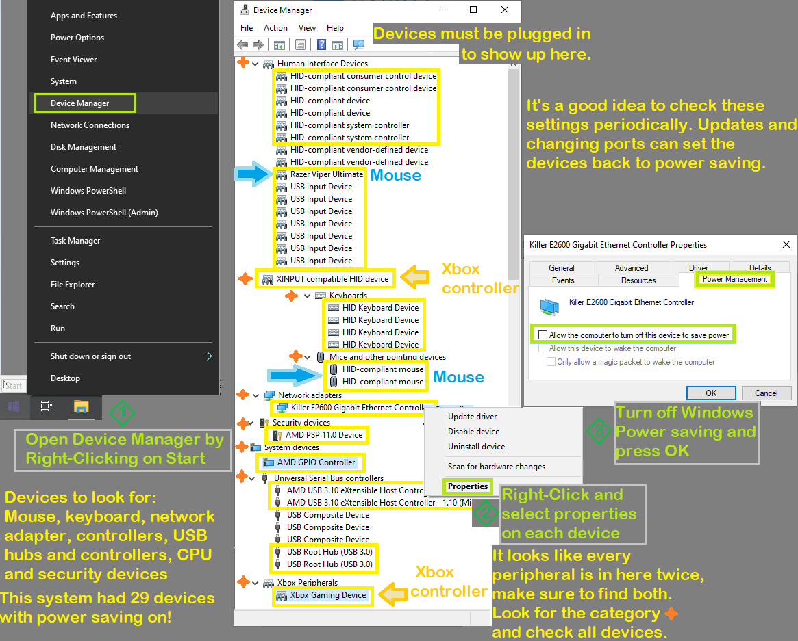

Have you combed through Device Manager to make sure power saving is disabled for every device? There is a security feature in the AMD chip that has power-saving on by default. download/file.php?id=3095

Oh yeah, one consideration I forgot to mention:
Have you made sure your power cables are routed seperately from all the other cables such as your mouse?

If you guys find an easier solution, just share.
Off topic.
Have a new YouTube channel: ' HiddenTweaks ' , would appreciate you guys following me there.
Anyways hope this works!
Caution as I mentioned before don't try this without any form of knowledge.
