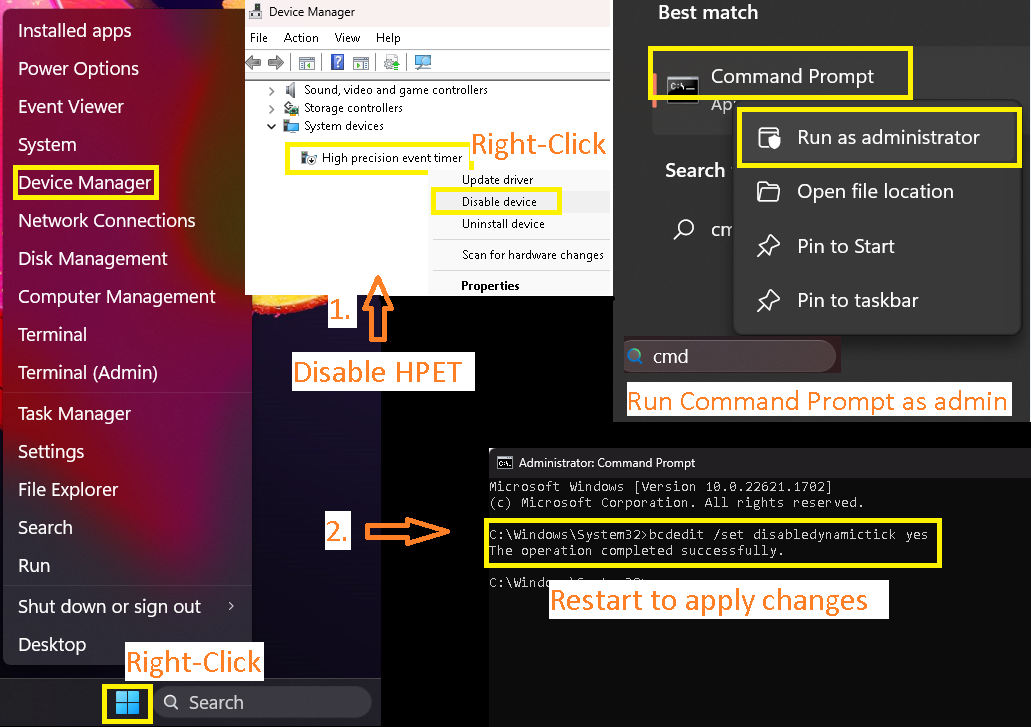

Adding in HPET here at the beginning due to large performance impact:
On my Win11 build I disable the HPET device in Device Manager, and run this command as an admin in Command Prompt:
More information on page 3:
viewtopic.php?f=10&t=11799&start=20

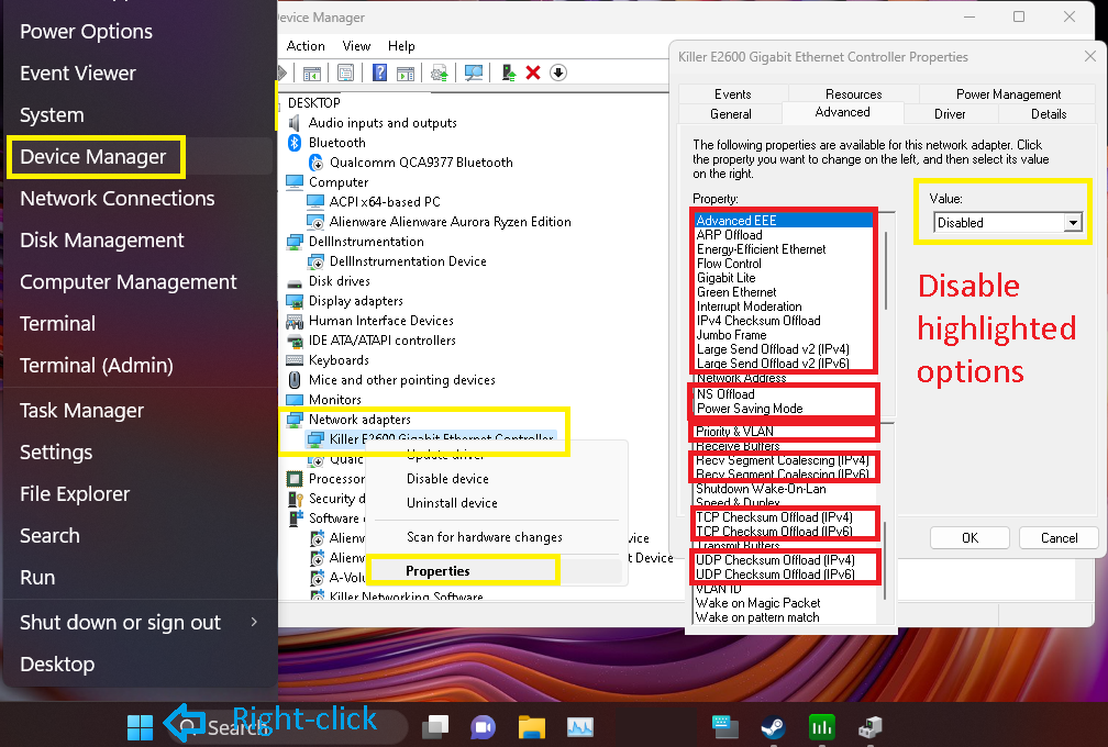

1. Install the latest motherboard, audio, network, and graphics drivers.

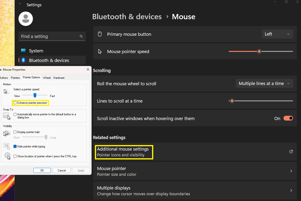

2. Turn off "Enhance Pointer Precision" in mouse settings.

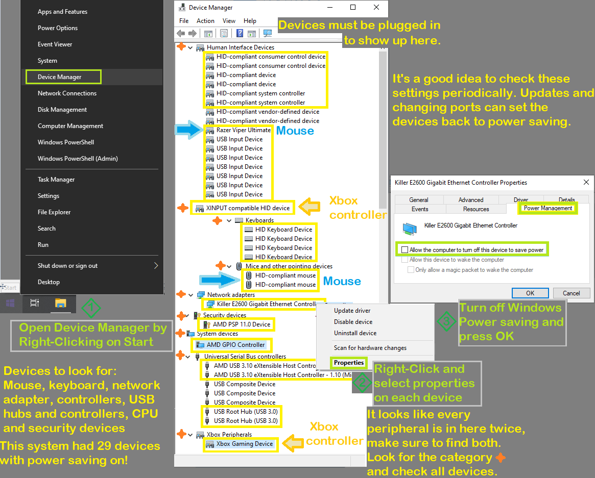

3. Disable power savings in Device Properties.

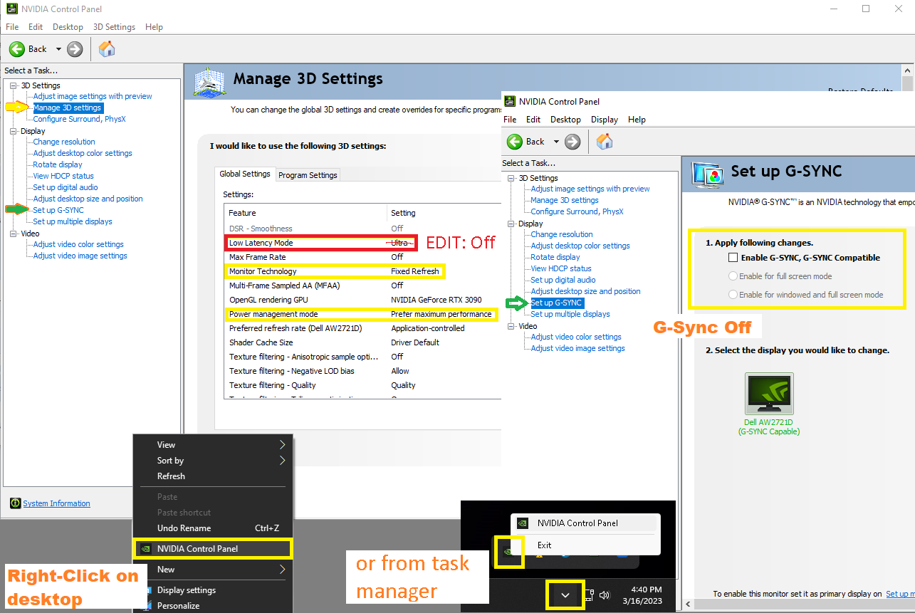

6. Enable maximum performance in Graphics settings. Disable all sync technology. Vsync/fast sync/Gsync/freesync. If GPU is getting maxed out to 100% usage, low latency mode and nvidia reflex can lower the input delay. Target 80-90% GPU usage if possible for consistent input delay.
power saving 2.png (128.31 KiB) Viewed 79837 times

4. Configure network settings.

6. Enable maximum performance in Graphics settings. Turn on nvidia reflex if the game offers it. Disable all sync technology. Vsync/fast sync/Gsync/freesync.
whitebox wrote: ↑
16 Mar 2023, 09:40
Can you explain why should we turn off Nvidia Low Latency Mode? (Currently I have it as 'Ultra').
Thank you!
witega wrote: ↑
21 Mar 2023, 19:46
@imprecise, I'm curious...why did you edit Low Latency Mode in NVCP to "Off"? Why is "Off" better than Ultra?
I found when having a second screen connected and Low Latency Mode enabled, 2D performance could drop by 40% and sometimes even 80% or more. 2D performance is still needed in 3D games, as 2D sprites are often used for in-game effects. Most games weren't designed for LLM and I think nvidia has moved on to Reflex after finding a better method to decrease latency. If LLM works for you by all means go ahead and use it, but the advertised benefits of LLM aren't worth the 40-80% decrease in performance I have experienced.
viewtopic.php?f=10&t=11711

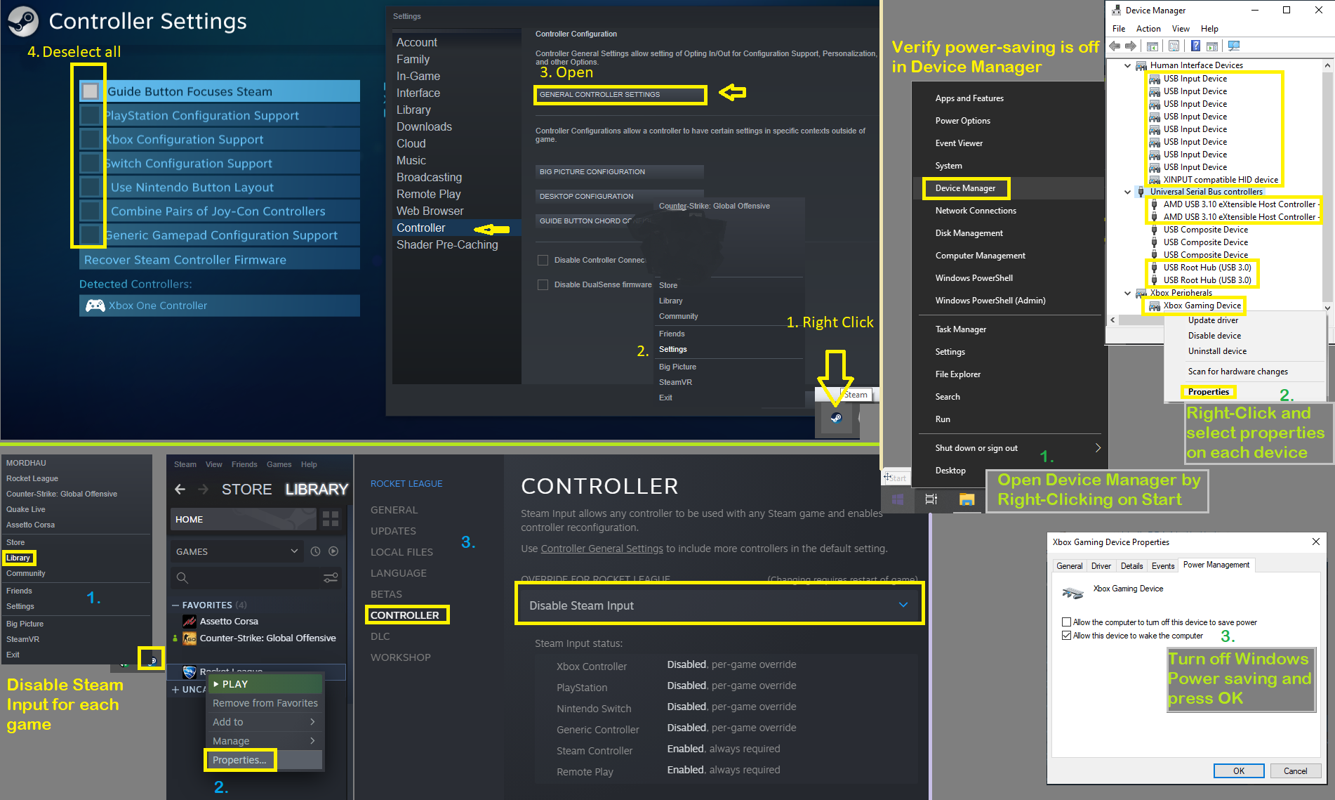

7. Disable Steam controller options.
This site helps when I need to troubleshoot the controller:
https://gamepad-tester.com

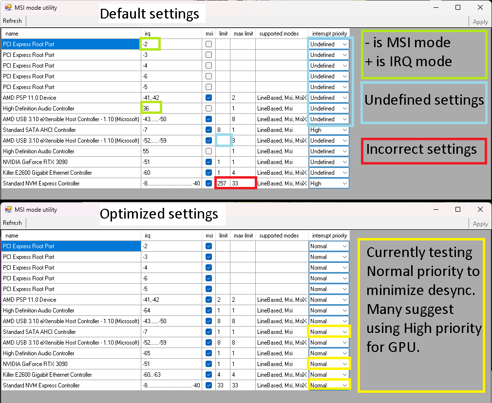

8. Configure device interrupt priorities.
Warning: Incorrect settings could break your system.

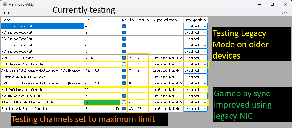

Newer devices are designed to use MSI mode for interrupt processing instead of legacy IRQ, but it appears Windows leaves these settings unoptimized. This leads to desync between inputs/outputs and lack of system responsiveness.
I used MSI Utility v3 to look up and define these registry entries. The default registry entries appear to have undefined limits, undefined priorities, and incorrect settings. I'm currently testing all on Normal and it may be preferred, since the video card isn't running higher temps at idle, and could also lead to less desync. Testing shows GPU mode on High priority leads to more FPS, which leads to increased visual clarity. This could come at a trade-off though, where a mouse-click slowed down a few ms for more frames to be shown first.
Be careful with these settings, they could potentially cause problems. Do not enable MSI mode on devices unless they support it. On this example, the devices that don't show support already had MSI mode turned on.
Current test settings:
The below image is a configuration I was testing previously. I think adding Normal flags simply adds a layer to be processed for no benefit, and switched to Undefined. I wanted to remove this layer even from the devices that were set to High by default, and am testing all on Undefined. If a device is assigned High by default, it may be best to leave it there. I was using limit 1 on all IRQs for testing, but received feedback that it has caused some devices to stop functioning until the driver is restored. I didn't find any advantage to using 1, I was using it to limit the number of IRQs in play at any given time.
Configuring these MSI/IRQ settings can improve performance devices that are misconfigured by default. Most of my devices are PCI-E 3-4, but the NIC is only PCI-E 1x, and setting it to legacy has improved in-game sync drastically. Some people report increasing or decreasing performance when changing these settings, so I recommend experimenting with 1 device at a time. GPU, Audio, NIC are common devices that can potentially benefit from toggling MSI/IRQ mode.
I'm sharing my testing process here in order to hopefully limit further confusion on the subject.
Configure manually: https://www.youtube.com/watch?v=E5RtosyeKQw
Configure using MSI Utility v3: https://forums.guru3d.com/threads/windo ... ol.378044/
For example, when I set network adapter to High, it causes extreme slow-downs in game when the higher priority network packets interrupt the input/output. In CSGO when full sprinting with armor, getting network aim punched causes the movement to stop completely and then start over like there was no momentum to begin with. The game is designed for that aim punch to slow down movement, not stop it completely with a delayed movement recovery.

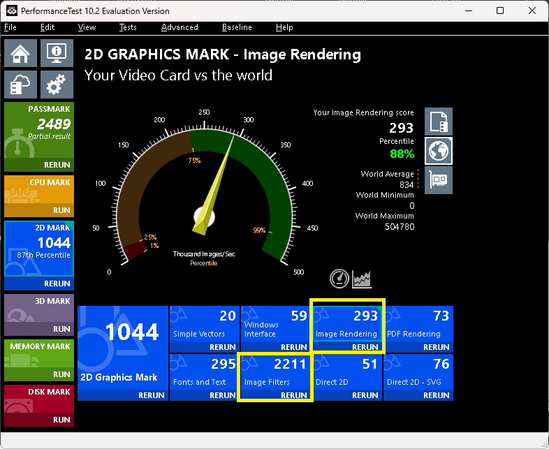

Tracking down performance issues can be difficult. I have found using PerformanceMark is a decent way to find where your computer may be underperforming.
You can download it here:
https://www.passmark.com/products/perfo ... wnload.php
On my current system, I'm constantly rerunning some of the 2D tests to make sure my computer isn't dropping into low-performance.

Hi,
I am following this guide to improve the responsiveness of my system.
Also, do I need to have Lasso opened to receive it's benefits? or Can I exit it after performing the settings you suggest in the guide?
Thank you!

whitebox wrote: ↑
16 Mar 2023, 09:40
Hi,
I found a bug causing my 2D performance to drop drastically when using low latency mode. Under ideal situations it would help a small amount, you're welcome to use it if you find it helpful.
