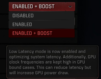

It looks like either the game developers or nvidia has taken this into consideration:
I was playing 80 ping with reflex earlier, then after seeing this post I switched to enabled+boost and the game feels more responsive with the same 80 ping.
Update: I checked in another game in UE4 engine and it says the same thing exactly, so it must be part of reflex enabled+boost design.
