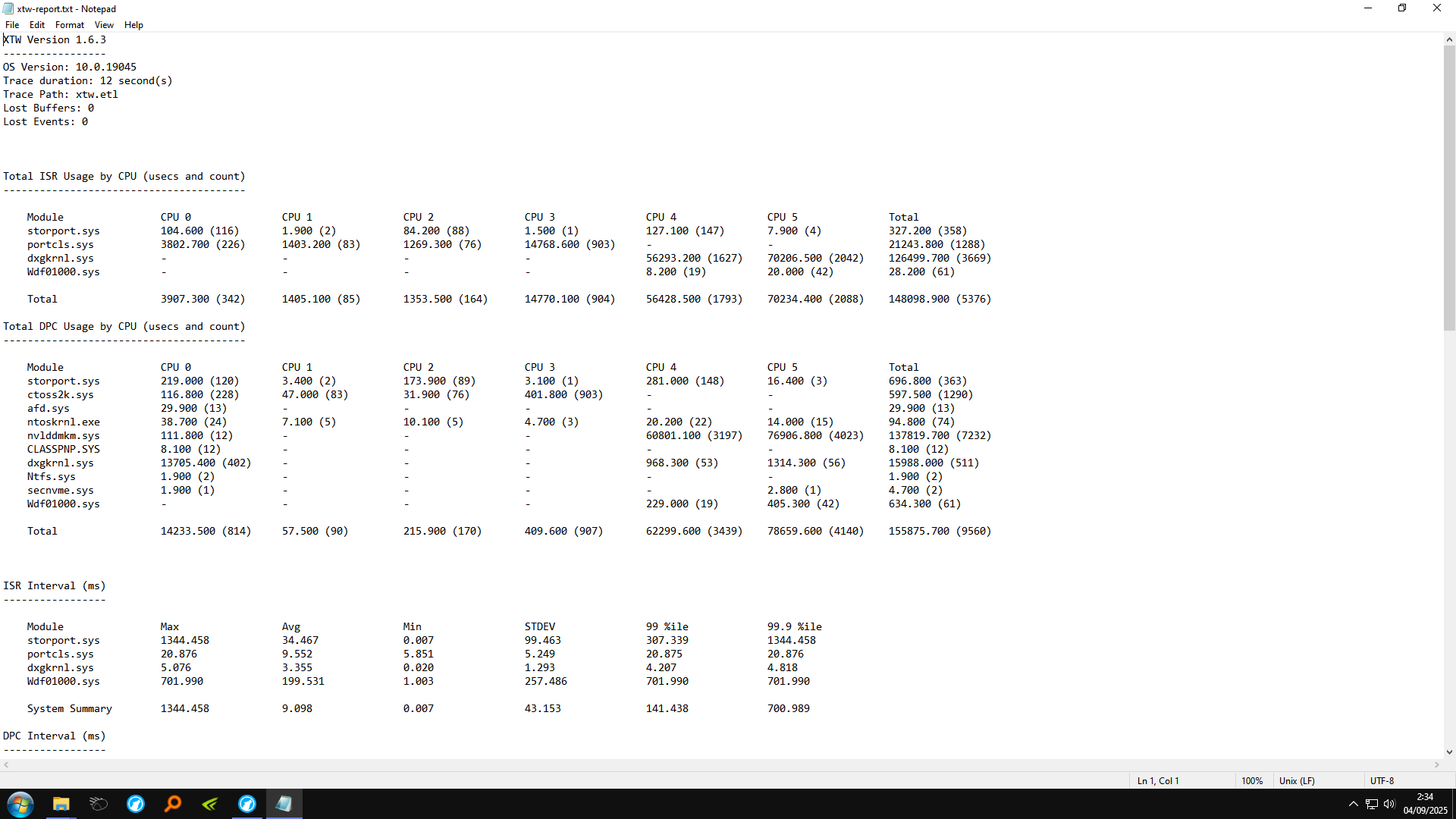

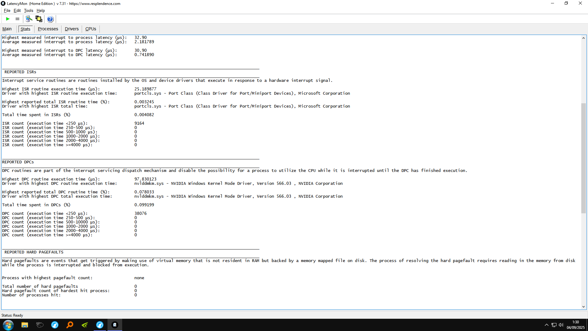

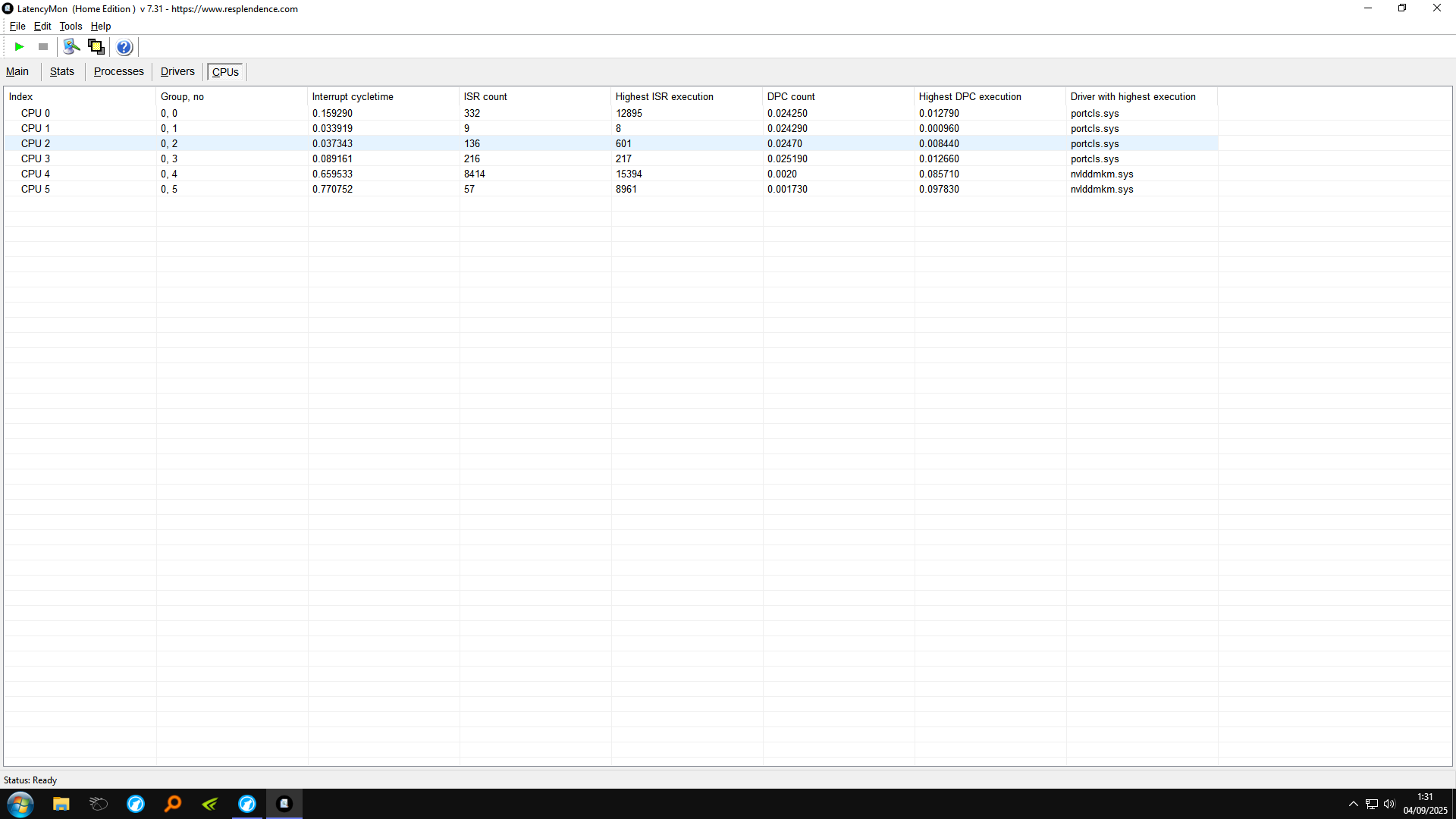

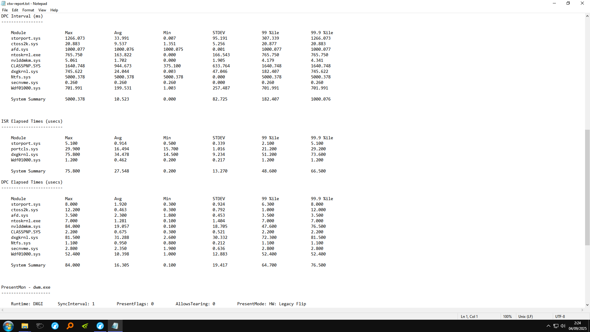

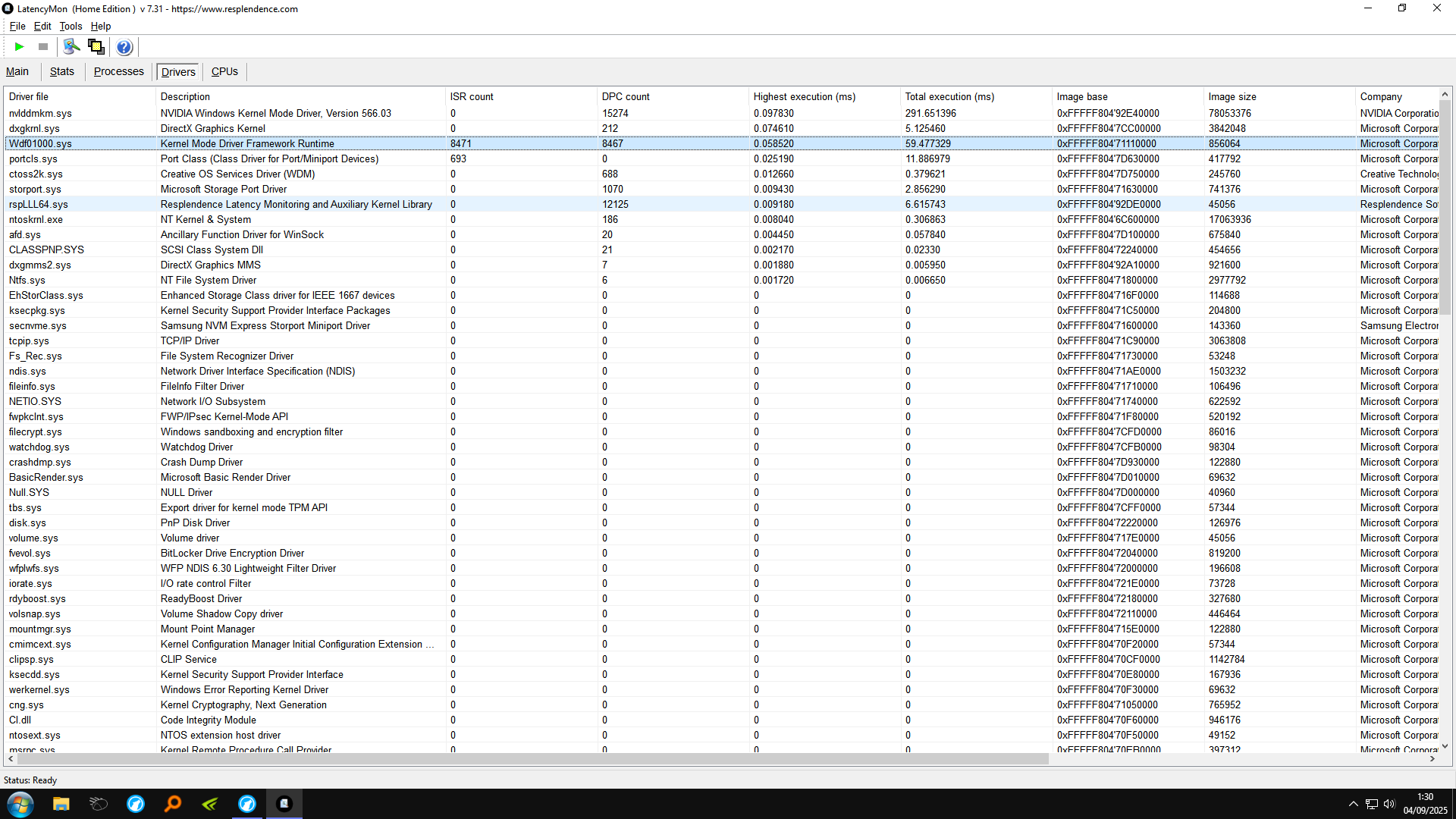

It feels better than 566.14, personally I didn't have frametime spikes or freezes because of the 566.14 driver, not once :D. I installed 566.14 and 566.03 with NVSlimmer. 1 min 1 second latency mon screenshots:

kyube
