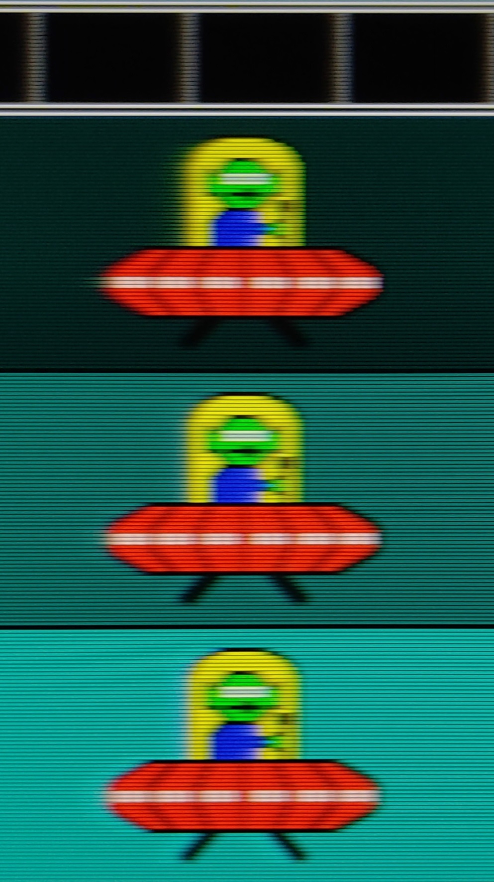

Overdrive Fast
@360 Hz
360 Hz input, 60-360 FPS, G-SYNC enabled, Overdrive Fast, ∼960 pps
We don't get to see panel's native performance (very likely same as PG259QN OD OFF) but we can see Fast successfully removes some of the ghosting with no overshoot and that holds true through full vrr range. This is well tuned overdrive. However ghosting is still visible down to 200 fps or even lower. There is still quite a bit of room left for improvement.

Overdrive Super Fast
@360 Hz
360 Hz input, 60-360 FPS, Overdrive Super Fast, ∼960 pps
Super Fast @360 Hz/fps looks ok I guess. Normally I wouldn't prefer this settings due to some presence of overshoot, but for 360 Hz I'd say it is necessary because we want to fit those response times within 360 Hz refresh window of 2,8 ms as much as possible. Unfortunately Super Fast is not fully there, some ghosting can still be spotted. Which means this fast IPS panel is not fast enough for such high refresh rates. If we were strict, this would of been a 144 Hz panel max.
Weirdly enough Nvidia/Alienware somehow managed to make this mode look like it's not fully variable. It's ok down to ~300 fps, bellow that overshoot starts intensifying, ~240-144 looks worst, from ~144 and down overdrive gain is lineary decreasing, nicely 60 Hz/fps is always overshoot and ghost free. Something in-between Fast and Super fast would be ideal, perhaps closer to Fast. Saying this for a monitor that has variable overdrive is not good. What is the point of having such feature when ideal setting is not met. Manufacturers tend to do this quite often. We want more options, preferably a 0-100 gain, yes even for variable overdrive.

Overdrive Extreme
Extreme is very similar to Super Fast and has just a little more overshoot so I didn't bother doing pursuits. This is a wasted setting imo. It would be better if Alienware left Fast as first, renamed Super Fast to Extreme and tuned something more balanced in between the two. Bellow are some existing images (from Bijan Jamshidi) so you can see what I mean.

PWM 100
ULMB with Pulse Width 100% (max) at middle screen, ∼960 pps
More images (from Bijan Jamshidi, ∼1920 pps):
https://i.ibb.co/7gQfGsq/AW2521-H-ULMB- ... 920pps.jpg
240 Hz ULMB is only... usable, disappointingly. Nvidia opted with what looks like Extreme overdrive with too much overshoot. This amount is easily noticeable in games, therefore can be distracting. This goes to prove how much they had to push the gain to remove most of the double image caused by not fast enough GtG. Now this is only 240 Hz, imagine how would 360 Hz look if they allowed. Also 360 Hz would have more crosstalk (no QFT at max Hz).
As we decrease the refresh rate ULMB experience becomes better. There are fewer ghost images and overshoot is less distracting but still visible in some scenarios. At lower refresh rates GtG becomes much smaller proportion of refresh window so we don't need as much overdrive, which is what Nvidia did here. Motionwise I found 144 Hz ULMB to be the sweetspot. It's noticeably better experience compared to 240 or 60 Hz.

PWM 55
ULMB with Pulse Width 55% (half) at middle screen, ∼960 pps
Shorter strobe durations keep improving MPRT and motion becomes sharper. Fun fact, the ∼55% 144 Hz ufo is very close to how sharp would a 1000 Hz non-strobed display look like. The future is exciting.
PWM 10
ULMB with Pulse Width 10% (min) at middle screen, ∼960 pps
Motion sharpness at 10% is just insane. What is also insane is how dim the screen becomes. I purposely made the pursuits look dark to demonstrate this. Notice 60 Hz is always dimmer than 144 or 240 Hz. But ofcourse noone plays at such low brightness, I hope.
Some might notice decreasing pulse width helps with overshoot so that's one way to tame it down.
