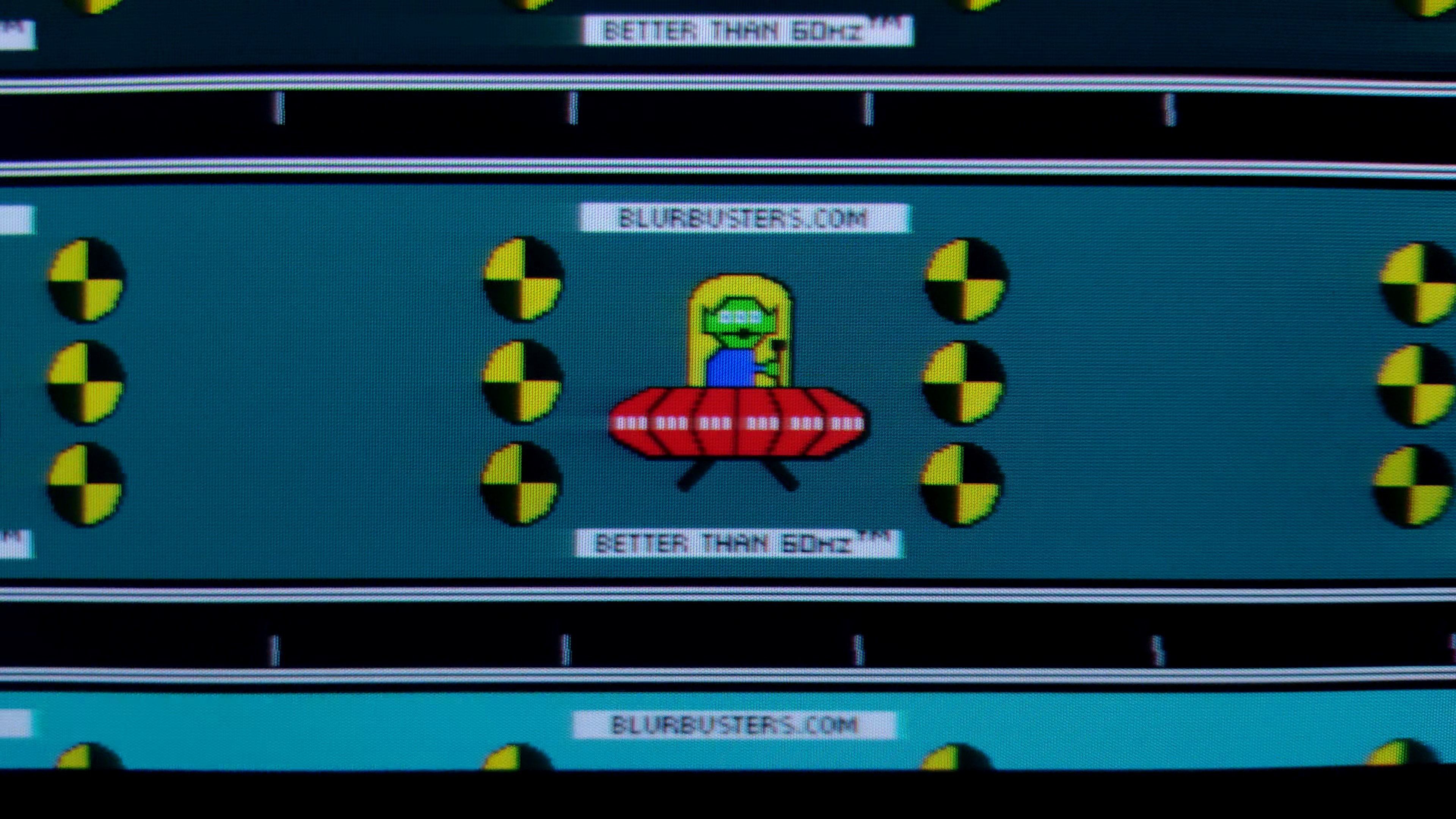

I took my CRT down from the attic and did some quick UFOs. I wanted to do close ups to better capture the motion sharpness of low persistence. Due to resolution and pixel structure reference image is not perfectly sharp like on LCDs, but it's good enough. CRT in question is Fujitsu Siemens 17P4, resolution 1200x900 @100Hz.
Try the test on your monitor and see how it compares:
https://www.testufo.com/ghosting#backgr ... &pursuit=1
3000 px/sec
3000 pps vlcsnap-2023-02-08-18h02m23s513.jpg (1.57 MiB) Viewed 27163 times

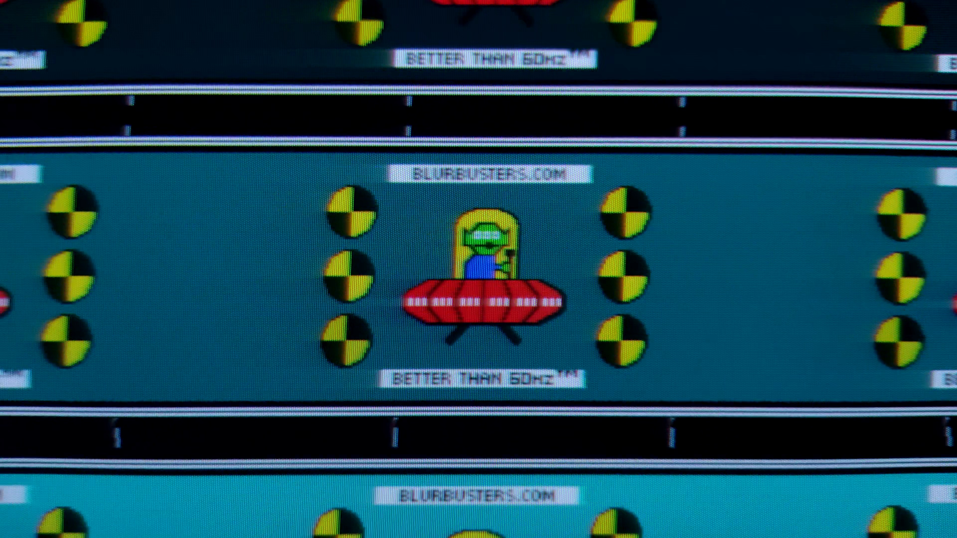

2000 px/sec
2000 pps vlcsnap-2023-02-08-18h29m45s351.jpg (1.79 MiB) Viewed 27163 times

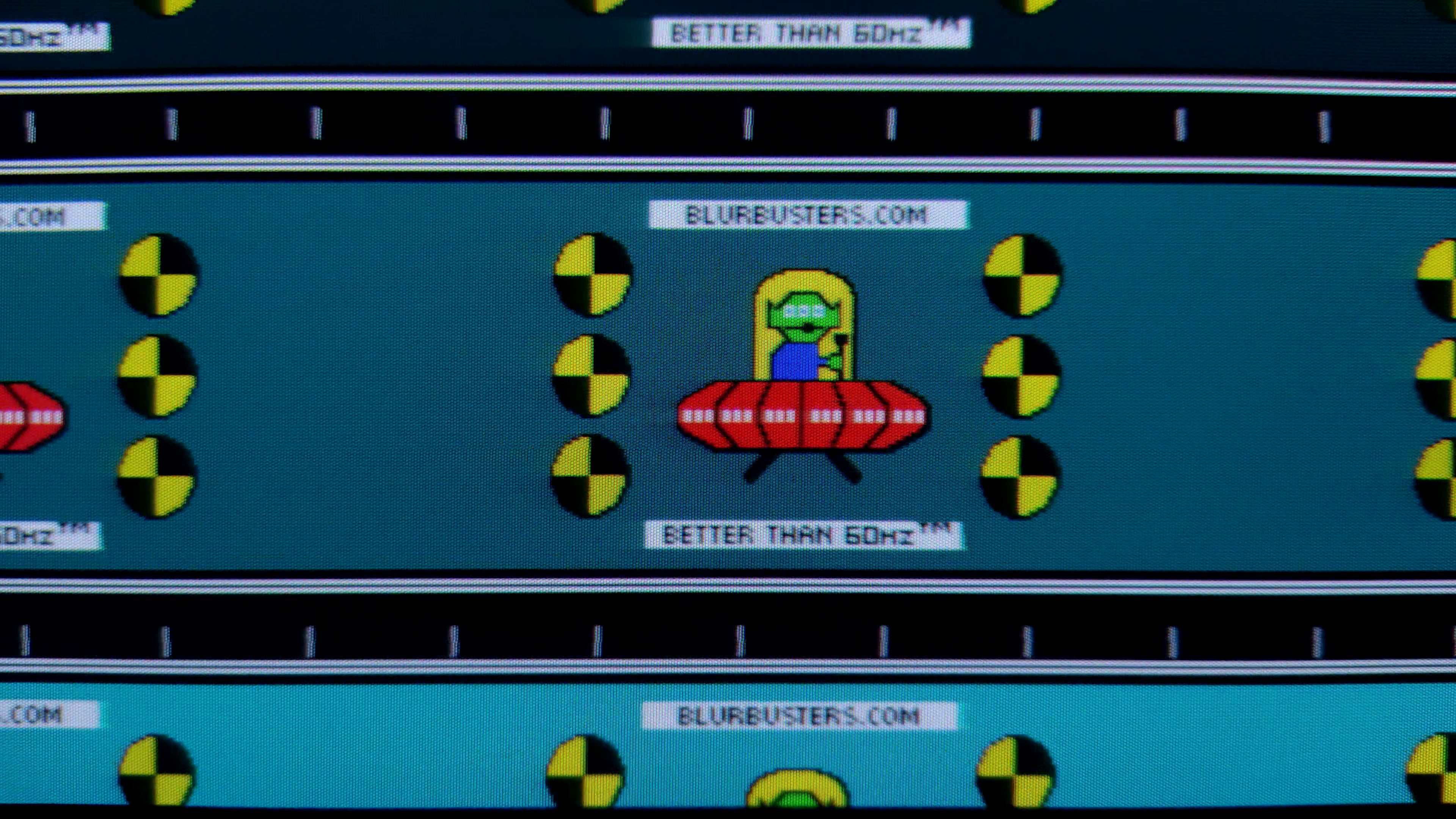

1000 px/sec
1000 pps vlcsnap-2023-02-08-20h01m15s397.jpg (2.27 MiB) Viewed 27163 times
